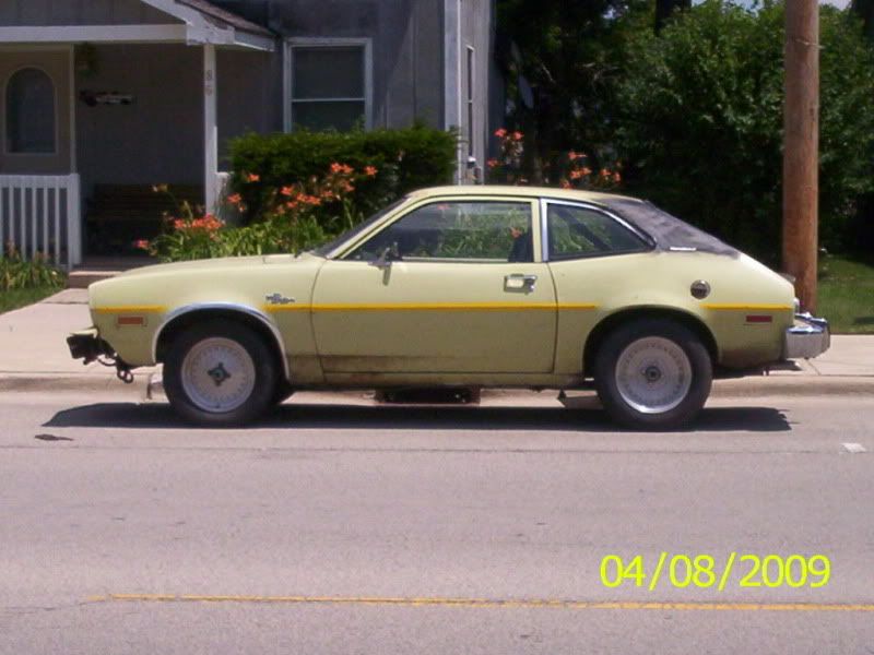

This is about replacing the front springs.  The car originally had A/C and all of that is gone but still had the extra strong springs which jacked the front end up almost solid.  We put in new [to me] front springs along with a ball joint and shocks and now it is lowered just a bit and rides really well.
Here it is before.....
and here it is after.  Not too much different but later plans are to rememdy that.  it rides really well and i just need the front end aligned.  the Camber is off.

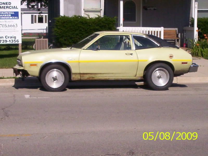

As promised here is the last picture after the paint.  Not the best but way better than black.  also this is just temporary [can you say that knowing full well it might be another year or two?]
anyway here is the picture.
I also painted the back inside body work black.
here is the link to the rest of the pictures.
http://s93.photobucket.com/albums/l66/hellfirejim/body%20work/

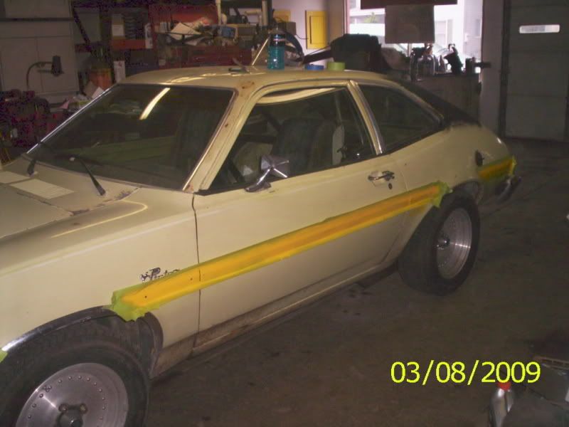

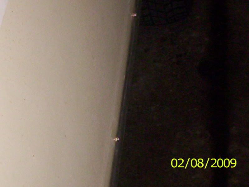

I was not even going to start body work until the mechanical part of this deal was done.  However the oprtunity to use the shop for three days and the need to remove all the chrome trim studs and mounting wires because of the hazard they would be at the car show.
Here is what the studes look like:
I used a cutting wheel to grind them all down and remove all the clips.  Here is a shot of the paint prep.
I just could have primered every spot but I thought that would look stupid and pokadot so I figured I might as well have some fun so i made the stripe.  The black is the primer.  I also primered around the windows.
When i pulled the tape off i realized just what an impact that stripe had on the car.  Since I don't need the attention I thought I would go get some matching yellow paint and just paint over.  naturally nobody had anything close so i just got some yellow as that would be a lot better than the black.  Here is a shot of it while still taped.
By the way I am really starting to like the darkern window frame at the bottom and considering blacking out the door frame.  might just try it while everything doesn't count.....
More to come tomorrow and a lkink to all the pictures.  Yes it has been fun and great.  Damn i wish i had a garage as it sure would have been a lot easier..  Oh well such is life........

Since we are waiting on parts {sound familar?} and my buddy who owns the shop up the street is goen for all three days AND I have the key to the shop I am going to do some body work.  i am taking off those clips and springs for the trim.  They are all have rivets so I am going to grind the heads off the rviets to pull off the cips.  they are really ugly and dangerous.  Since i am entering my first car show on the 26th I need to get this done.
I am going to be so spoiled, 3 days in a SHOP.  that's right inside!!!!

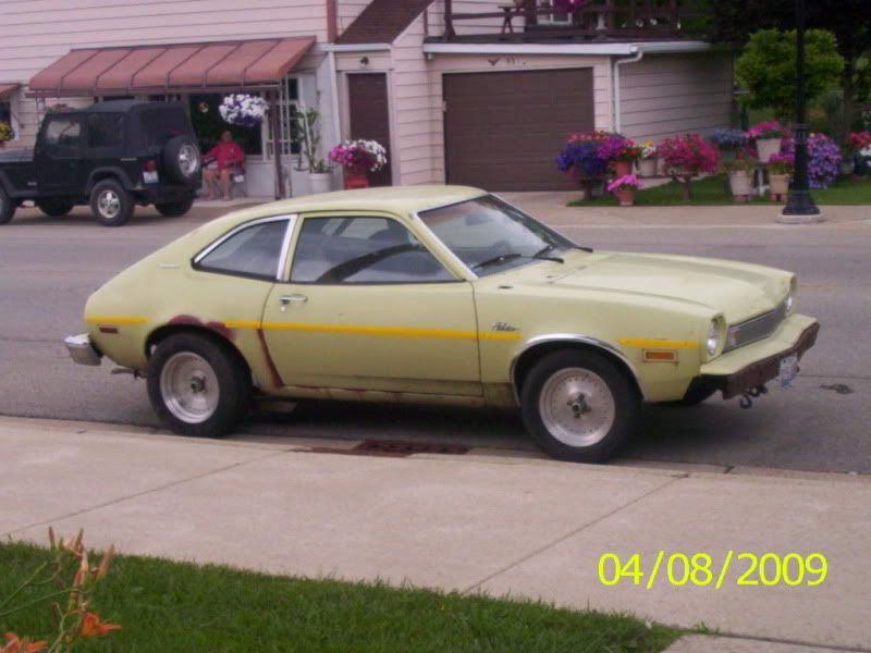

To follow up on what I was posting, I went and picked up the Pinto and got a pleasent surprise.  The bill was half of the estimate.  i had to ask and he said that after the front part the rest just sort of fell into place.  I used 2 1/2 inch pipe but not mandral bent so at the tightest it is probably a 2inch which is perfect for my needs.  Maybe one day it will be mandral.
They did a very good job, all nice and tucked up out of sight.  As for the exhaust tone, it is really nice and mellow at cruising speeds but when you step on it, it really starts to bark.  OH Yeah!!!!
After all the work and time on this car [about 9 pages worth] it is finally at a stage where I can drive it anytime I want.   :fastcar:
So was all the time and effort worth it????   After that first drive the answer is a resounding yes.... :drunk:
