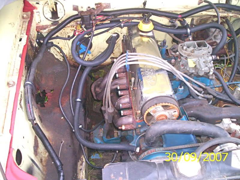

Just a short update.  The battery I was supposed to get got lifted by some kid so I use the battery Pak type jump starter to test the circuits.  Everything works ok except the starter which drags sometimes and cranks fine sometimes so it is coming out.  What I would like to know is who would design a car where you had to disassemble the front half of the car just to get the starter out?
Did I mention stupid?????
Another update :smile:
I finished the dash wiring and got it all tucked up out of site which also includes the tach and wiring.
I finished the vacuum lines and the breather hose from my new breather upto a foam filter inside the air cleaner.  So I am down to Spark plugs and battery.  I just have to wait until my budget catches up. :surprised:
I made a pact with myself when I started this that I would do any repairs or modifications the "right" way so i would only do it once.  Takes more time and money but worth it. Getting closer.
http://s93.photobucket.com/albums/l66/hellfirejim/ready%202%20go/
Just a small update.  I finished the heater hoses and the engine compartment is starting to look a lot better or at least one side of it.
I have some vacum lines questions but I will post in the question section.
Gettiing closer all the time.  Should fire up in the next couple of weeks.... I hope
It doesn't show up real well but there is specific colors for certain circuits....  I think the beauty in this is that I can carry a spare switch, relay and fuses and have it covered for less than $15.    A lot  of os slow work but in the end very satisfying.

Today is a good day.  This weekend I finished the engine compartment part of the new battery wiring, cleaned and treated the rust, made another bracket [this one actually works], primered the inner fender panel and remounted the fender.  ;D
I had planned to buy a new battery for it but the other car had to get a new water pump and alternator.    : (
So my next step is to un-engineer all the "neat" things that was done in the engine compartment.  Such as other wiring, vacum hoses, heater hoses and all the little stuff.  Oh yeah I almost forgot, since the wiring is done I will finish off the header and get it installed permentantly.
Here are some pictures of the wiring job.   Hope this isn't too boring just being able to share with other pinto people is really cool.

And this is how I spemt my holiday weekend. My battery  is behind the passenger seat and I wanted to run the power and ground cables forward but without making new holes in the body.  From the pictures you can see I found some factory holes behind the front kick panel.  I had to take off the front fender to do this but I got it done.  All the cabeling is now new.
Next is continue to run it to the back, locate it and do the rear battery mounting deal.
