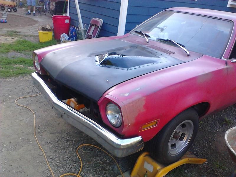

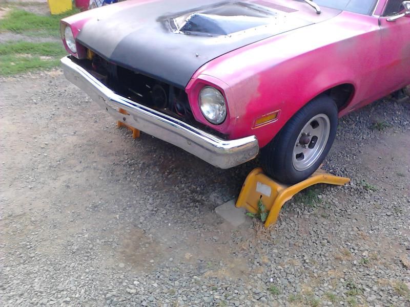

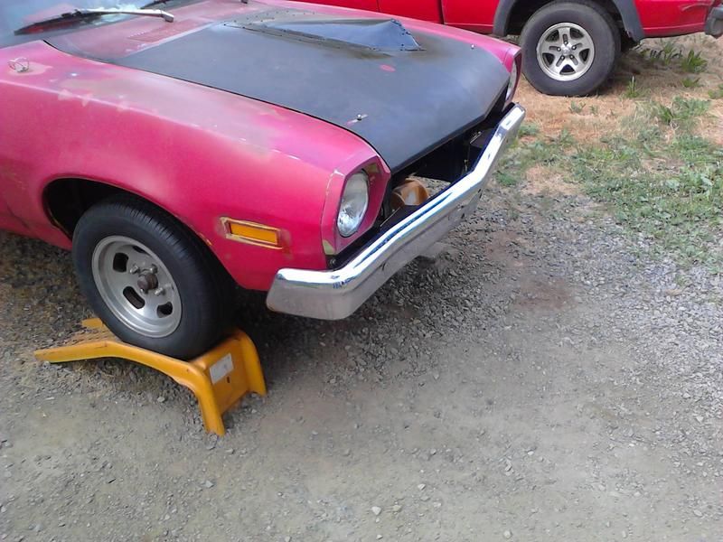

That looks a whole lot better with the bumpers retracted.  Should you ever have access to a set of 71-73 bumpers (and desire them) here is a pictorial of a guy who swapped the early bumpers onto a later car http://www.joe-escobar.com/pinto.html. Scroll about a third of the way down.  The hood bulge has a very stealth fighter like look. Maybe it will help evade radar. LOL
You may be struggling with the heat (and working on gravel), but you are making very good progress.  That said, the date of your first post indicates you started over 6 months ago. So, your build I think is a very good indicator of the time it takes to do the turbo build. It sure doesn't happen in a weekend.  We often get guys here who like the concept, but you can generally tell they are rather clueless as to what it really requires. Your posts show the diligence that is necessary. Carry on!

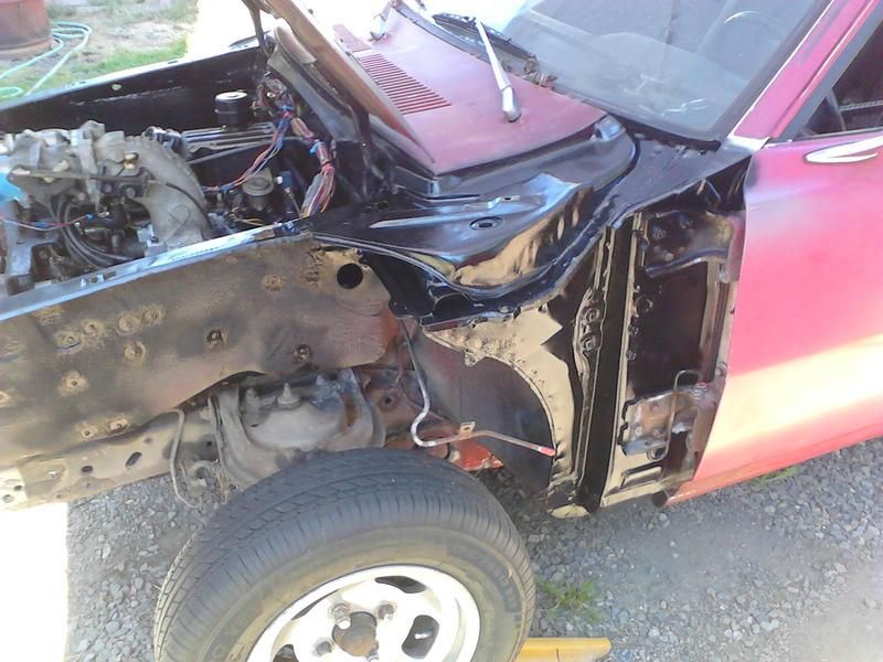

Another unbelievably hot day here! I popped the pimple on my hood. I'm not messing with the hood any more. It's scrap with hinges on it. I'll deal with it properly after I get more important things done. But my ocd isn't twitching... for now.
1976 half hatch 2.3 turbo w/t5.

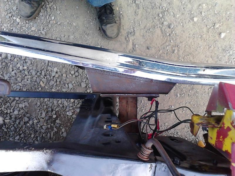

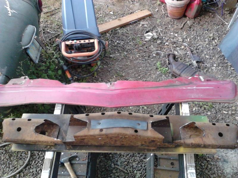

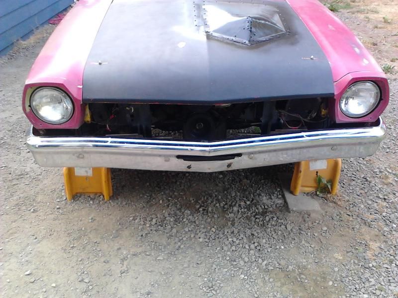

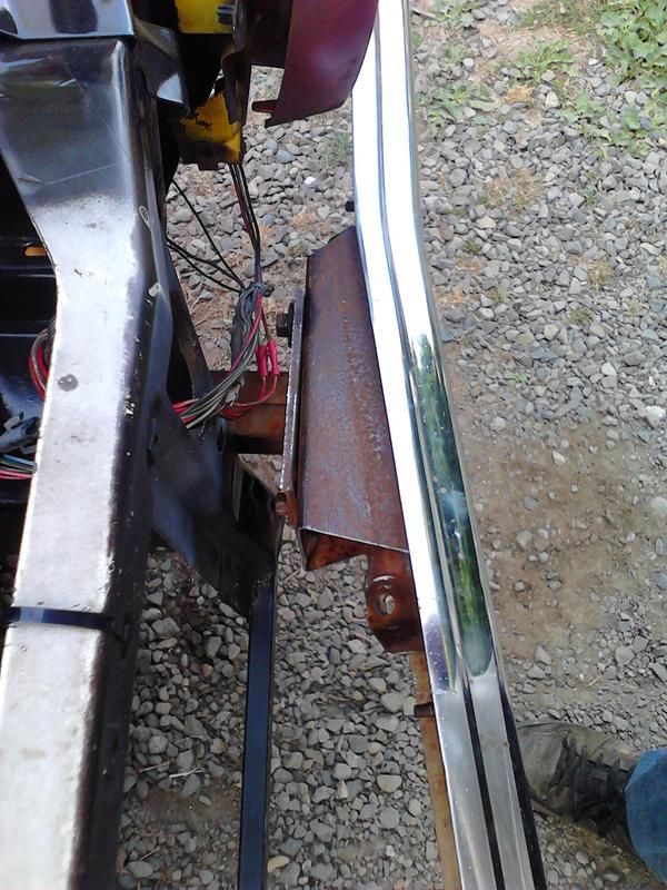

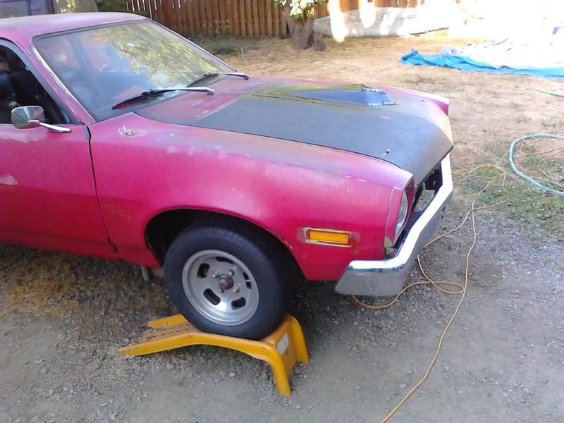

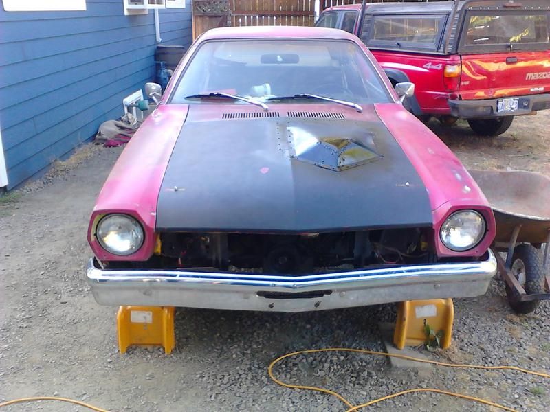

I took it pretty easy today. Spent a couple hours playing with the front bumper... then ate some bbq!
I drilled and sleeved the frame for 1/2" bolts and removed some "excess". I didn't have the right 1/2" bolt to fasten it in yet, so it's just hanging all wonky in the pics. I split the whole inner brace so that all I have is two pieces with the holes for the mounts and the bumper itself. I like that I'll be able to pull the bumper and leave the braces to work on say... an intercooler. And to put it back on, I don't have to play the alignment game!
I think I removed as much as I kept!

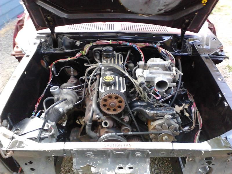

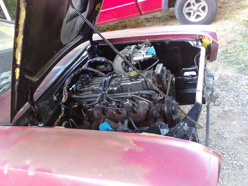

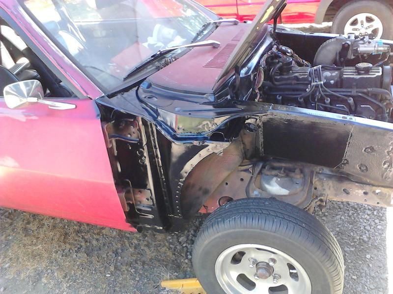

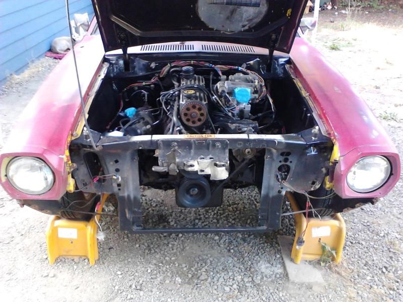

76hotrodpinto
Here's a few more pics of some progress made in the fiery heat.
65ShelbyClone
Keeping the TFI module as cool as possible is never a bad thing, especially when new genuine Motorcraft replacements are both expensive and getting difficult to find. They have to be mounted on a heat sink with heatsink grease if they are controlling the coil because of the current and heat involved.
In my case(using a MegaSquirt standalone ECU), all the TFI does is act as an interface for sending an RPM signal to the ECU so I left it on the distributor. If that module pops, I have a spare. If the spare fails, I have a Duraspark distributor from my parts car that will also work with the MegaSquirt, albeit with some hardware changes.
'72 Runabout - 2.3T, T5, MegaSquirt-II, 8", 5-lugs, big brakes.
'68 Mustang - Built roller 302, Toploader, 9", etc.
No, sorry. I miss understood.  The heat sink TFI isn't a bad idea to consider though. The relay box is a separate item.  Mine is mounted about where your VAM is on the passenger inner fender. That is roughly its natural position in a T/C. Since I don't have a FMIC I just put the VAM inside the passenger fender well. I guess you can put the relay box where you like, but remember if you are having issues access does have its virtue.
If you go to page 4, reply #92 you can see the layout I use. The TFI has yet to be moved/heat sinked and the hideous EGR control is still in place but the rest is the same. (Innercooler removed for visibility).

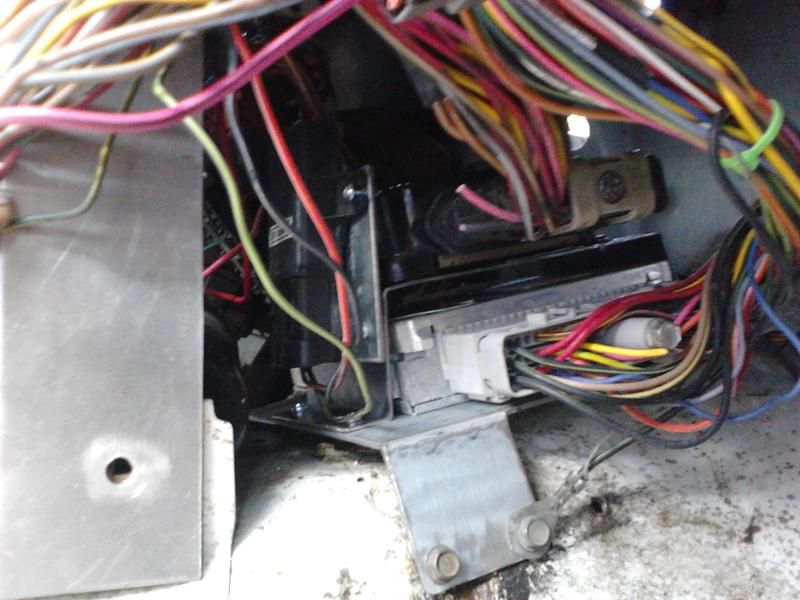

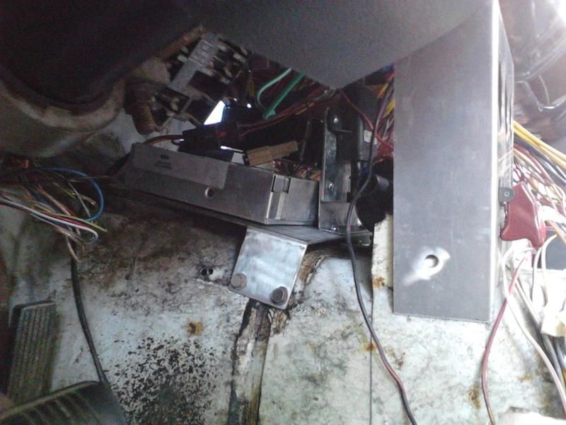

I have another question... I've been playing the hermit crab game trying to cram all this clutter under the dash, as a result, my previous coil location has been occupied by other gizzardry. There is still enough space to get in there, if I fab a new bracket, but it puts it pretty close to the computers and other magic black boxes. Is the coils field going to mess with the brains of this operation? I figure I can get about 2" from any of it, which is about 4" from the ecu itself. Any thoughts?
Personally, I would try to put it somewhere else like in the engine bay. EEC-IV computers are not particularly sensitive to RFI, but that's assuming all the original noise suppression measures are in place. The TFI harness is wrapped with foil and has a bare grounded wire down the length of it for noise shielding.
QuoteAlso... can I pull an integrated control unit from any comparable 2.3 efi motor? Or does it need to be specifically my setup?
I don't know the answer, but I would start by looking up a replacement for the 'Bird and see if any parts sites list "compatible models."

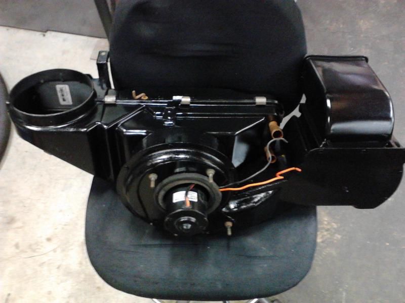

CRIPES IT"S HOT!!! But I tried to push on. Here's a few pics of miscellaneous stuffs.
Not to get too far off the point..., but it seems the cruise control has six, maybe 8 cut-off options. I mention this in case anyone is considering it.
1. The ignition switch.
2. The CC on/off switch.
3. The CC control switch when in "coast."
4. The clutch switch.
5. The brake light switch.
6. The brake pedal also has a vacuum break hose on the CC vacuum canister.
[7]. Pushing the clutch pedal is also a mechanical disengagement of the CC controlled drive system.
[8] . Moving the transmission to Neutral.
Note that 7 & 8 do not actually disengage the CC. There was a day I was on vacation outside Seligman, Arizona.  Rolling along at 65 MPH with the CC on our Audi 5000 Turbo (Automatic) lost its transmission and the tach instantly redlined because the car was slowing but the CC was giving more throttle input to compensate. I went 10 miles in 1st gear (at least I had that) to Saligman which is between 'somewhere and somewhere else.'  After waiting nearly an hour for the truck that was just across the street the Audi (with us inside) were loaded on the flatbed tow truck and driven 70 miles to Flagstaff. That is an odd feeling to be in your car, 5 feet in the air going 60 MPH and having absolutely no control.  We joked that it could become like the stage coach where the driver is shot, the horses take off and the passengers need to climb out and take control. I mean, the driver was in his 60's and people do have sudden heart attacks.
Anyway, there is some Turbo Pinto info in this sidetrack. The mid 80's Audi Turbos have a nifty, electric coolant circulation pump. It basically takes a standard heater hose and circulates coolant through the turbo when the car is shut off. A relay and a 555 timer could provide the timed power source.  Lastly, those Audi's (especially the Turbos) have the most powerful fan motor I have ever seen. It is the size of a small starter motor and with the fan pulls a LOT of air. If you can configure a bracket and work around the length I'd recommend it for those forgoing the mechanical fan.

Played with some wires today. And made a little rack to hold the "computers".
