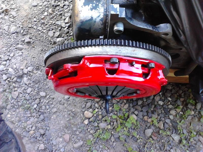

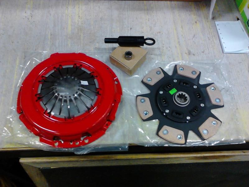

Look what santa brought me! Just what I've always wanted. A kuup stage 3 clutch kit!
And here it is on the flywheel. Shiny!

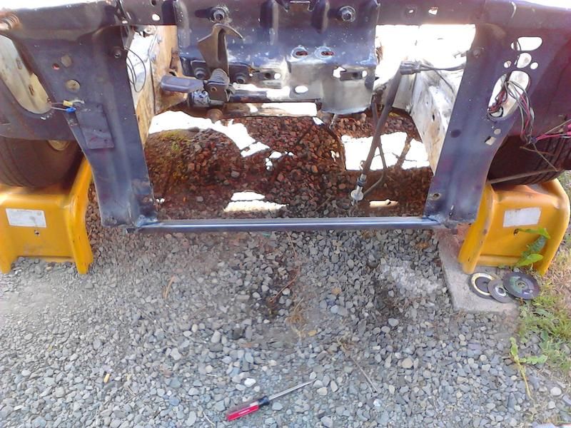

I attacked the core support today. It was pretty wrinkled up at the bottom. I chopped off the bottom where the majority of the damage was and replaced it with some square tube.
I should get my new clutch tomorrow too.

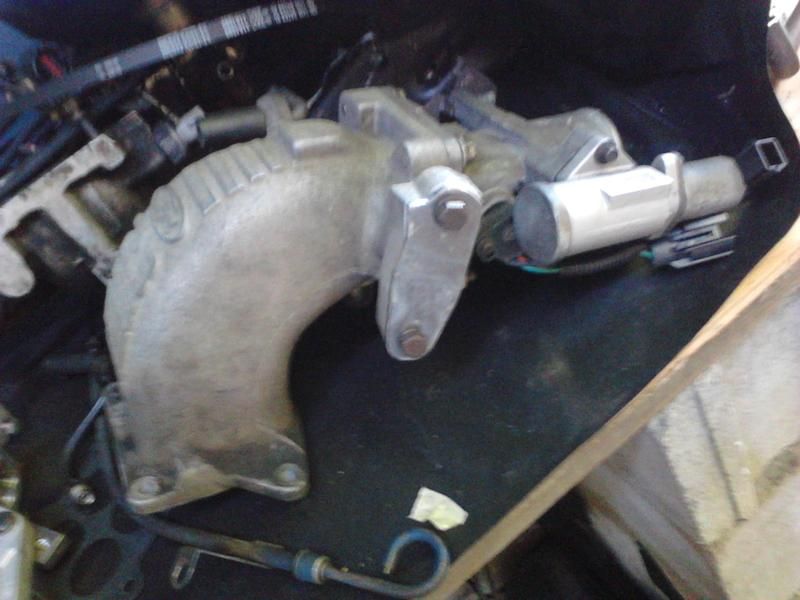

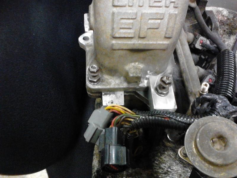

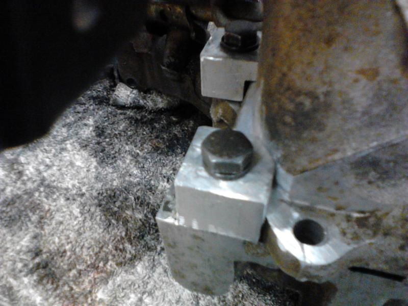

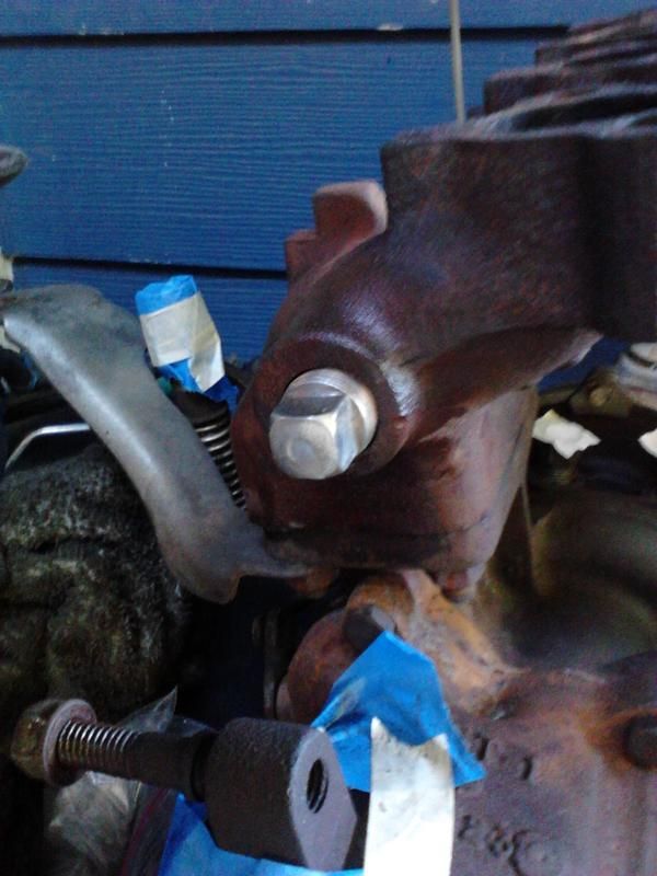

Here's a couple pics of my upper intake mounting thingy's.

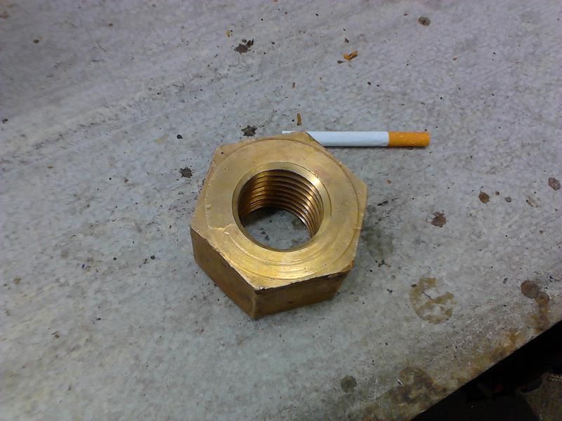

And here's a big brass nut... one of a pair I have!

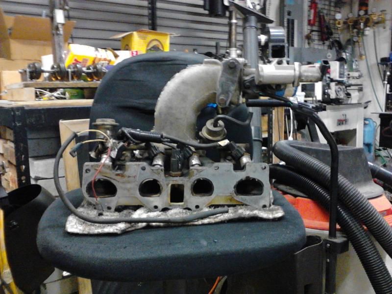

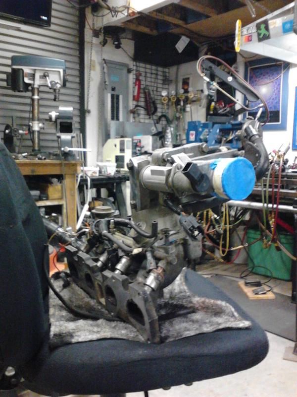

Still too hot to work outside on the pinto, but I got some indoor stuff done.
Got the egr tube to come out gracefully, and plugged it.
And I made a delete plate for the intake.
Then I got the intake rotated 90 degrees.
I plan to port match the upper and lower, but I ran out of gumption for the day.

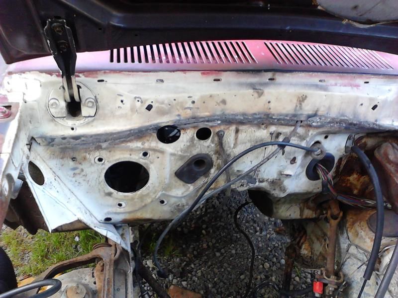

I didn't get as much done today as I had hoped. The heat today was whoopin' my... uhm ... fanny? But I did make some progress.
The shifter hole is done.
And the firewall seam is welded and rough ground, still needs to be flap wheeled a little.

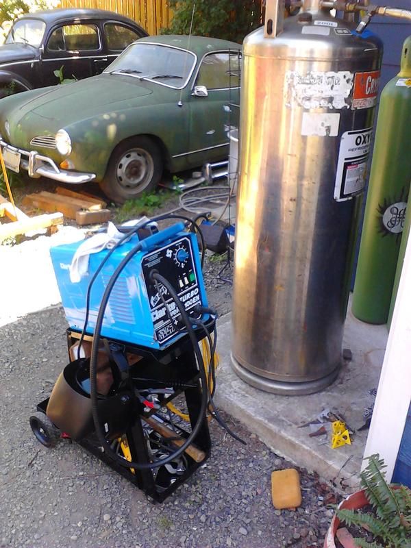

My little clark/tweco hybrid, and the german section.
