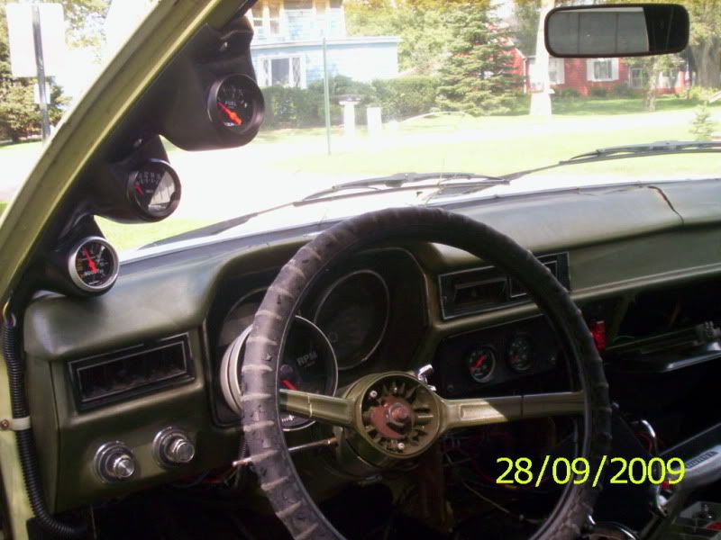

First is the gas gauge.  It is installed in my three pod and looks good but doesn't work, sorta.  I grounded the gas tank and the needle came off pegged up to empty.  i know that is not right as i filled the tank so obviously the sender is bad and most likely the float is full and on the bottom.  Not going to do anything now, will wait for spring when we pull the tank for all new gaskets, a fuel return line and a new sender.

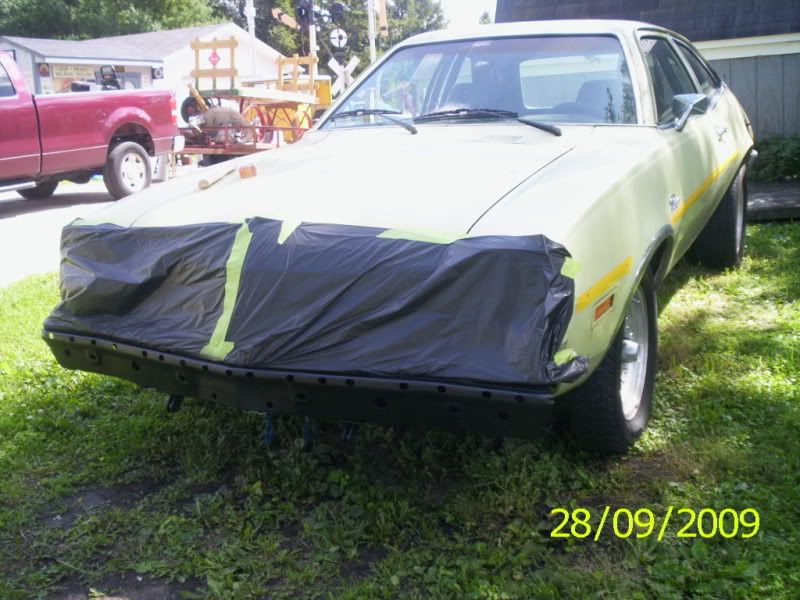

Next is the front bumper area.  Since the front bumper is off and never to return, the front beam was just sitting out there all rusty and looking like hell.  so i wire brushed it, coated with rust converter and painted it flat black to improve the looks.  You decide.

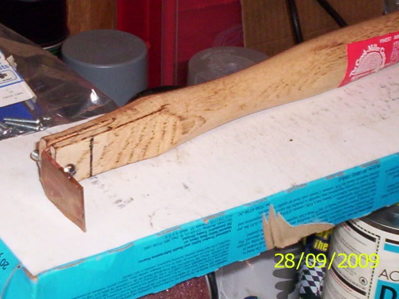

last item is a tool i needed but couldn't find.  I have a lot of chrome trim holes to weld shut.  the easiest way to do this is with a mig and a copper plate behind the hole to fill it in.  The weld does not stick to the copper and supports the weld while it is filling in the hole.  Pretty cool.  anyway i just decided to build it.  I got a copper cap [hasto be substantial] and a hammer handle for $9.  I cut out a slice of the cap, stuck it in the handle ,and drilled a hole for a bolt and there it is.
