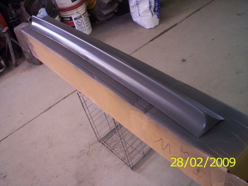

Hi all I am back with just a little bit more done on the Pinto.  This is the duckbill spoiler that Mike makes.  NOTE: Very clean and well made.  I just had to scuff it before priming it.
This is the scuff and clean shot.
And this is the primer shot.  I used a high fill flexable primer and works out sweet.
on to the next post.  I hate more than two pictures in a post.

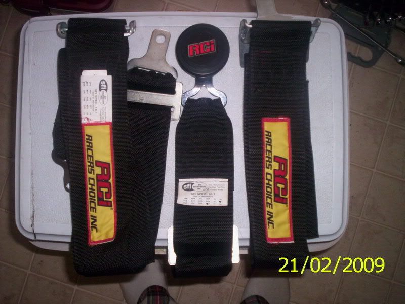

This post is about seat belts.  My passenger seat belt is gone and the drivers 3 point should be.  Besides it is that god awful green.....  So I went out and purchased 2 sets of 5 point cam lock seat belts.  All it will require is to drill some holes and weld two tabs to the roll bar.  Incidentely the roll bar will be padded.  The cam locks are so new that they are still a little stiff.  I go both for 1/3 the price since they were out dated.  I don't ever plan to go to the track so it doesn't matter.

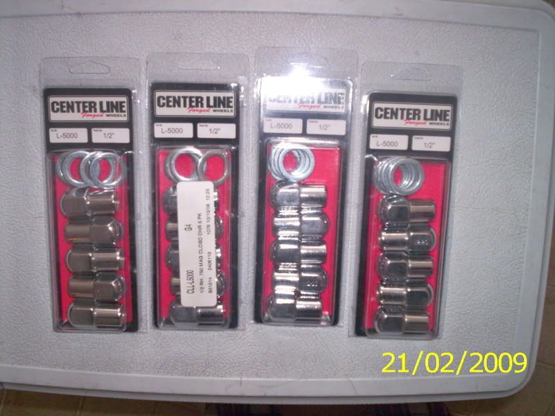

Finally it is just a picture of my new lug nuts.

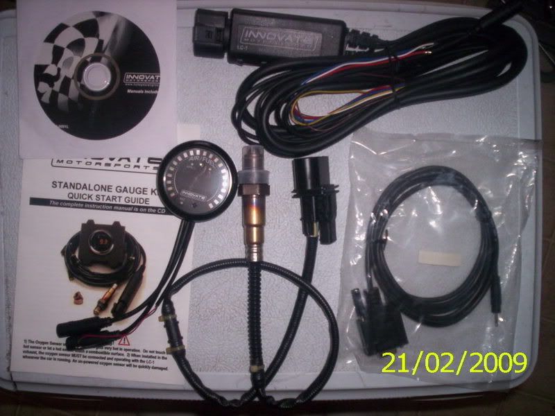

Finally I am able toget this next piece.  It is the final gauge for the three pod.  It is the XD-16 Wide Band Air/fuel gauge.  It gives me a digital reading in the center of the gauge and a color sweep around the outside edge of the gauge to catch your eye.  If you have read all this you know i have a carb and this will help me tune it.  When the turbo goes on it will be an absolute requirement so i don't burn it up.

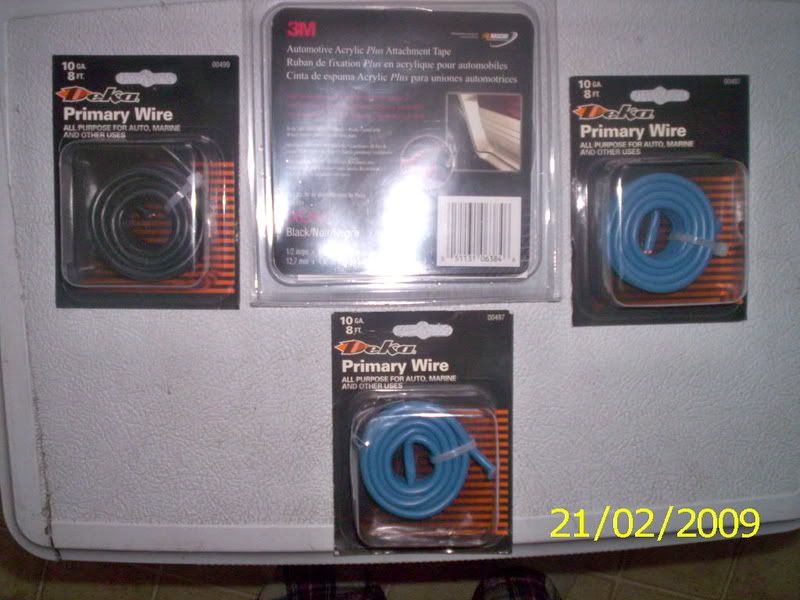

This next picture might seem a bit strange but take a look at the gauge of wire.  I will be re-wiring my electric fuel pump with the proper size wire.  Too small a wire can make a difference.  I will also be wiring in an enertia switch so if i get hit it will shut off the electric fuel pump.  It goes in the 12v signal circuit for the fuel pump relay.
The package in the center is the body kit tape to mount the spoiler for now.  Later when I am doing the body work i will be pulling the spoiler and mounting it permanently.

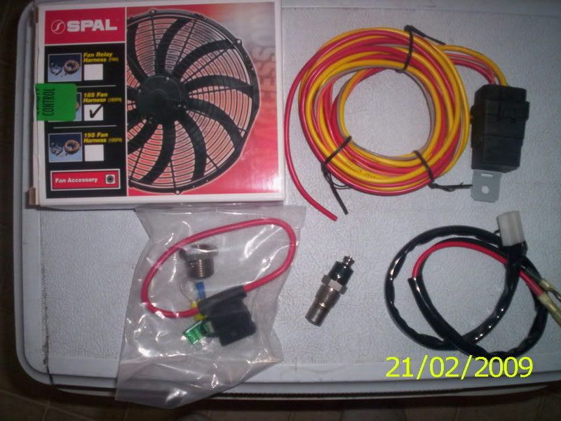

The reason for the posting is I will be showing the parts that I have collected.  The first thing is the SPAL thermostate control of my electric fan.  VEry nice piece and I highly reccomend it.

Santa brought some new parts.  First is a thermostatic control for the electric fan and a new set of Lug nuts.

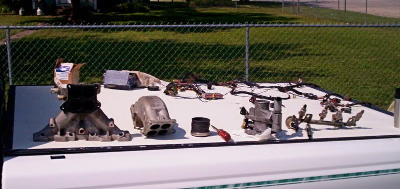

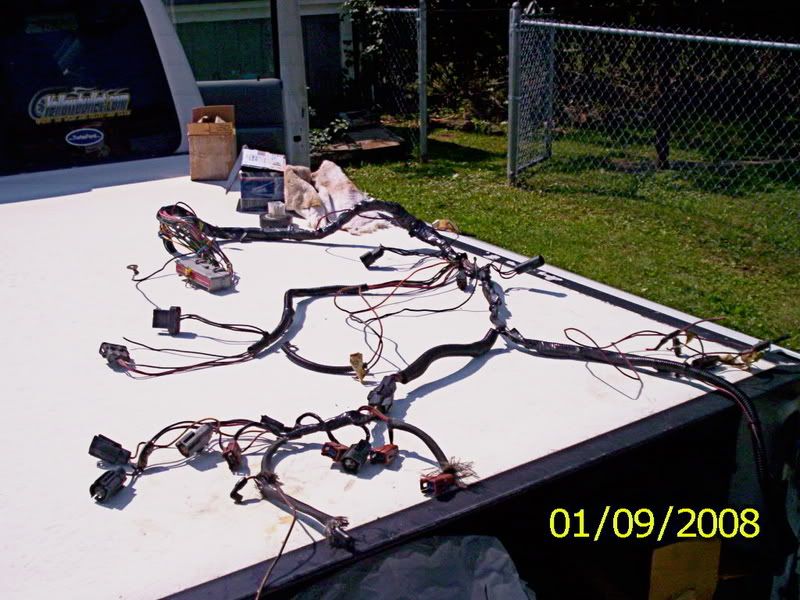

This post is about the immediate future and next year.  First next year.  These pictures show the parts that I will be using on the Pinto.  EFI, yes EFI.  I plan on changing it over as i already have about 85% of the parts already.  I am going to try and record all the steps required to do this conversion.  So here are the pictures....
and the wiring harness.

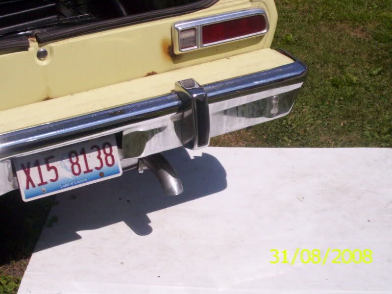

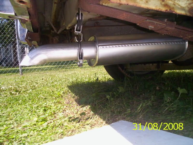

Now the first set of pictures show that i got my muffler hung.  I used the stock location for the rear hanger and a custom hanger for the front.  Now I have to do is the pipe between the header and muffler and of course the money.
and

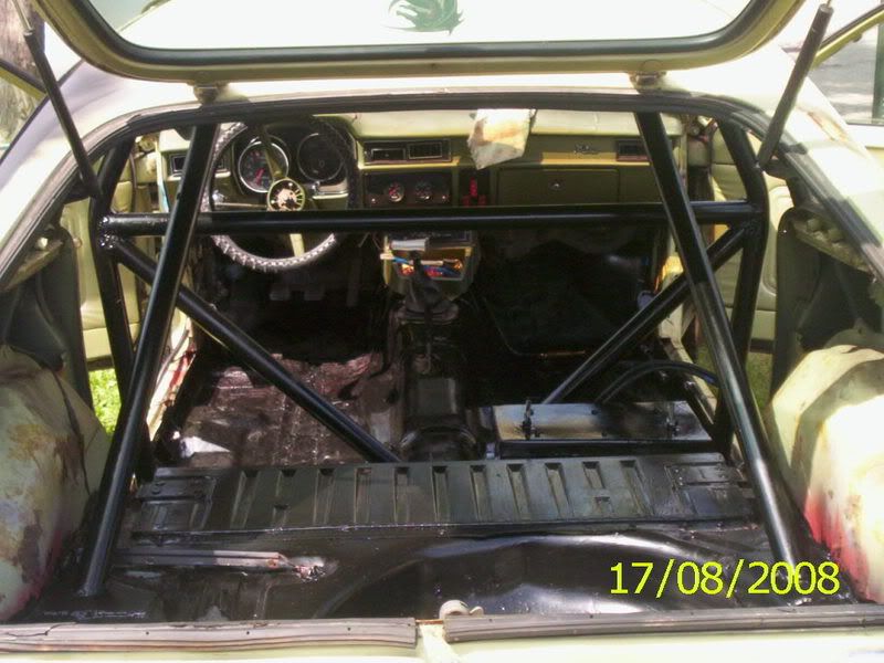

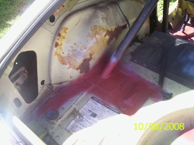

Well another busy weekend.  This weekends project was to paint the floor and rollbar.  I first pulled the seats out and found a few surprises.  I cleaned out the rust and chemically treated it.  I then sealed it and primed it.
The painting was done with one [actually three] of those sponge brushes.  They were neccessary because of all the cracks and creavases......  The paint i used was tractor paint which is a heavy duty enamal to which I added a shot of hardener.  The color was black.  The first picture is the before,
And the second picture was the after.
The entire picture series is available here. http://s93.photobucket.com/albums/l66/hellfirejim/Painted%20Interior/
A lot of work to be covered up by insulation and carpeting.....oh well you gotta do it right.
All this was not without some cost.  Saturday night my body was pissed off and Sunday night it wouldn't even talk to me.  It appears that I forgot that this old body simply doesn't turn like it used to........... :surprised:

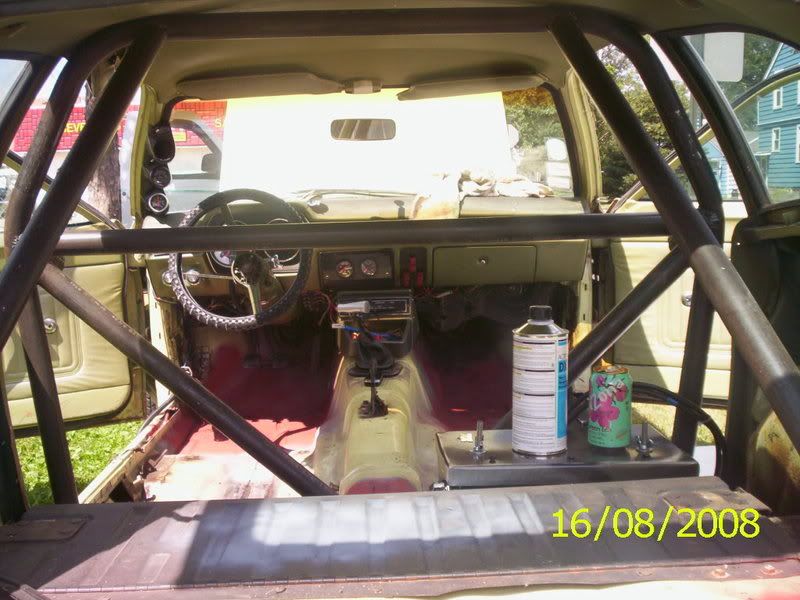

This second post is the start of working on the interior.  Since life is getting in the way of the brakes and exhaust, what I can do is start the work on the interior.  I cleaned out the car and brushed down all the surface rust.  Since this was an Arizona car there is no rot to deal with.  I first applied a chemical that stops the rust.  I covered that with a sealer and then some primer. Here is a couple of pictures:
The first picture is what I started with....
The second is what I ended up with.  Notice that the trim panel is gone.  The Arizona sun ate them up and they were turning to dust.  Sooo i will be needing a set..  anybody got any???

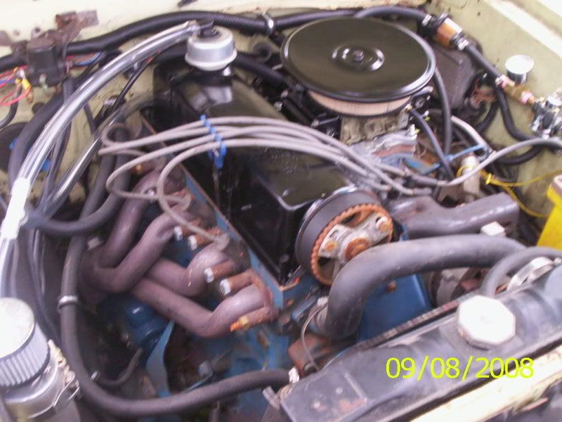

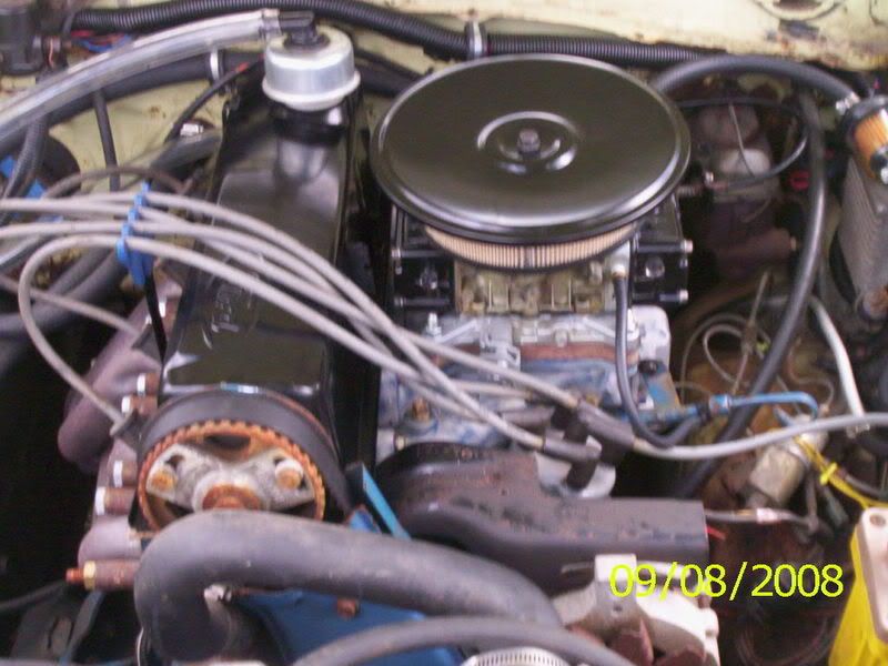

Tonight there will be two posts.  The first post will deal with a goodbye to the engine compartment.  I have decided that since the plan for next year is to move to EFI, I am going to accept the engine compatment as is and finished for now.  Here are a final couple of pictures.
and
And that is it for the engine compartment.
