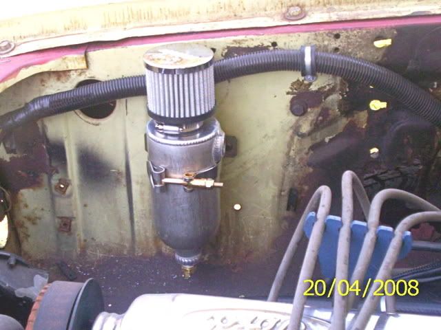

This picture shows the voltage regulator up front.  This will be gone when I get an internal Alt. It also shows the Accel coil mounted and the fuel reg with a pressure gauge next to it.  The fuel comes in the bottom and then over to the carb.

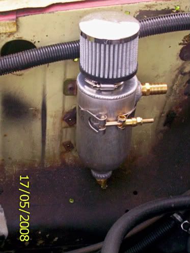

This is a better picture of the air breather tank.
Still have a ways to go to sort it all out.  Wires and stuff everywhere.. : )

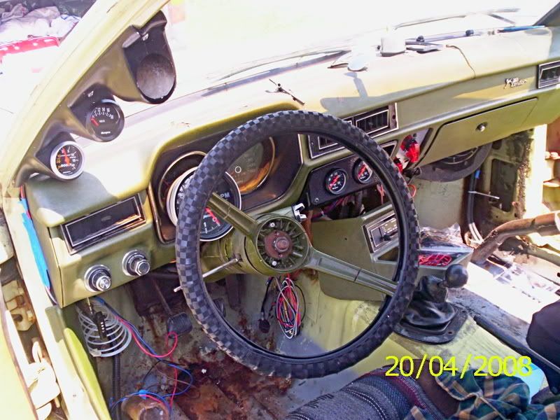

Well I got the dash and 3 pod installed.  They are not wired up yet as that will come when I have better access in the engine compartment.  Here is a picture.
and
And since I was on a roll I also installed the oil breather tank.  I just have to add a hose barb and then run the hoses.

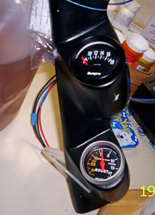

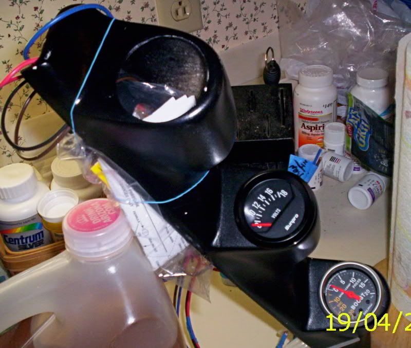

Something worth posting about.  I now have the dash panel and the 3 pod all pre-assembled and ready for install tomorrow.
The dash panel first.
And now the 3 pod from Mike.
and
The top hole is empty awaiting the A/F gauge.  Then it is a voltmeter and a boost/vacumm gauge.  Yeah i know it is a silver ring but I will take care of that later.  First i need to get it up and running.  I will do that when i start on the interior.
The only part that bothers me is drilling two blind holes to mount the A pillar pod.  I guess i should have mounted it empty first and then put the gauges in it.   DUH!!!! Oh well might just do that anyway.

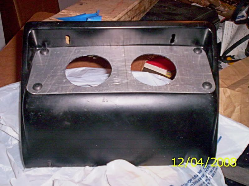

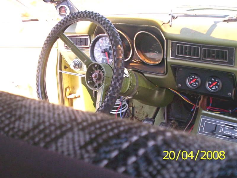

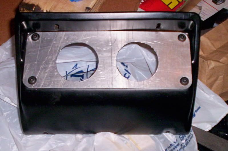

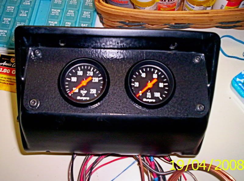

Well I actually have something to post.  I pulled the radio and opened up the plastic panel.  I then made an aluminum front plate to house two mechanical gauges.  Water and oil.  The pictures show the panel and fasteners.  I will paint the panel black before it gets bolted back in the car.  When that is done I will take a picture if anybody is interested or I might just post it anyway.  : )
and

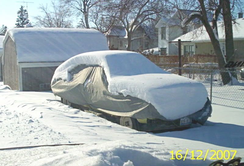

Well reality rears it's ugly head. My plan was to move the Pinto to a shop at times to work on it but I have found that due to my last health issue the cold weather is hitting really hard.  So I am going to leave it up on jackstands and car cover for the winter.  If it can't be inside then this is probably the next best thing.
