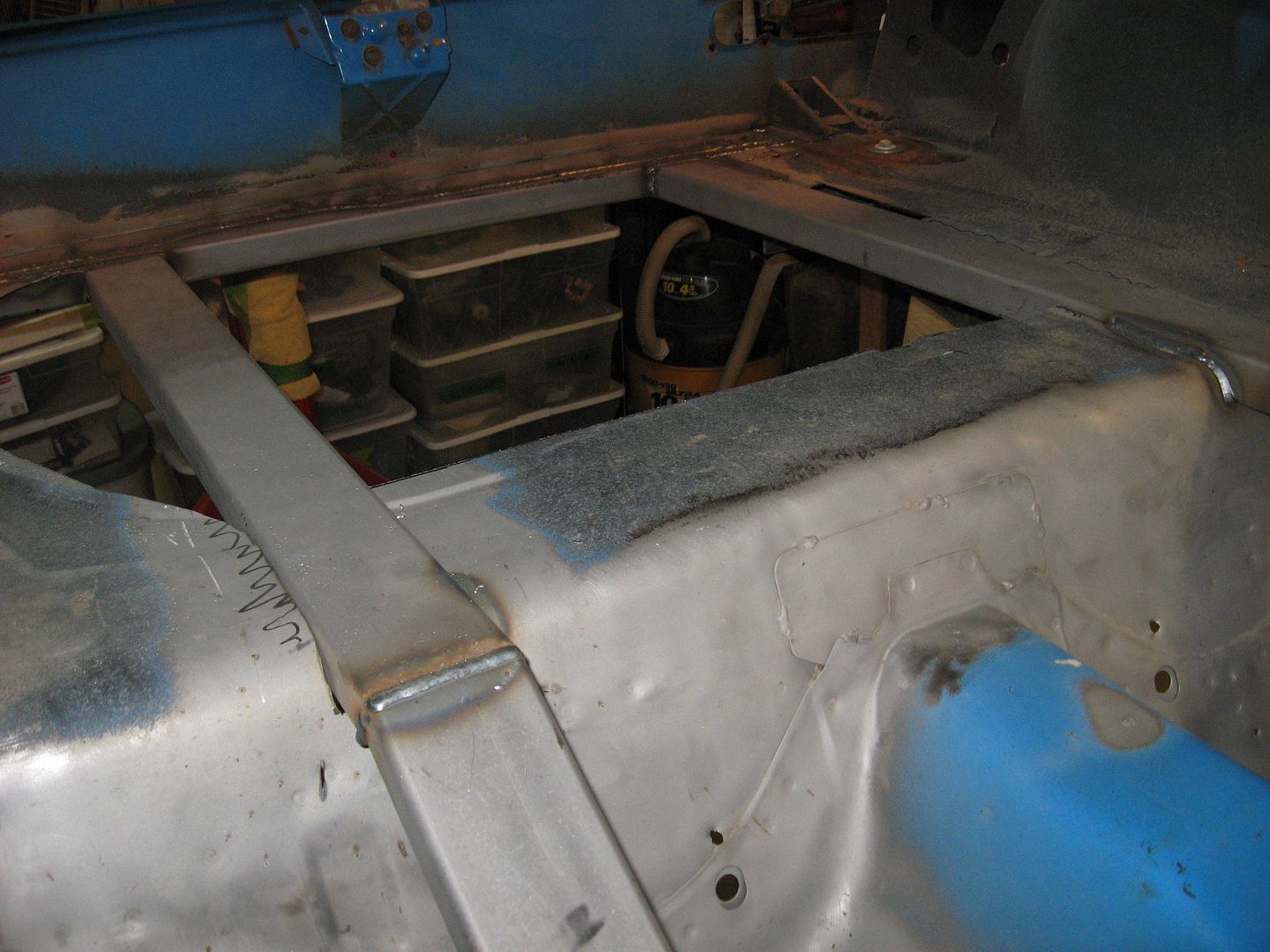

Blasting yesterday & cutting/welding today. Still have some pan welds to frame rails under the car to do. Then I can make the mods to the back seat area between the rails. This is for more room in front of the axles for "stuff".
Cut some of the old wheel wells out. Lots more to remove, but I'm down to one zip blade !
Note that the tubing at the back of the car ties into the OEM spring perches.

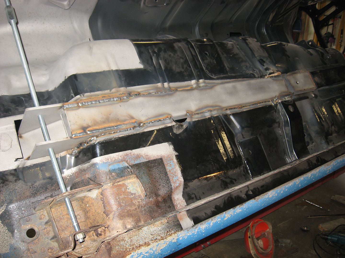

Got more done. More or less..... still have a cross brace to go in, which will be a place to mount shock tops & gas tank. Lots of fab work to the floor pan in the back seat area.
I removed parts from the bottom & next is some more blasting on the bottom side.
Yesterday blasted more areas & tubing for frame work.
First thing today will be welding in the braces that go from the front spring perches to the rockers.
Then start on the pieces going to the back , through the trunk.
This section will be done in two parts.
I'll be bracing the car up at the front spring perches. Then welding the new frame from the top, where I can.
Then remove the OEM shock & old gas tank brackets & spare tire well.
More blasting, then finish welding in where I can.
Going to take a couple/few days.....

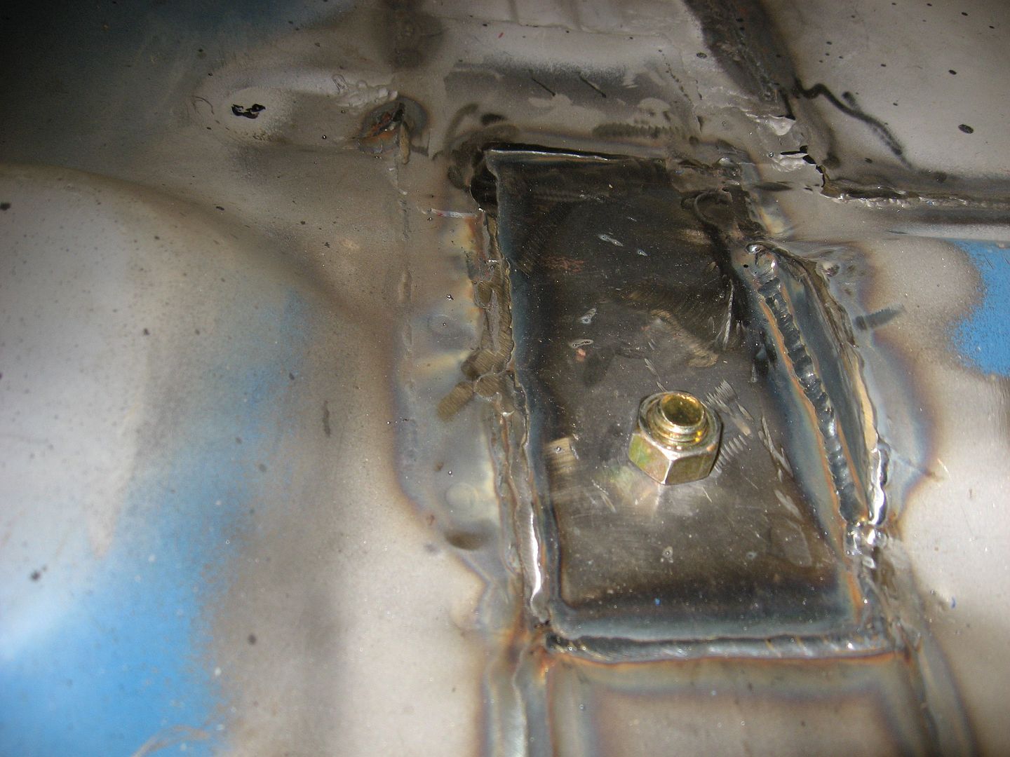

Tidy up day. Closed up the front inside & made attachment points for the crotch belt for a 5 point harness.
Bolt is for show.... need to get longer ones.
Lots of nice reinforcement there. The down side of sandblasting is that the sand seems to trickle out for some time, even after a good vacuum.

As can be seen (?), at the end of the first part, it angles up towards the trunk. Plan is to eliminate one angle at the back bottom of where the back seat was. Also have plans to eliminate about 1/2 of that area, allowing more room in front of the axles, in case I decide on ladder bars & in case I run the exhaust out the back, rather than dumping in front of the back wheels. (thinking about Caltracks as well)
Got started.....mostly welded in on this piece. More changes will be made in the seat area & will make more sense later....
