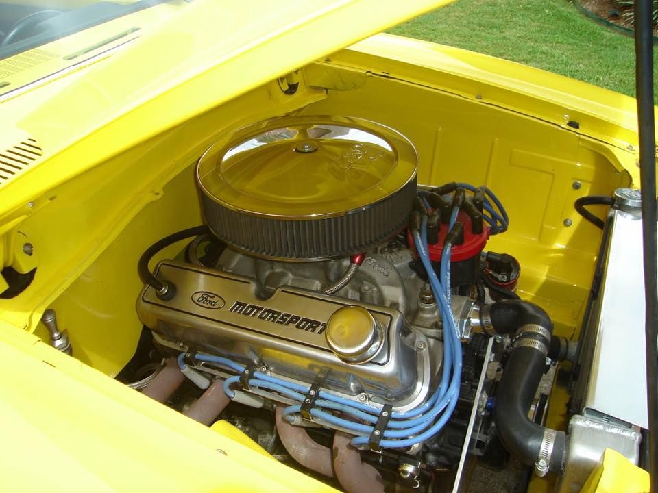

Was "happy" about how I made the white B2 engine compartment "pretty" with blue wire harness........ till I had seen this picture of a really clean install ! Never seen (saw ?) the like before !
Means the blue car is going to get more changes , down the road !
(except for a cut rad support !)
74 PintoWagon
That looks great. 8)

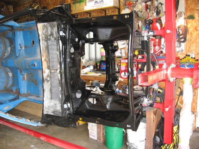

All the POR 15 done - 3 coats on top of box & 2 under the cowl.
It's clamped in place for test fitting. Fits perfect !
I'm missing some air fittings for my new spray guns, so didn't get the epoxy primer shot on the parts... yet.
Invented a new way to make a mess ! LOL !
Welded on the corner braces.
As you know, welding will burn off some of the POR 15.
So.....using a paint brush I loaded up all seams / holes (some at a time & after not enough card board on the floor) & blow it in / under with 25 lbs of air.
Good thing I also had old coveralls & safety glasses on  ;D
Going to hit it again ......
