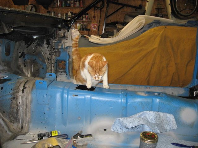

Looks like my car got a Cat Scan as well  ;D
Francis Stanisci
Damn that is sweet. Nice work!

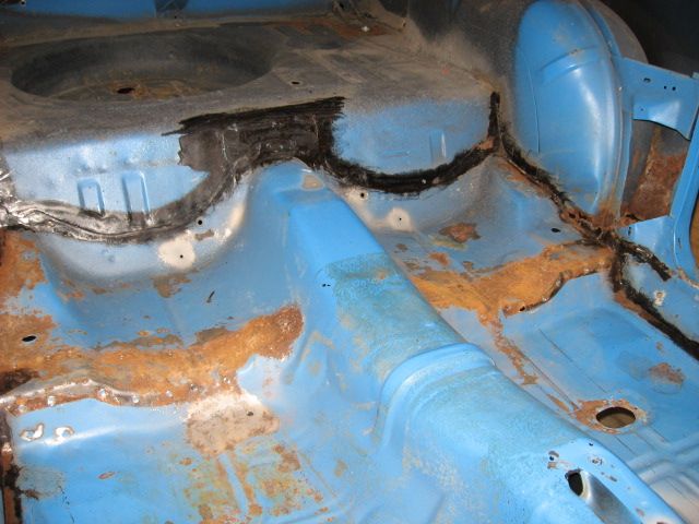

Had a short time to do a bit..... using the spot weld bit I removed the cross braces at the back seat area. Have to come out for SUB frames anyway.
Will be blasted (maybe today).
Perf area on right side floor. I held a light under floor to show better ?
No big deal / easy fix after SUB frames are in.
Running out of sand, time & $. Need to get back to work soon !

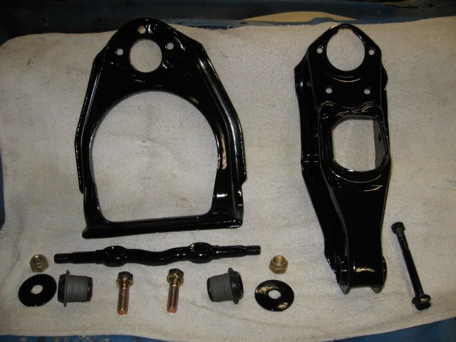

My upper control arms arepainted with new parts and ready for install too. I ground off the little teeth so as to let the bushings move easier for weight transfer.
Got tired of tripping over rusty control arms....
Blasted & POR 15  ;D
I have top bushings. After I get the bottoms I'll have them pressed in (and touch up the POR).
Will be new ball joints as well.
Getting new strut arms - already have the bushings for them.

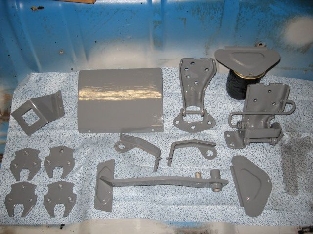

Got the small parts coated with POR 15 - but not black. Forgot I ran out of black , yet had a new can of grey. No big deal, they'll be painted Grabber blue anyway.

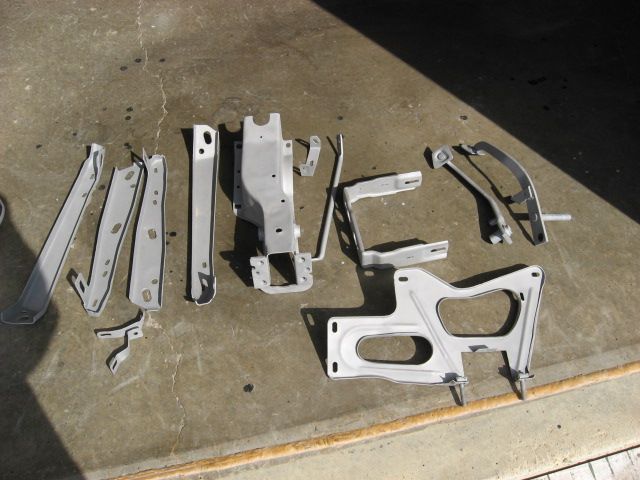

Yesterday was town day. Dislike town days because too much time is lost , sometimes the whole day.
Anyone that has looked under the dash , knows the unpainted OEM parts rust.
Hate rust....... so to salvage the day I blasted small parts.....you can guess what I'll do with them ?  ;D
