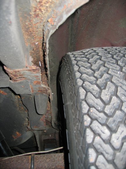

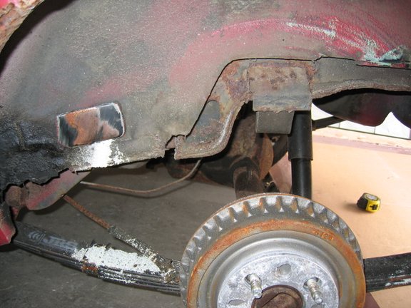

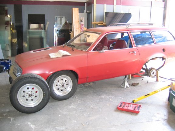

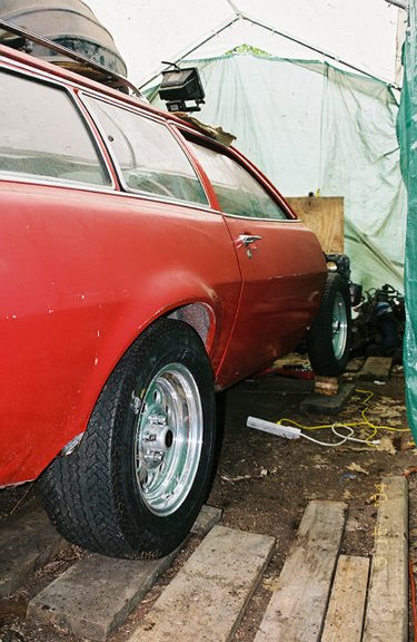

Turns out the tire rubbing (drivers side only) is from the axle being off center by 3/8". This pic is of the passenger side.
This is the drivers side. The photo needs to be flipped.

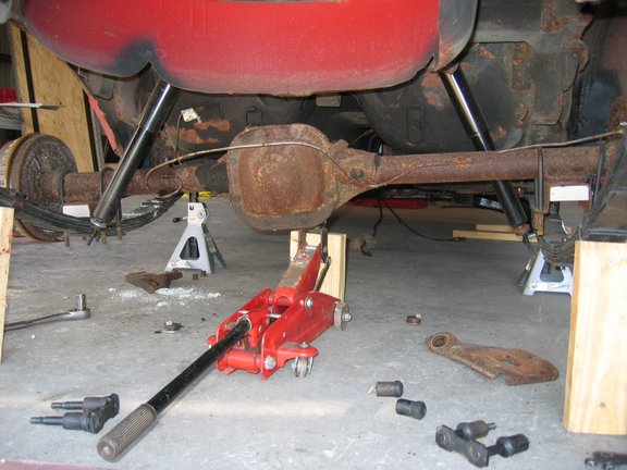

I took the rear suspension apart and checked the leaf springs for bows. They were fine. When I bolted everything up, the axle was still not centered. :-\
I then loosened the shackle mounting brackets and moved them over as far as I could. About 1/8". I found some washers and put them between the shackle and the leaf spring bushings. This helped a little but Im not trusting it.
BTW  The backspacing is 5 1/2". Im using a 1/2" worth of spacers on each wheel.

What size tires are you using on the rear? What size Draglites are you using and what is the back spacing?

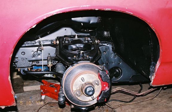

I smashed and cut holes in the wheelwell area. Good thing the metal is thin. Ive decided Im not going to keep this body. It is rusted too much for me to feel safe in it. Im fixing all the major parts but am going to leave a lot of things the way they are so I can get it on the road. This car is for practice now and learning.

I had to cut the last bolt (of course  ::)) off the passenger side front bushing. I used a cut off disk and the garage stunk like tire smoke. I should be able to use one of the bolts from the TC.

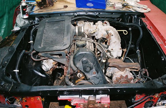

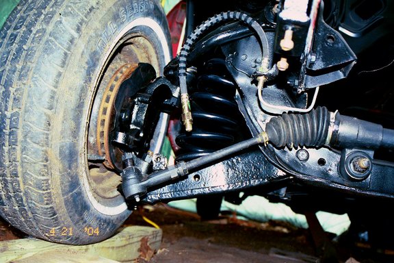

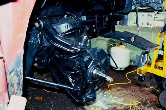

Ive added about 20 new pics taken last month to the album. Heres a few samples.
Heres the Gallery http://imageevent.com/pandbz/1979fordpintowagon

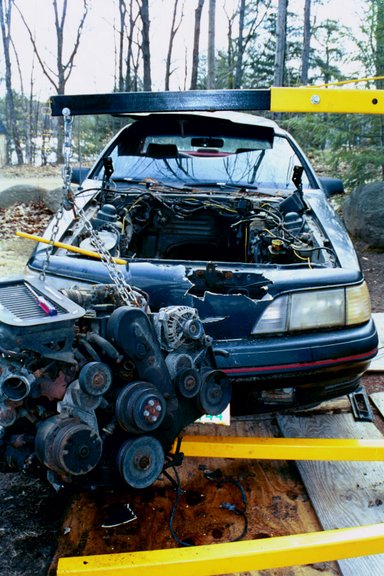

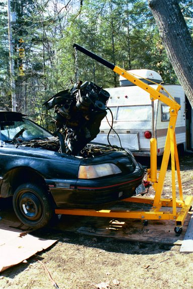

The engine and trans came out of the T-bird today.  I ended up breaking the top part of the nose of the car, by resting the engine and trans. on it.  ::) :D The car going to the yard in a while anyway. Otherwise things are moving along. I removed the accessories and motor mounts from the engine.
The engine and transmission are still connected and are in back of the Ranger. Im taking them to a car wash tomorrow to degrease them after work.
