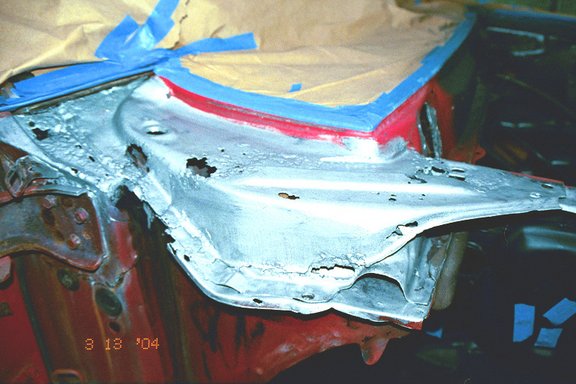

This is one coat of POR-15 applied to a very rusty area.

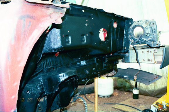

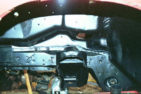

Passenger side after prime and paint.
Drivers side.

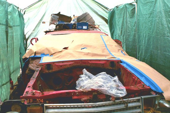

Right before applying POR-15 to the cowl area and priming/painting the engine bay.

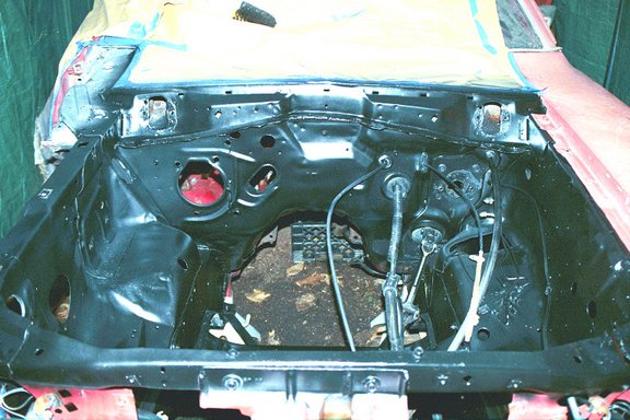

And the engine bay afterwards.
