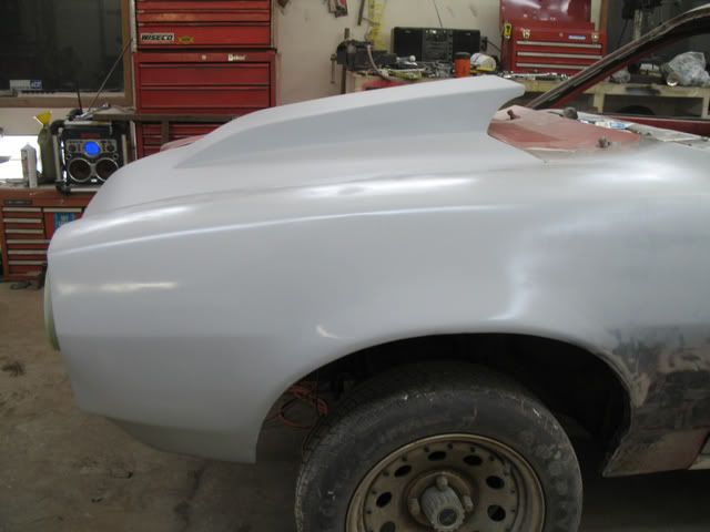

Awesome job on the scoop!  I can do alt of stuff (build engines ect) but body work is NOT one of them.  I would have been better off getting you to make me a hood than have spent $600+ on the UP22 crap!  I'm impressed!
mrpinto

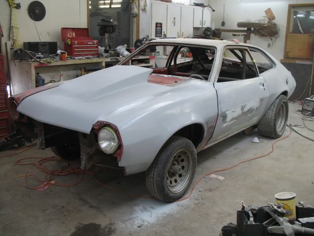

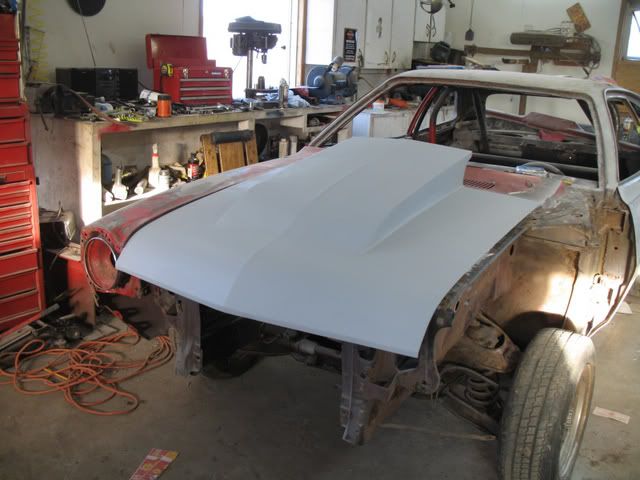

Finally got the hood finished. I think it came out pretty good considering it was in horrible shape, and it was my first attempt making a scoop form scratch. Cost a helluva lot less than the glass one I was gonna get too! But I suppose if I had to have someone make it for me, it would have cost the same, because it was almost 3 days of filling and sanding!. So I'm glad I watched my dad closely gowing up, and learned a thing or two!  ;)
Rub rub rub rub rub...Ugh! I'm sure glad to be done with that!!
All finished and primed!

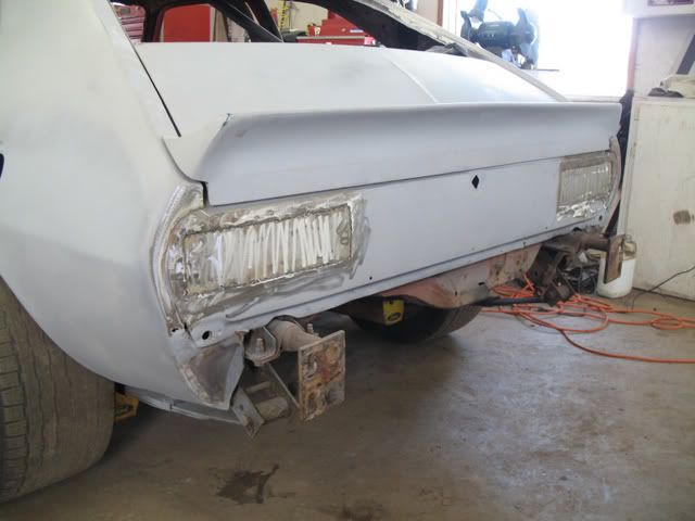

I also started on the tail lights. I cut out the old mounting holes, and welded in new pieces. I'm going to fill these out smooth, then cut out the new holes where I want them. I'm using front turn signals from a 89-93 Chev 1/2 ton for the light housing. They will work perfect for my custom lights.

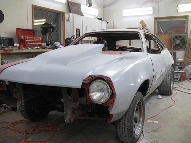

mrpinto

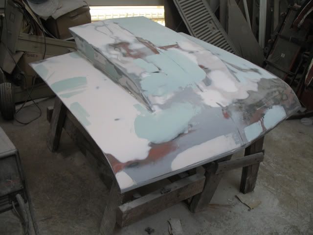

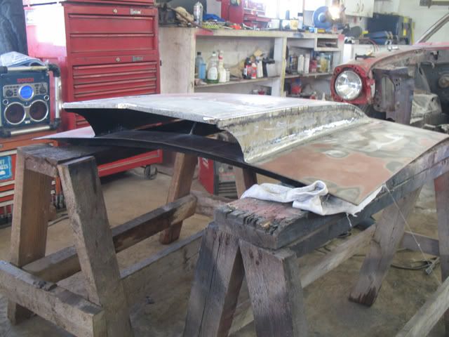

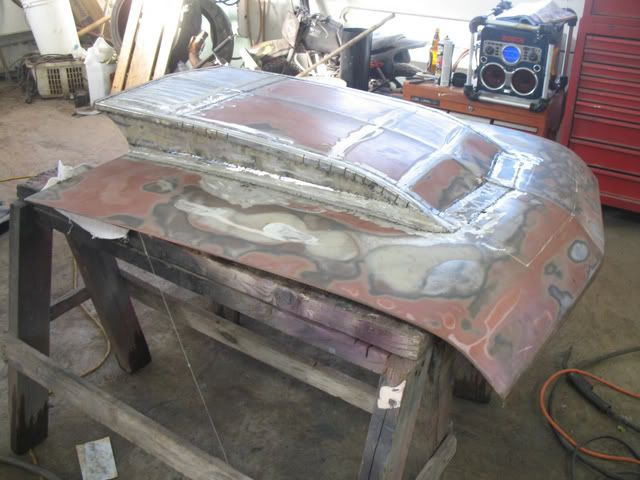

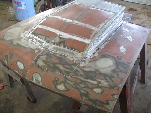

Soooooo, after a little hiatus, I'm back to the grind on the Pinto project.  After finding out that my hood was in "less than decent" shape, I decided to look for a new one. Well, unfortunately in my part of NA, a decent hood is next to impossible to obtain. I then contacted Unlimited products about their glass hoods. $300 plus almost $400 to ship!! :o
Then of course I see 78Pinto's posts about the hood he got from them. ::) So, I said the heck with it, and I'll do what I can with mine. Well, iot's a good thing I'm not afraid of Bondo!! LOL
I liked the look of the cowl scoop on the UP hood, and I'm gonna need the clearance for the 408W, so decided I was going to make my own version out of metal, then fill it smooth. I decided on a 4 1/2" high x 20" wide cowl. I cut the rear in front of the hood support, and forward a little before where the front of the hood starts to dip. It took a little "convincing", but I managed to get the top of the hood bent up. I then made the sides from 18g, and tacked them in at the rear, and slowly worked my way to the front so the top of the hood took the same shape. I wanted the illusion of a longer hood, so I added another 4" past the rear of the hood, over the cowl area. I finished the corners with rolled strips of metal to take some of the square "home-made-ish" look off it, and stiffen it up. I also welded in a small piece of rod in the center of the scoop for added rigidity. I think it will look pretty good once I smooth it out. And the best part, it only cost me about $20 in metal, a bit of mig wire, and a few hours getting flash burn! ;)
BTW, please excuse the crappy welding. I learned as I went along.

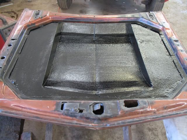

Cleaned up the underside a little. Also tacked the hood support to the skin to stiffen it up more, so less chance the fill can crack later on.
Whatchall think?

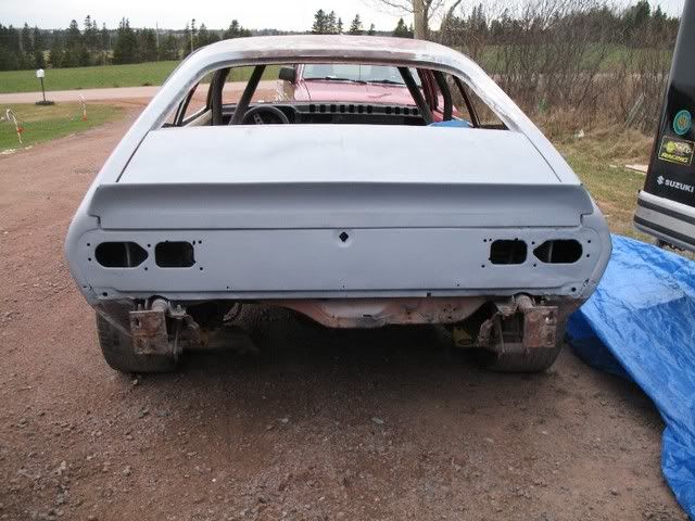

I think I decided what I'm gonne do for the tail lights. I'm not big on the Maverick ones , the more i look at them. They stick out kinda far, I'm looking for something a little sleeker.
After surfing the net looking at the rear of tons of cars, I came across a 68' Firebird. I thought the tail lights were super cool, and did a little cut n paste job on my pinto. I think it looks awesome!! It's just the sleek look I was looking for.

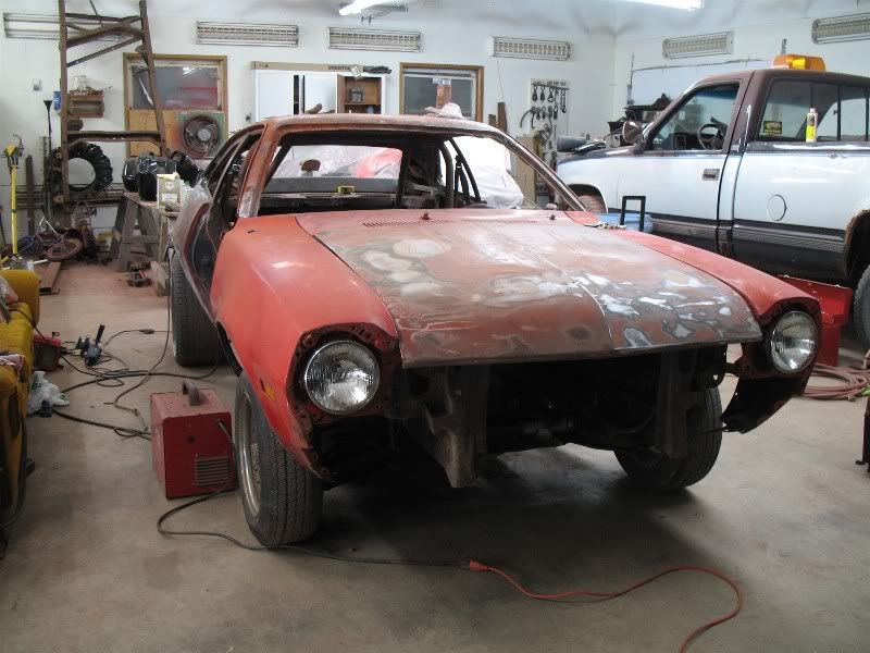

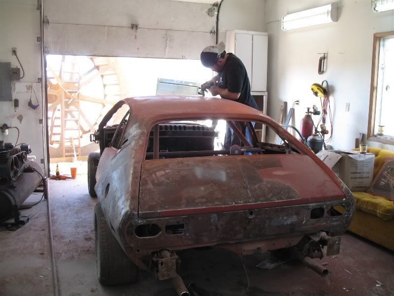

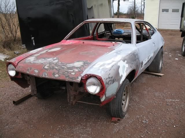

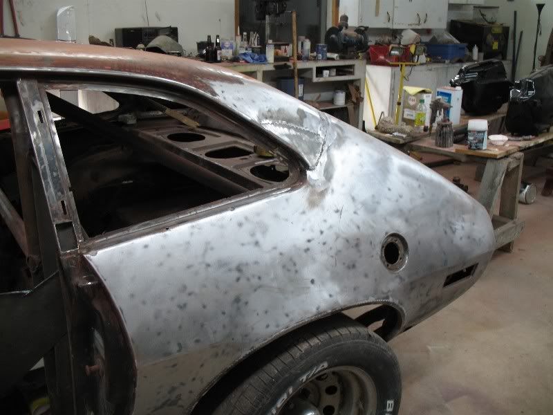

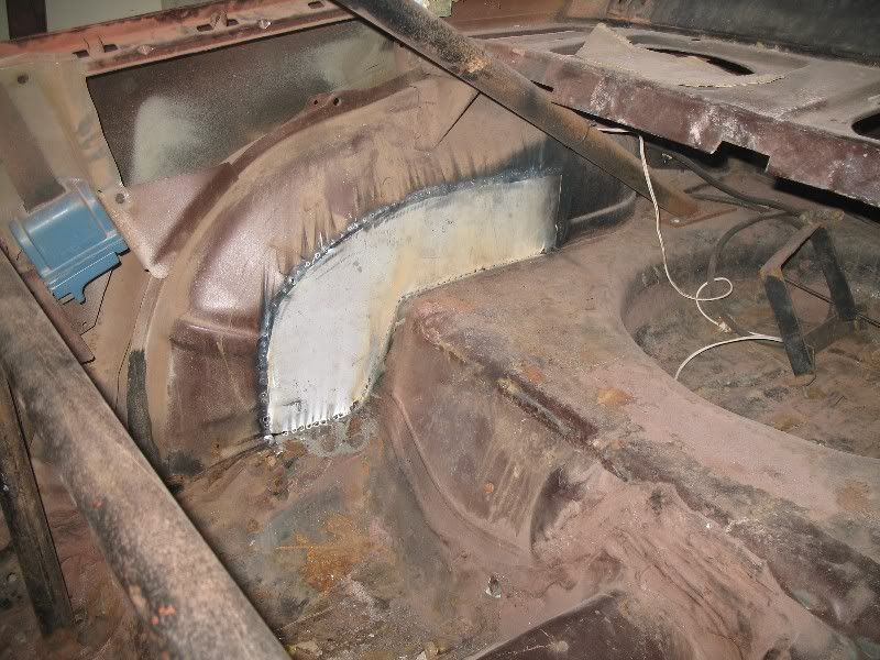

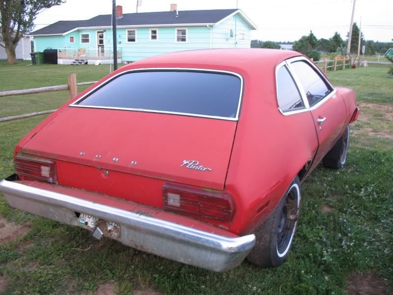

Well, the pace is SLOWWWWWWWWWW on the old Pinto. I only get a couple days a week at it, but I'm keeping at it.
A few more pics on the progress.
Late summer, a sad state and lots of nasty superises under the paint!! :o
Hours of a wire wheel. Conned my brother into helping with the dirty work! ;D
Both sides behinds the rear window were rusted/cracked badly, and needed some new metal.
Got the early style fenders and hood in place. Found out later after a few hours of stripping and grinding that I need a new hood. :mad:
Found some espessially nasty areas in the rear wheel well area.
Here's where I find out the other side is just as bad!!
Disgusted! :hangover:, this thing is NEVER gonna get done!!!
Current state. Still lots of work ahead, but it's coming along. MAN I hate dents!! >:(

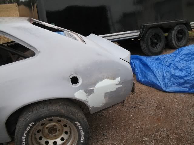

Got the rear spoiler (Thanks Don!) molded in. Looks great! Also got rid of the side marker lights as you can see.
Another shot of the spoiler. I'm going to smooth out that area where the quarters meet the rear panel to clean things up. I need ideas for custom tailights. ???
That's all for now.

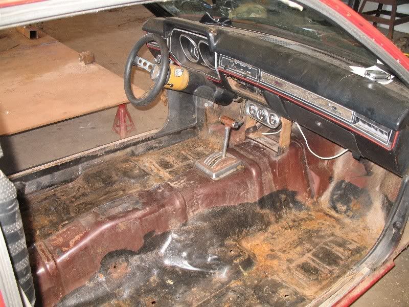

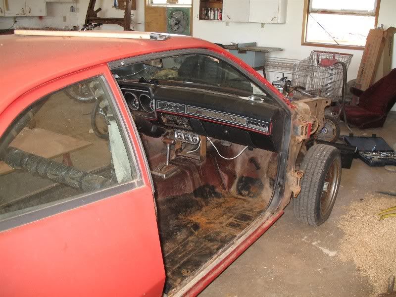

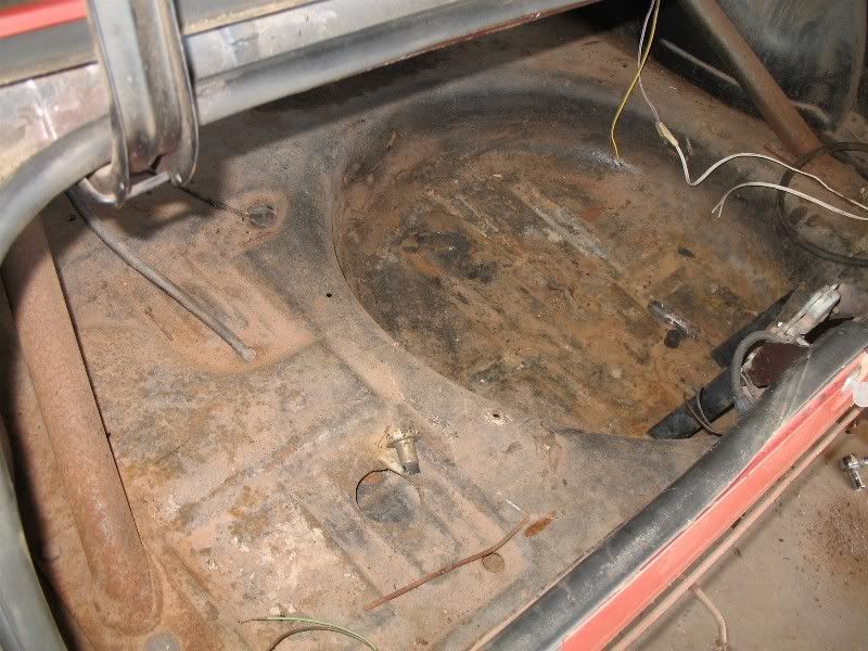

Some pics after I started taking it apart. Floor wasn't too bad, but some rust issues. Driver's side being the worst. Trunk area was in great shape.
1979 302 Pinto Custom
1971 460 Drag Pinto

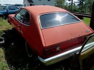

This is the main donor car. '78 sedan. Got it for $300 with the intentions of fixing it up, then found out the car is totally rotted underneath. (When we lifted the front, the rear spring perches sunk into the car!!) But it has a really good solid set of fenders, and the doors look to be in very good shape, much better than on the 79. (The window frame rusted completely off on the rear of the driver's door!)
It's a shame the car is so rotted, because the body is in such good shape.
