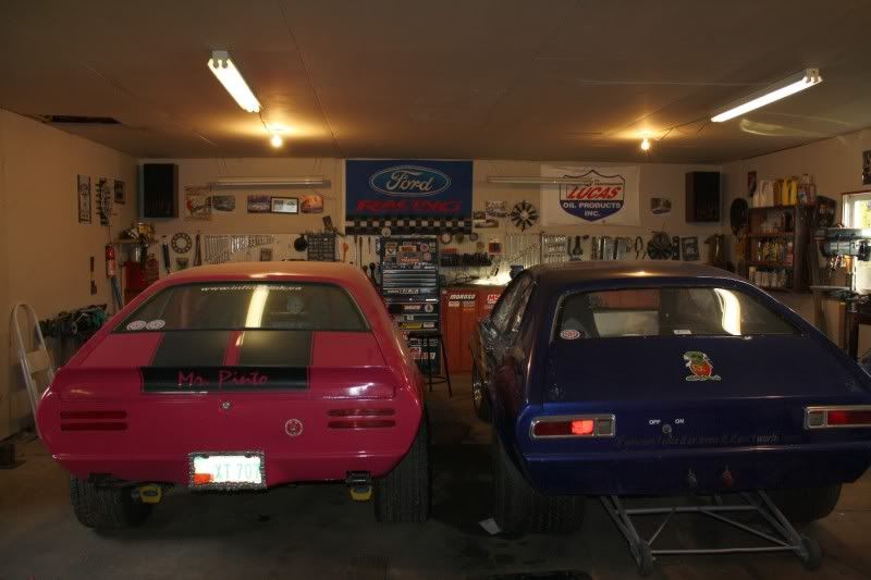

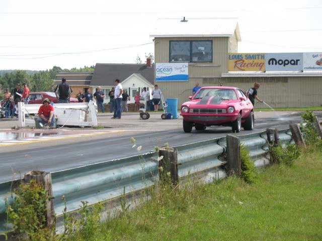

I've got a few miles on the Pink Pinto, and had a ton of fun in it. Did some racing, got it as fast as 11 secs in the 1/4, then decided to build a full on drag version, so I sort of "detuned" the Pink car to improve the street manners. I now take it out the odd weekend, to car shows etc. Been a few years now and my bodywork seems to be holding up ok, haha.
Here's a pic I got this summer.
Also have a drag Pinto with a 460 that is about 90% complete, but I expect it to be a mid 9sec or so. I keep the two "girls" in my little "stable" ;)

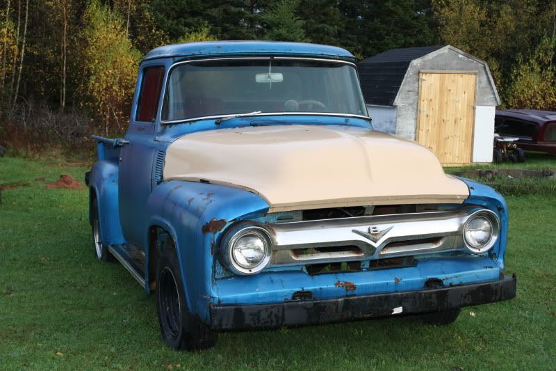

As for my next project, being a pretty die hard Ford guy, I couldn't stray. But it's gonna be quite different than the Pinto. I can't wait to get at this thing. Still in the planning stages as of yet, but maybe I'll start a new project thread on it, although it isn't a Pinto.
1956 Ford f100

New best at 12.26 @ 108mph. Going through the traps at 5300rpm, so more gear is in order.

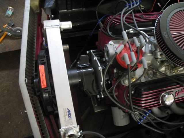

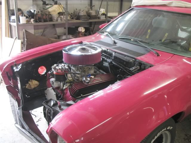

The fresh engine it it's new nest.
I think I overdid it with the 14x4" breather! Won't clear the hood even with the big scoop!!

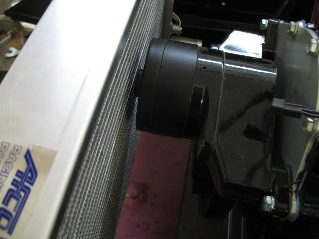

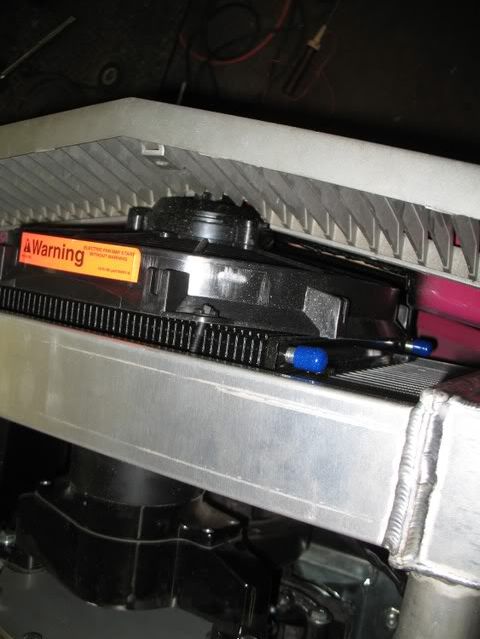

New Proform electric water pump, Afco "Scirocco" aluminum race rad, 11x11" tranny cooler, and 12" Flexalite fan installed. Also a new K&N 11x2" Xstream Flow breather sits "under" the hood!
It's a TIGHT fit!!! :o
And when I say tight, that's exactly what I mean!
A bit of wiring, a few hoses and we're good to go! 8)

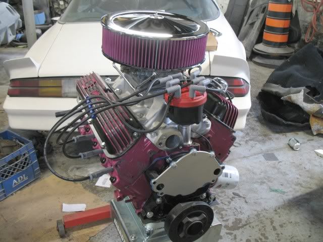

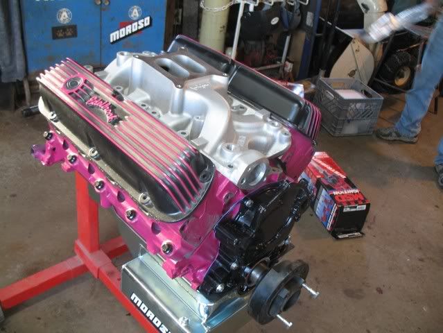

After some delay due to finances, I finally have my engine pretty much together.
I snapped a few pics along the way.

This is my engine / drivetrain combo.
'88 306 block
SP power forged pistons
Ported World Windsor Jr. 180cc heads (1.94/1.60 valves)
Proform aluminum roller rockers
Comp XE282 roller cam  (.565 / .574 lift - 232 / 240 dur @)0.05) and matching springs
Ford Racing Hydro roller lifters
Weiand Stealth intake
MSD pro billet dist., coil and 6AL box and wires
Holley 650 mech. DP carb
Proform 35gpm electric water pump
SP high volume oil pump
Moroso 8qt oil pan
Carter electric fuel pump and Holley regulator
Rebuilt C4
Stage 2 Transgo manual valve body
Heavy duty clutches
B&M Megashifter
Rebuilt 8" rear
Motive 3:80 gear
Richmond 28 spline axles
Richmond Loc-Rite locker
Cooper Cobra 295/50R15 tires (26.5 high)
This combo should hopefully move this Pinto easily enough.
And of course I had to carry the color scheme under the hood! ;D

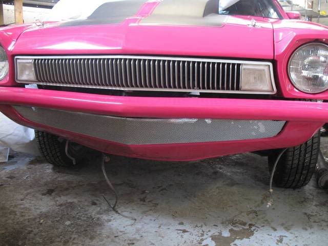

Haven't posted in a while, so here's a set to update y'all with Mr. Pinko!
I wasn't a fan of the opening in the valance, so I made a filler panel made out of perforated metal to fill the area but still let air flow through freely.

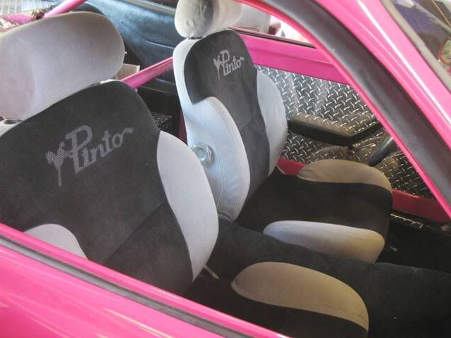

Got a set of seats out of a Murker XR4Ti, cleaned them up, used some fabric paint on the dark areas, and masked off the Pinto logos for a little custom touch.

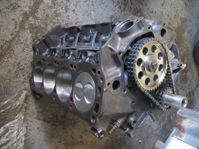

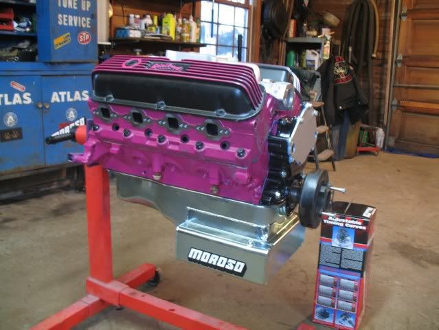

Here's the freshly built 306 shortblock. New SP forged pistons, rods, turned crank, new timing set, and Comp .565/.574 lift roller cam. On top are going a pair of World Windsor Sr. 200cc heads. This Pinto is gonna fly!!
Oh BTW, the engine is going to be pink too!! 8)
