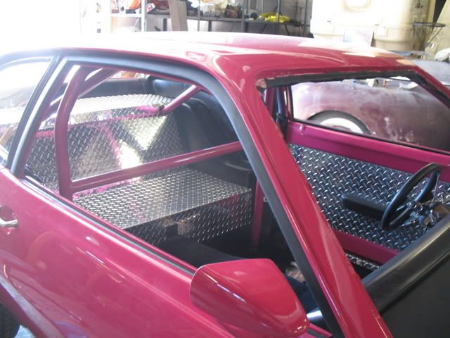

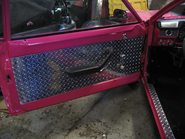

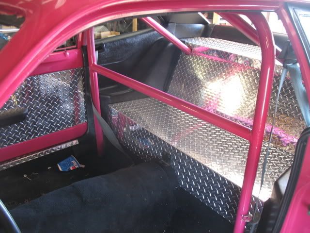

So I know how you guys like the SHINEY around here. Well, I have a contender for the "Shiniest interior in the WORLD" award!

Thanks guys.  Hopefully everything will come together soon and it will be a complete car. I have more progress on the interior. I'll post more pics when I get em.

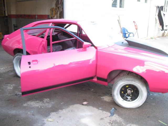

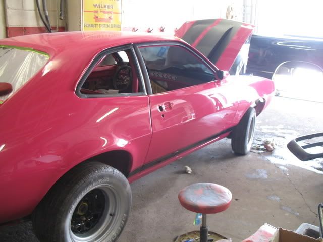

Got the satin stripes on, along with a little custom touch on the rear wing!  Oh, and I also decided against the black on the dash, and painted it pink.
I'm extremely happy with how well the hood turned out!
1979 302 Pinto Custom
1971 460 Drag Pinto
1971 Pinto
Pink and Black Rock!!!!!!!!  Unintimidating yet.....Badass!!!!!! Truely an exterior combination denoting opposite ends of the phychological spectrum. Colorfull schemer.
I am excited!!!!!

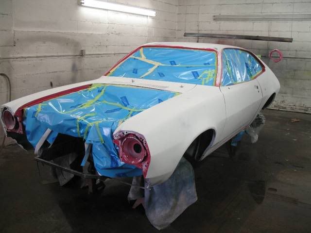

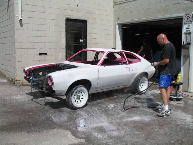

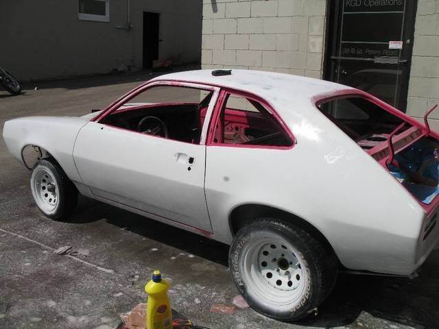

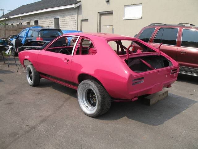

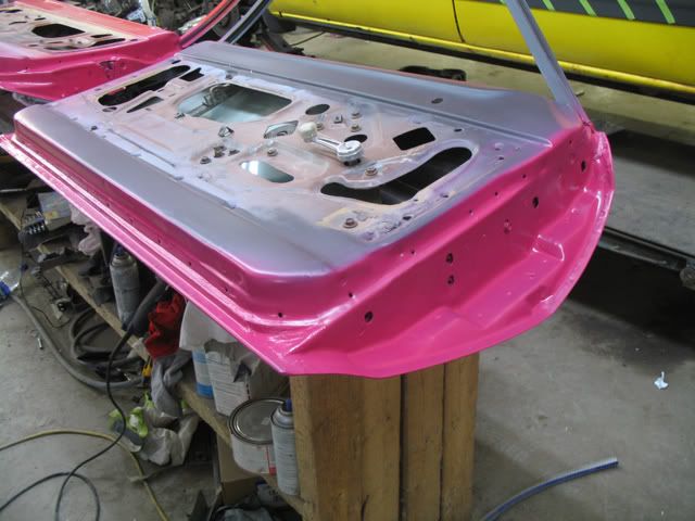

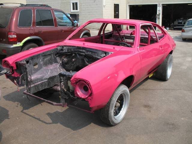

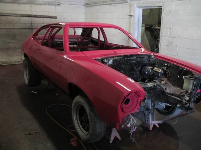

Anyhow, after a few setbacks, my car finally went to the paint shop for final prepping and paint. The pics do not do the color justice at all, it pretty much GLOWS in the sun!! I love it!
Final washing after all the blocking was done.
Notice anything missing?
Ready for the long awaited color!

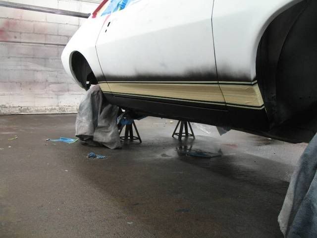

I put a black stripe along the bottom just above the rockers reminiscent of some of the early Fords. 2 large semi gloss black stripes will also go on the hood and the trunk lid.
Paint on and cleared. Taking off the masking is like opening a present at Christmas!! The color looks almost red when out of the sun.
In the sunlight the color brightens up a lot!

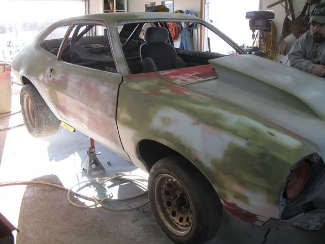

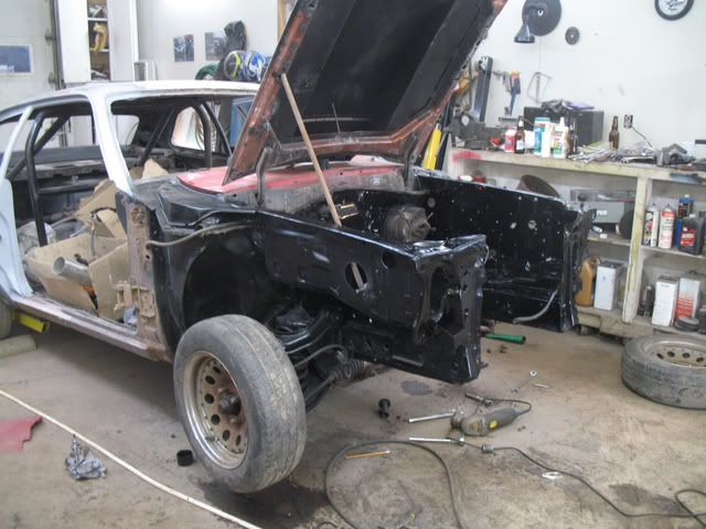

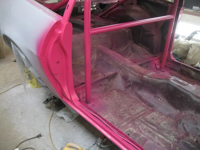

More progress on my car. Body work is DONE!!!! Finally! I never want to see another sheet of sandpaper as long as I live!! haha
It's finally getting some SHINEY!!

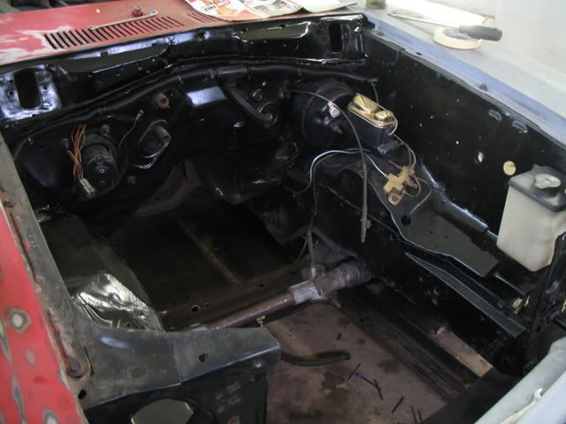

Under hood area.

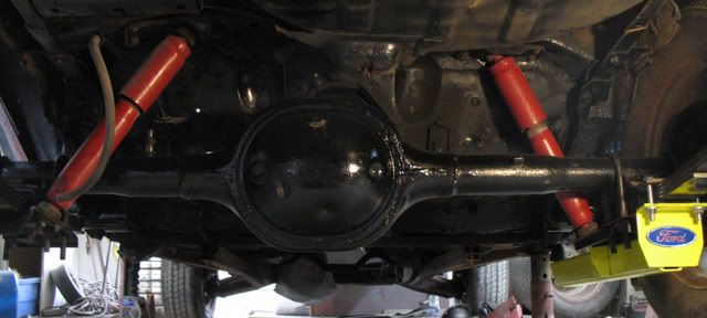

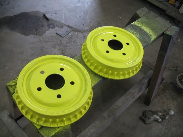

New Ranger brake drums.
All new brakes front and back, all new lines and hoses.

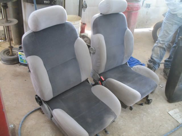

Here's my seats. Out of an XR4Ti. Very comfy, nice features (adjustable lower lumbar support, tilting headrests) I welded on the brackets from the Pinto seats.

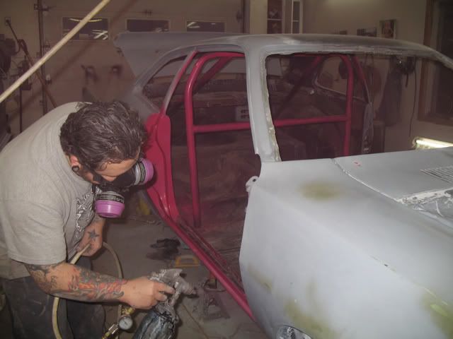

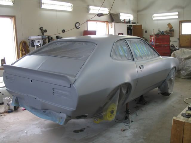

Bodywork finished, prepped for high build primer.
3 coats of 2k primer.
All block sanded. Got the woman to help clean out the dust to get ready to paint the jams.
Now a little taste of the color!! :o

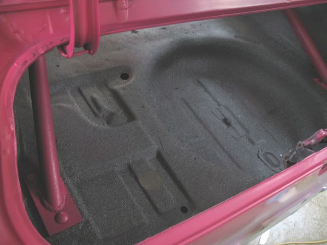

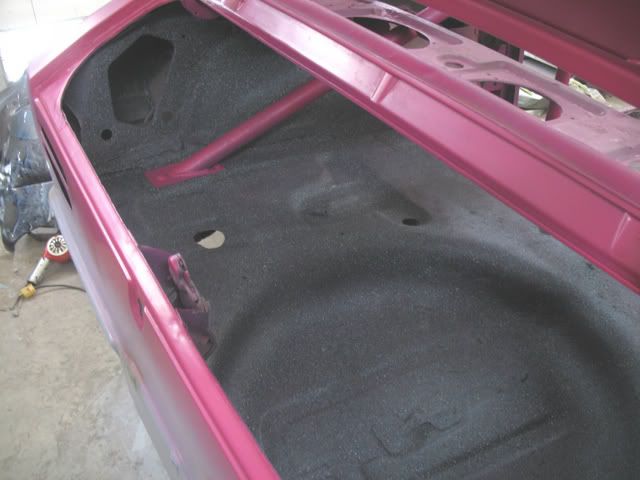

Inside the trunk I used this black and white speckled stone stuff used for yard ornaments. Found at the hardware store pretty cheap. Looks great. Reminds of of the stuff used in the old cars back in the day.
So that's it for now. Car will be in the paint booth on Monday. Got a pro painter friend going to spray it for me. I'm comfortable doing the jams etc, but too much dust at my shop!! Once the paint is on, it's interior time while I wait for the clear to cure fully before applying the black stripes.

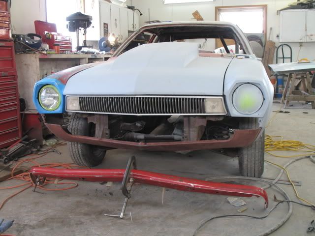

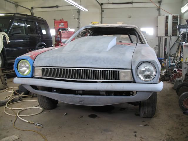

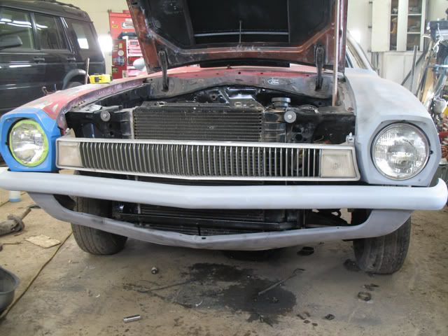

Some more pics. Not a whole lot of progress in the last couple weeks. Got the front end cleaned up and together, bumper finished and mounted, and rad installed.
Using the rad from a V6 Ranger. Rad was in excellent cond. and the price was right..FREE! Got it about where I need it, just a few adjustments for clearance. I'm going to cut a piece of diamondplate to cover the top. You can also see through the valance, I welded a cross brace between the frame rails to stiffen up the front end a bit.

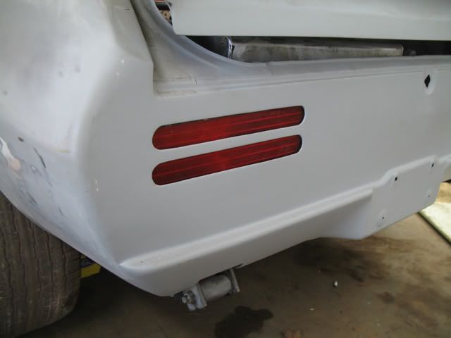

For the tail lights, I'm using the housings from a 1990 Chevy Silverado, and the lenses from a Honda Accord. I mocked them up and took a pic to show what they look like. I'm going to mount them with 3M double sided mounting tape. I think they look slick. 8)
For the front bumper, I cut up one from a 78, bolted the top and bottom together and filled the seem. I mounted it right up to the body. Looks much cleaner.

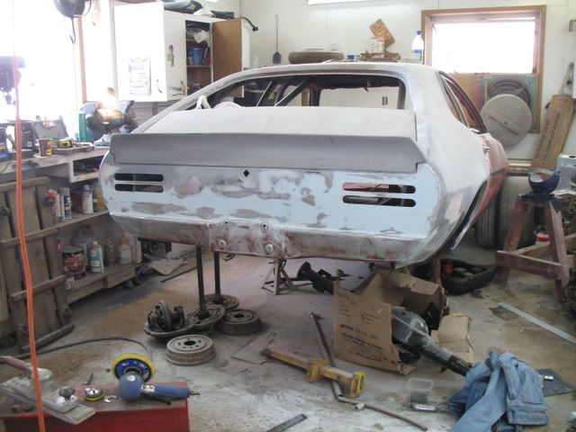

Got the rear end body work pretty much done. Only minor things here and there. I think it looks kickin! Never seen one like it.

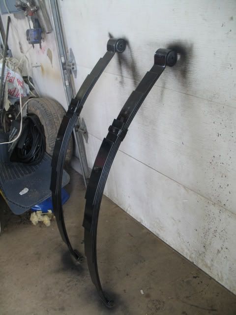

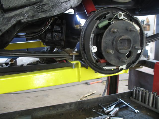

After a few weeks in the air, it nice to finally get the rear back under it. Both pairs of leaf springs I had were broken!! :mad:, and shipping a new pair to my location was gonna cost me a fortune. Luckily, there was a guy just down the road who does leaf spring work, so I had a brand new set custom made.(still alot of $$$ :( )
Starting to bolt it all back together. The new springs are STIFF! :o Hopefully will settle some.

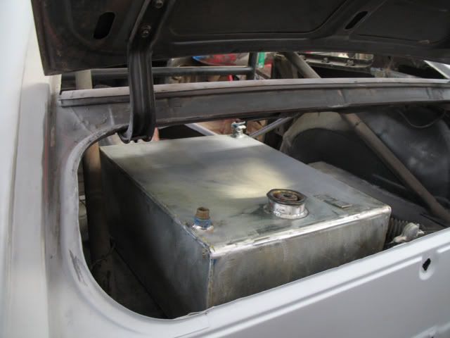

Here a shot of the aluminum fuel cell I got for free! 8) Just got to finish cleaning it up, and mount it in. Fits great!!

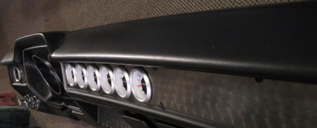

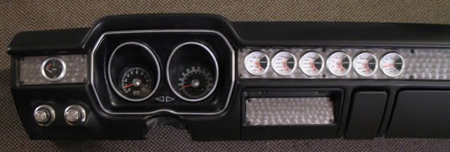

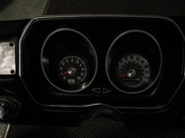

Update on the instrument panel.  I wanted the tach I used to be more of a factory look instead of bolting it on the dash or column. As luck would have it, a good friend of mine just happened to have an old pro mod stock car out back amongst a pile of old wrecks and it had a 3 1/2" tach in it, along with a perfect fuel cell!
I took the instrument panel apart, and the tach fit so perfect, it looks like it was made for it! I just had to remove some of the white plastic to clear the tach. I also took the silver center button thing off the fuel guage and fastened it to the tach needle so it matched the speedometer. I also repainted the bezel (Krylon Fusion rocks!) and handpainted the silver trim. Looks brand new! 8)

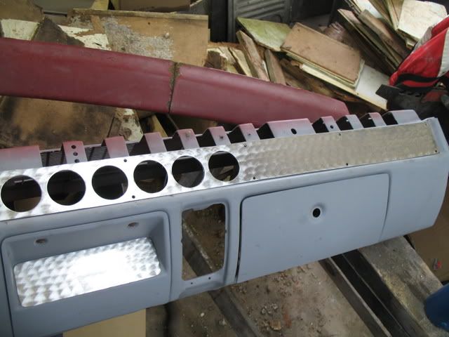

MrPinto,
         The spun metal looks good as well as you gauge layout. I'll bet you spent a little time in front of that drill press. I might do something like that down the road but first I need to get a T.V. in the garage.  Lookin good!!!
i agree on the rolled pan look.  i've seen oter cars with that type of mod and they all lack a sense of definition.  the lines that you have built in will, i think, make the whole thing a lot more appealing

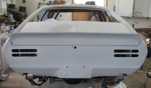

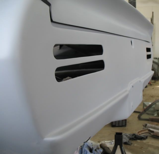

As stated earlier in this thread, I said I was changing the tail lights, and I did. I also decided to change the look of the rear by removing the bumper and molding in the roll pan. I decided I needed some sort of line there instead of just smooth. I seen a few don by smoothing out the whole back and I don't like it that much.
What i did was just weld on the roll pan, and weld in strips to cover the gap that the bumper normally covers and mold the whole thing together. I'm not finished yet, but I thought I'd post a pic to see what you guys thought.

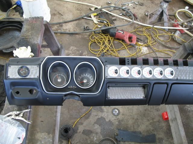

I also started the dash.  I took it from the doner car because it's in better shape (other than the dash cap).
I sanded and repainted using JD Blitz Black. I also cut out some 20g sheet metal to cover the vent openings and also for a place to mount the guages.
I always liked the look of the spun metal finish, and decided to try it out. I think it came out OK. After I was finished I painted the bare metal with a transparent black to darken it up but still let the effect come through.
