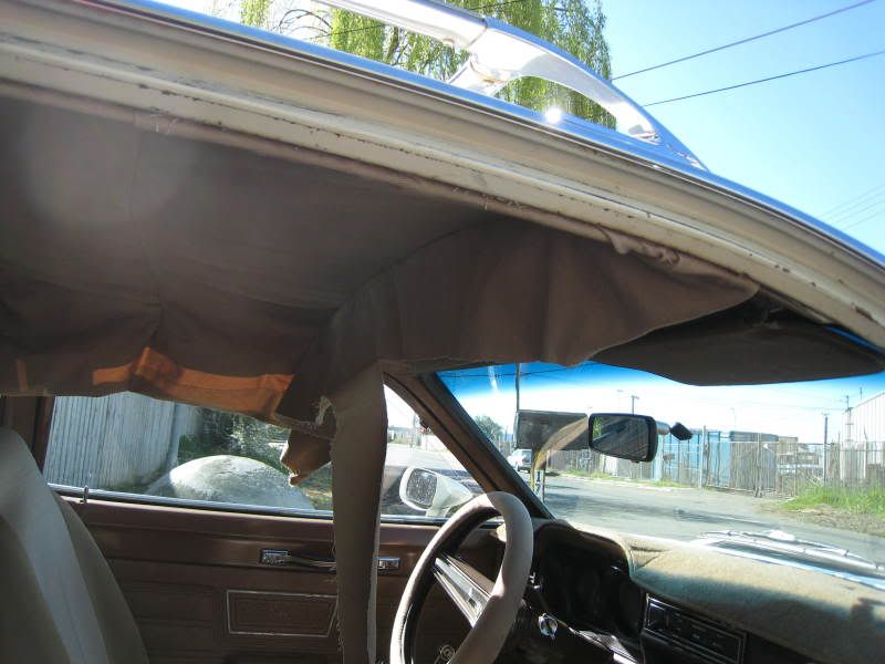

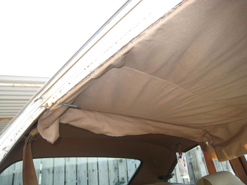

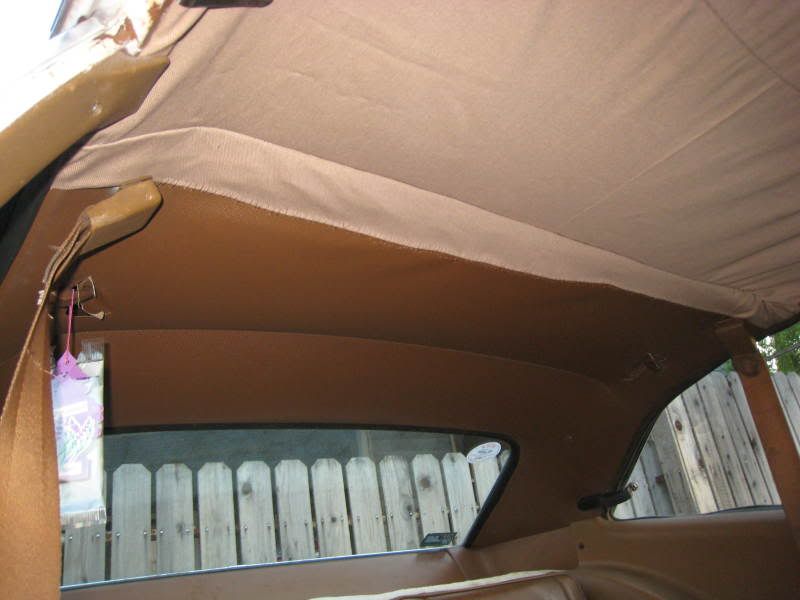

In the spirit of getting ready for Knotts, I fixed my yuckky headliner!! It is just a patch, but I am suprised, it didn't come out all that bad. Just a bit of Frankinstien stitching on both ends, but other then that it all tucked up nicely!!! Here are the pics, of course!! LOL
Before..

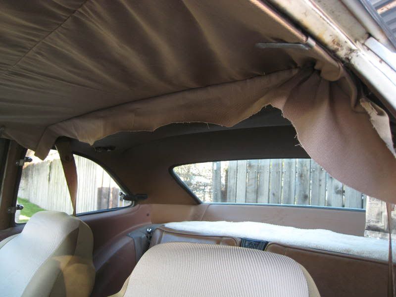

In the process..
I took the bars that hold the headliner off, after I measured the distance between them. Then I brought them in the house and layed them on my material in the distances they needed to be at. I pinched the material and pinned it. Then removed the bars and headed for the sowing machine. I'm not much of a sower, but all and all things went pretty good, well except that my bobber threader didn't work and I only had one bobbin that fit, so I had to hand thread it!! LOL Once it was all sewn I put the metal bars back through the slots I just made.
I went to the car and proceeded to install the 3 bars with my new headliner patch. Things weren't going to well, the bars seemed to be way to big in some spot, but to small in others. Then I realized, I should have marked what bar came from what holes and what position in the car! LOL I figured it all out and started to push patch headliner into the side rail thingy's. LOL
Here's my Frankenstien sewing! LOL It was the only way I could figure out how to attach the front and back to the old headliner.  ;D I used a curved needle to do this. What a pain in the arms that was!!  ;D

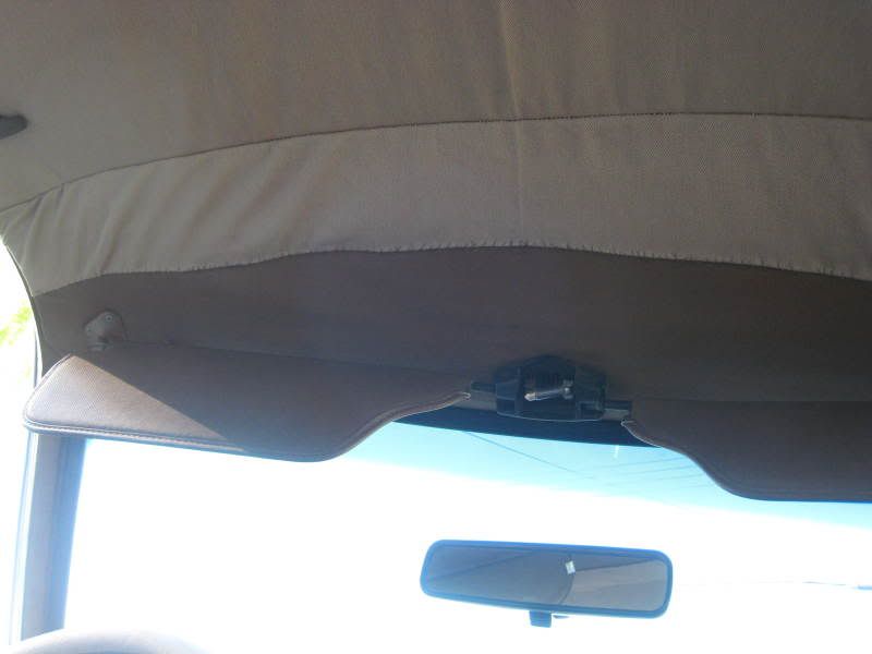

Not to straight,
But you can't tell that much with the sun visors up! LOL
Starting on the back,
All tucked in!!
All done!!

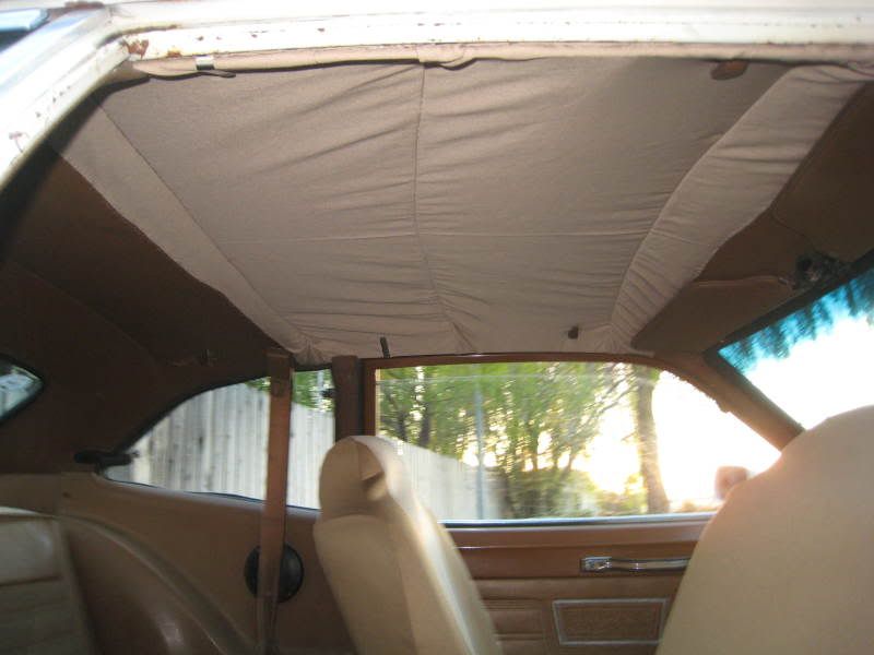

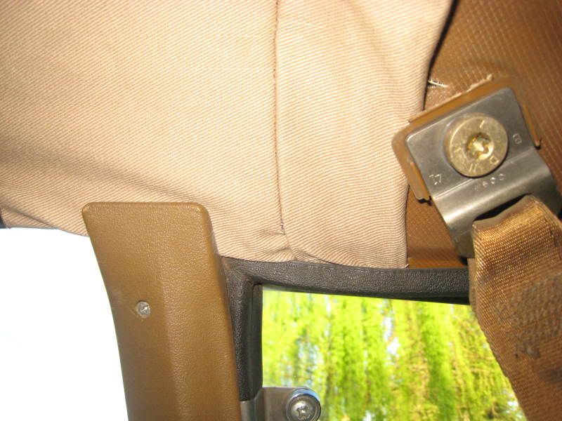

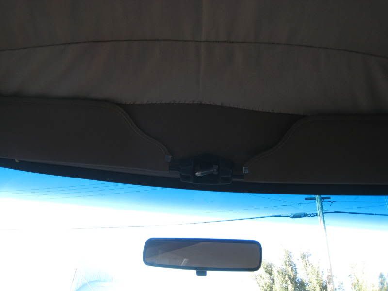

After...
It's not the best. Kinda luppy here and there, but it is better then the before pic and at least the roof padding is safe now. I can actually roll my windows down all the way now!! LOL

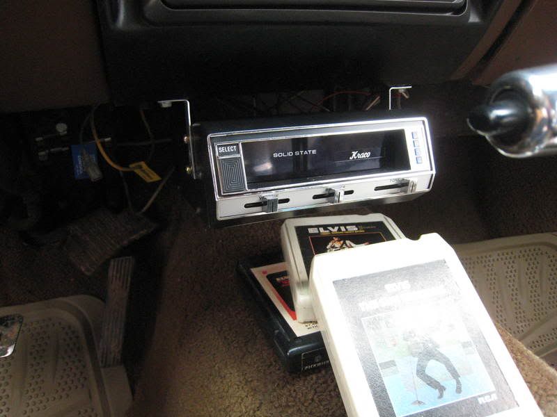

Today I finished up the windshield install. Cleaned everything and put the chrome back on. Then the mail came and my brand new 8 track player arrived!!!! It had never been hooked up, all wires were still uncut!! It was an ebay find!!! Roughly 40 bucks is what I paid for it!!!!
Here are some pics!!
