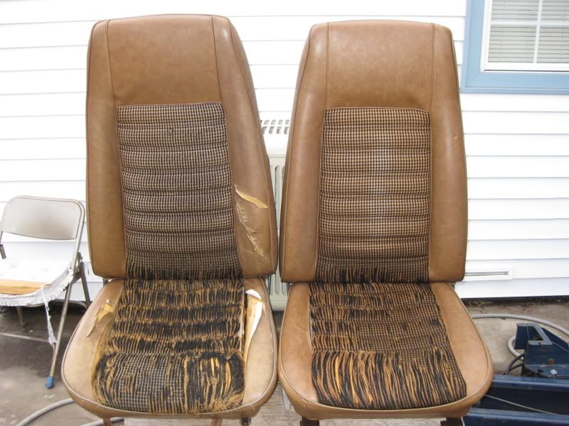

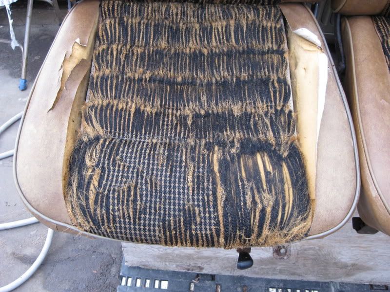

The seats that are in the Pinto now don't stink, they are just the wrong seats!! Here are the donor seats that stunk!! They were out of the yellow donor pinto. It was in a field for who knows how long.
They really arn't in to bad of condition! Nothing a seat cover wont hide!! LOL In fact, I think that is what kinda saved them in the first place. They had seat covers on them, although there wasn't much left to them! LOL
They are now in the drying stage. Once dry I will swap them with the red seats and cover them with the new seat covers!!

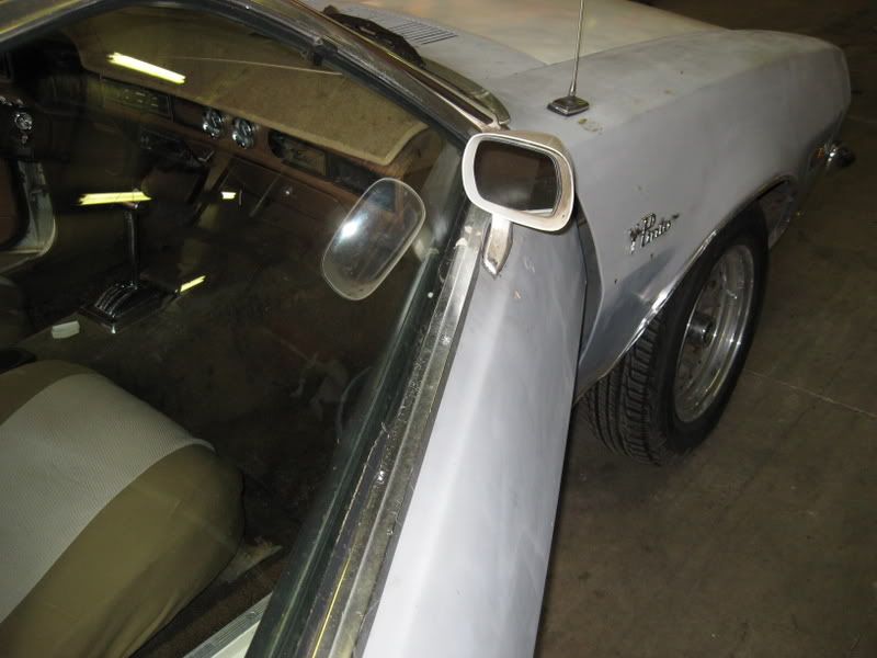

I also got my sport mirrors put on and fixed!!! That was a job in a  half. The passenger mirror had no nuts on the door. I had to reach up in there and ad washers and nut to the new bolts.!! I little secret or tip, LOL, I used a magnet on the mirror side of the door, to hold the washer on the inside, so I could reach up with the nuts!!! Worked really well!!!! :)

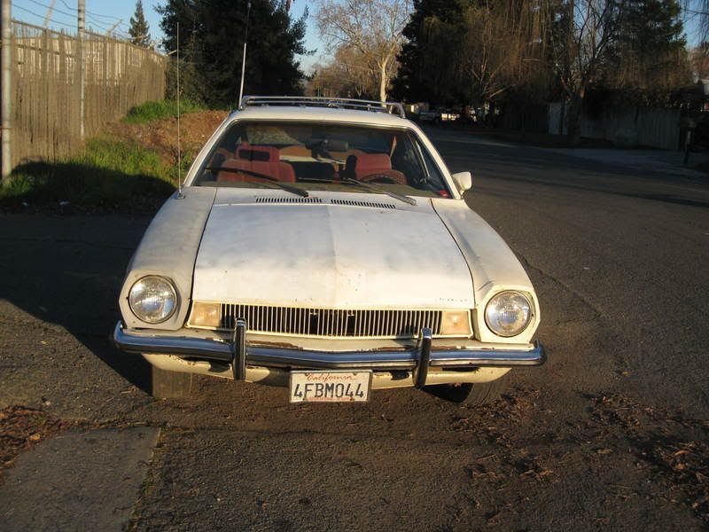

Well, I figured since I had my other 2 Pintos in the project area, I would ad my newest project. The Brown Ghost!!!
I named it the Brown Ghost because it was originally brown and somebody else painted it white, hence the ghost part of the name!! Someday waaaayyyyyy down the road, it will be brown again, hence keeping the "brown" in it's name!! LOL
I found this car while checking to see if the Pinto wagon I knew about was still on CL. It wasn't but this one was! LOL I found it on CL Sat. nite. Talked hubby into going to look at it on Sunday. We bought it and brought it home. The guy said it drove good, stopped good and ran good. He was right about one of them. I only got about 2 houses away from mine and the Pinto started making a clunking noise. We put it on the lift in the garage and found out the muffler was really loose and the drive line was hitting it. Fixed that and then found out that the front brakes were almost metal to metal. Fixed that too!! I also gave it a tune up. It runs about the same, LOL, but it does go good now, and stops good too!!
The body is in pretty good shape. The only thing I can really see wrong with it is it has a minor dent on the passenger fender. That fender and the passenger door are from a donor car, because they have been primered gray and they appear to have been green. The hood is also from a green donor car. They tried to rattle can the hood white, but did a lowsy job of it! I will try to find a closer match to the white of the rest of the car and paint the hood, door and fender. Just need a sunny day to do this! It had both of the sport side mirrors, but passenger side one is off the car and the holes that are in the door are pretty big, I will have to get nuts and bolts with washers to hold the mirror on the door. The driver side mirror had electrical tape rolled up to be double sided to suposedly hold it to the mount, LOL. Both screws are missing from the mount to mirror and the nuts too! The only thing holding it to the mount is the cable!

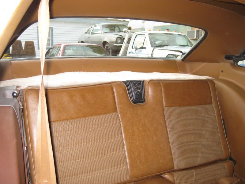

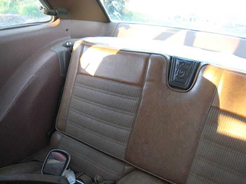

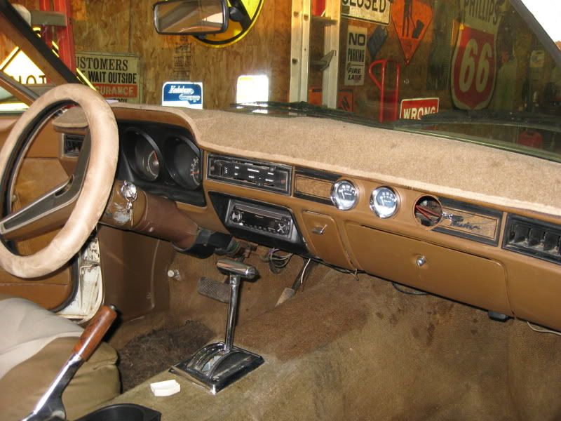

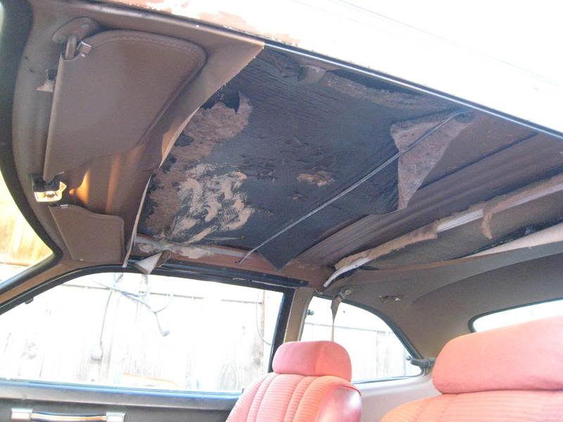

The interior is in need of some help. The middle section of the headliner is gone, the seat are red and out of a different car, as the po had to put holes in the floor board to mount them. The rear seat is ripped, but intact. The front floorboard carpet is pretty much gone, the padding is still good though. The passenger side carpet is on it's way to matching it's drivers side cousin!! LOL

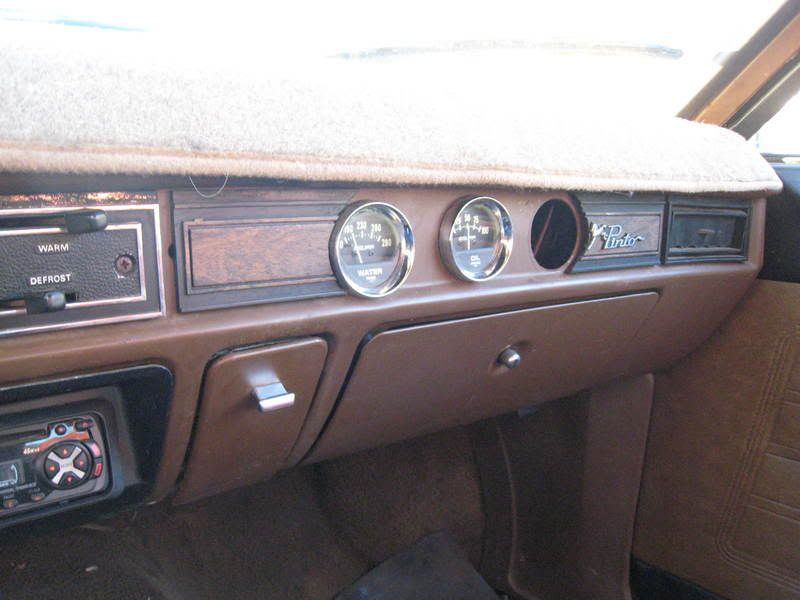

The PO cut holes in the dash to mount gauges. I'm not thrilled about that, but will leave it alone for now. I can always put my spare dash plate over the holes.
I found out today that the windshield leaks. It isn't to bad, looks like just in one spot. I don't plan on driving it in the rain, but if I do get caught in it, all I would need to do is put a small bowl to catch the drips!!! LOL I bought a window rubber for the Green Machine, and since I can't drive it (for now), I think I will use the rubber for the Ghost instead.
This car didn't have the original blue license plates on it. It has the newer white one's. I tried to get DMV to let me use the blue plates that came off of the yellow pinto, but they said no. You know what that means right??? Since I have to have newer plates, might as well order some personalzed ones!!!! LOL  I just ordered GO BOOOM tonight!!!!! LOL Now I have to wait 8 - 12 weeks to get them!!

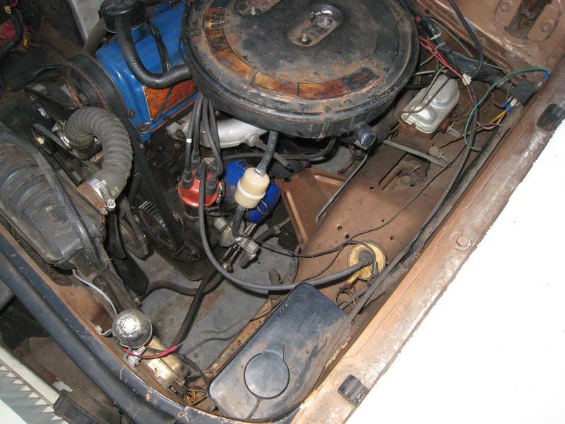

The PO removed the smog equipment. Luckily I have the stuff out of the yellow pinto!!!
Inside,

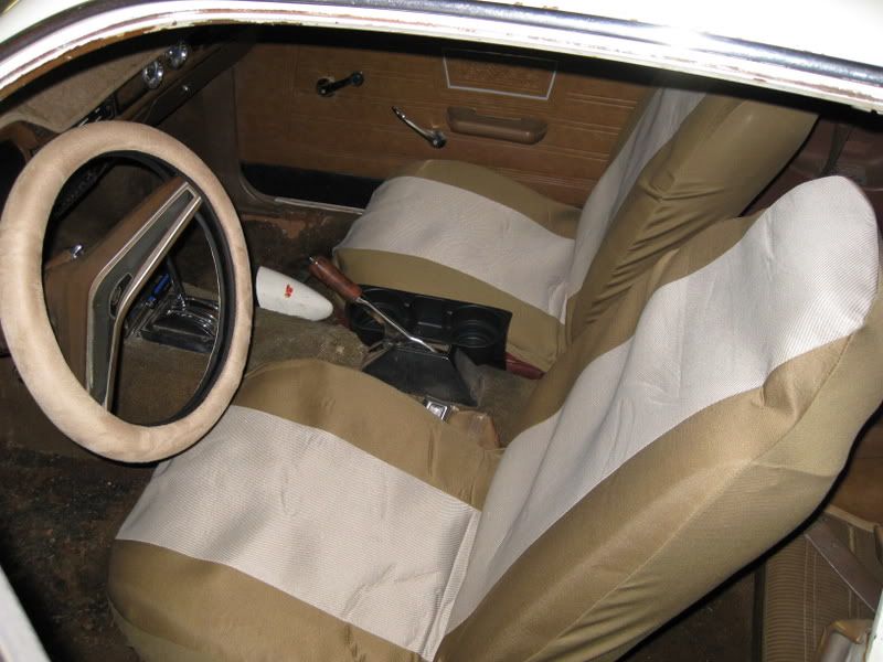

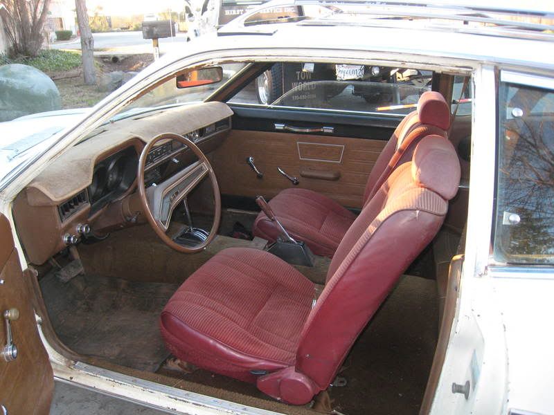

Now for an updated pic of the inside!! I went shopping today!! LOL Remember the red seats??? Now look!!!
Even bought a tree freshener to keep with the period, well ok, not to much though, I bought a purple one!! LOL Smells like lavender!!  ;D
I took the seats that came out of the yellow pinto outside and gave them a good soaking. I poured diluted Super Clean over them and scrubbed, then poured Dawn detergent over the twice and scrubbed again. Then I just hosed them down with hot water for quite a while. They are now in the process of drying, well kind of, they dry when it isn't raining! LOL I'm going to leave them out side in the rain for a couple of days. I'm hoping that will get any rat/cat pee smell out of them!! They actually don't smell bad at all, since the cleaning. Once they are dry I plan on putting the seat covers I bought for the red one seats. I will eventually have the pinto one's re upholstered, but this is the cheaper route right now!!!
