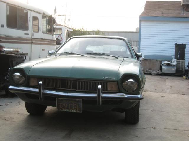

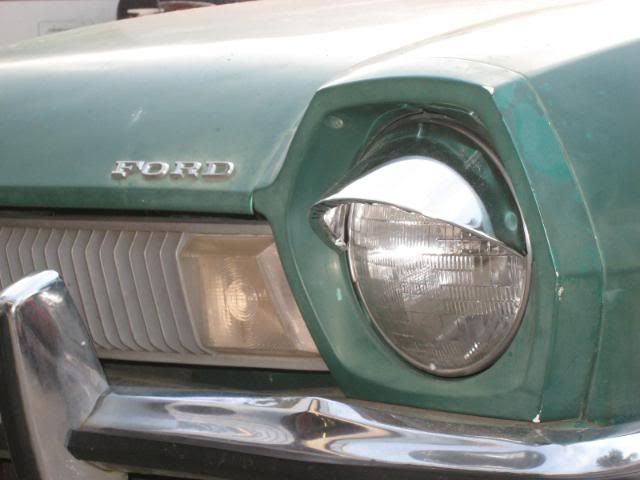

After that failed water test, the green machine went to the dentist!!! Check out it's grille!!!!! LOL
I am not to thrilled about the black (someone else sprayed it with black paint) but it has all of it's teeth!! I borrowed the grille from the brown car! When I find a good silver grille I will give the brown car it's black grille back!!

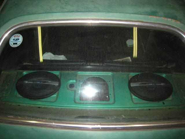

I also got the radio installed. Because I found a bezel that was already cut up, I decided to put a regular radio in the green machine!! I will save the stock radio and bezel though!!
I still need to make a package shelf, shelf! LOL But for now I will probably just cover the speakers with a towel or small blanket!

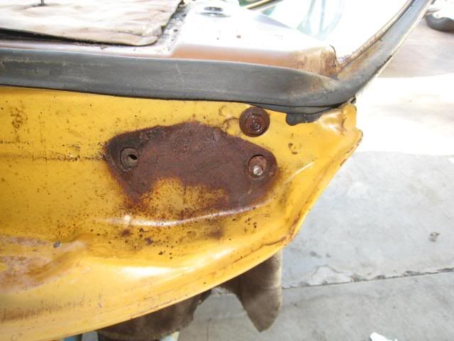

Well today I started out on the mission of R&Ring the driver front fender on the grey and yellow cars to do the swap. ( I will start a new project thread on that car later) Once the fender was off, I started to remove the door (yellow car). I tried to get the bolts out of the hinges at the body. After 3 broke, I gave up and went and looked at the Green Machine and realized with it's fender on, we wouldn't be able to get to the body bolts easily, so I went back to the yellow car and started removeing the door from the bolts on the door. That was working better. I started soaking the bolts in WD40 and slowly started working the bolts back and forth. I only broke one bolt!! Hubby worked on it and got the broken peice out for me!!
Hubby then took the door off of the Green Machine while I was working on putting the yellow fender on the grey car.
We switched out the door handle and lock so my key will still fit the new door (yellow door). Then we decided to pull the half way good gasket off of the green door and put it on the new yellow door, since that one was bad. Hubby then said that I should atleast paint the door jams black for now so it is not yellow on the inside. So I cleaned the door up, wire brushed the rust and then sprayed flat back on the jams and the inner part of the door!
This is where I had to stop for the day. We have to let the paint dry so we can mount the new door on the Green Machine. This will get rid of the bondo door!!
I think I will try to find some green paint to halfway match the car, and paint the outside skin of the door. That way it won't look funny being yellow!!! LOL
I will need to do the same thing with the passenger door, but that will have to wait a bit. Hubby decided he wants to strip the yellow car of all stuff we want to keep, so we can give the body to our neighbor and get it out of our way!!! Then I can start swapping again, and when I get the things I don't want off of my Green Machine, I can give them to him!!
