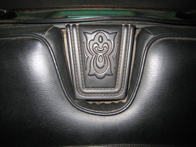

           I'm intrigued... on the backrest of the back seat of the Green Machine there's some rectangular thingy towards the top that looks embossed with a design. What is it and what's the design? My '72 had nothing like that.
Here is a closer pic of the object in question!!!

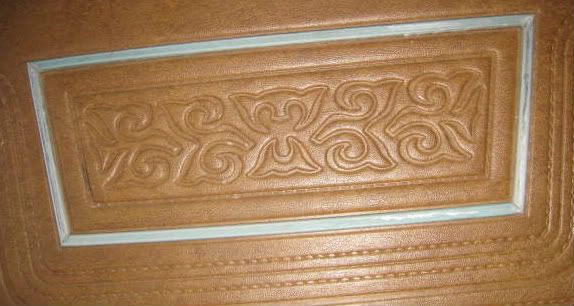

and here is a pic of a side door panel from my "Deluxe" trim 71 Pinto!
Looks pretty darn close doesn't it??
The green machine has a normal steering wheel so I don't think is had the deluxe trim. The rear seat does fold down, so I am wondering if that is just a feature for that type of fold down seats?
I couldn't  go look at the rear seat of the deluxe trim car I have, but I think it has the standard seat but has that same plastic center at the top! I can't confirm that though, just going on what little memory I have!! LOL I will try to confirm later. The car is covered and hubby has it buried with other cars!! LOL
Hopefully someone here with more Pinto experience can shed a light on this topic!!!!! :)
