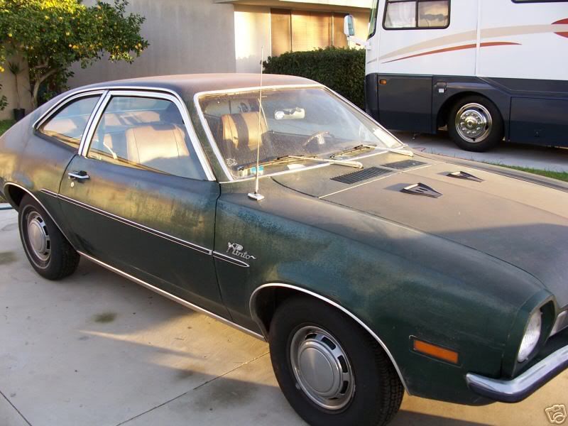

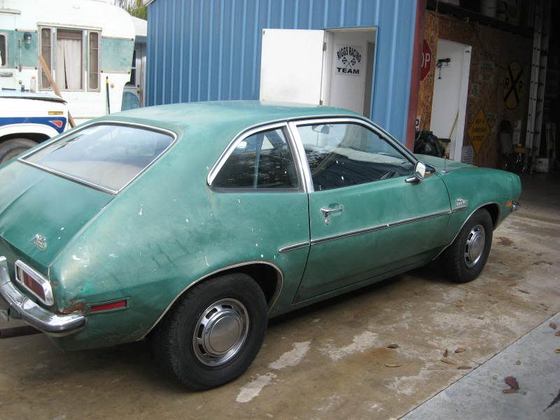

Here are a few pics of her a little after I got her!

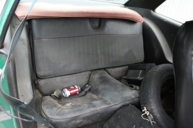

Here's a before shot of the back seat area.

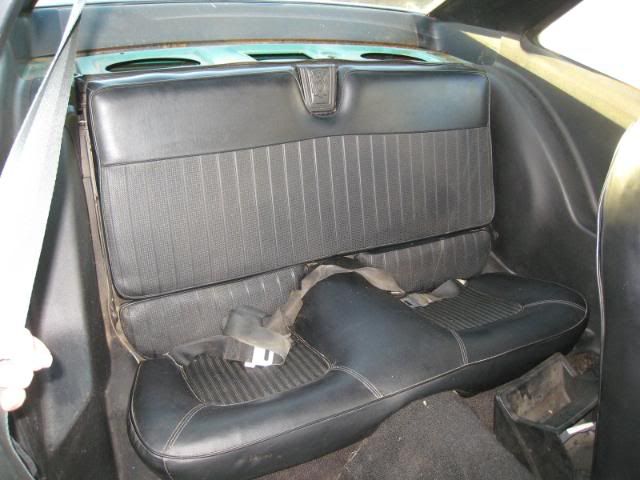

And an after cleaning it up! (sorry the flash kinda makes it look worse then it is!!
