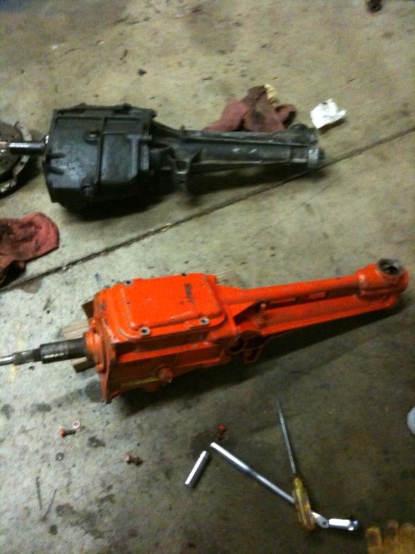

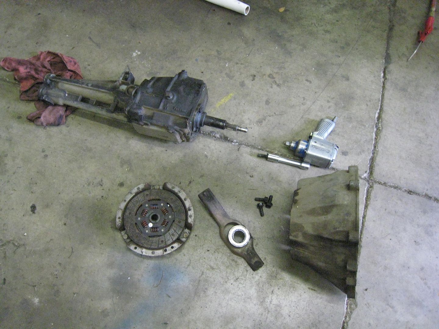

Ok, so we looked at the tranny and throw out bearings and all and it all looks ok, as far as we could tell. So we put it back in the car and the knock was still there.
Today hubby and I went to the post office in it. He figured we would stop by the tranny shop and see what he thought, on our way back. Well, the knock started to subside. So when we got closer to the tranny shop, we checked on the knock, and decided that we would just drive it for a while and see how things play out! Could be that since the tranny was re built in 1984 and then sat in a shed till 2009, it may have something to do with the knock. Maybe something had a bit of rust on it and with time it will get lubed more and more! If not, we will get another tranny! LOL

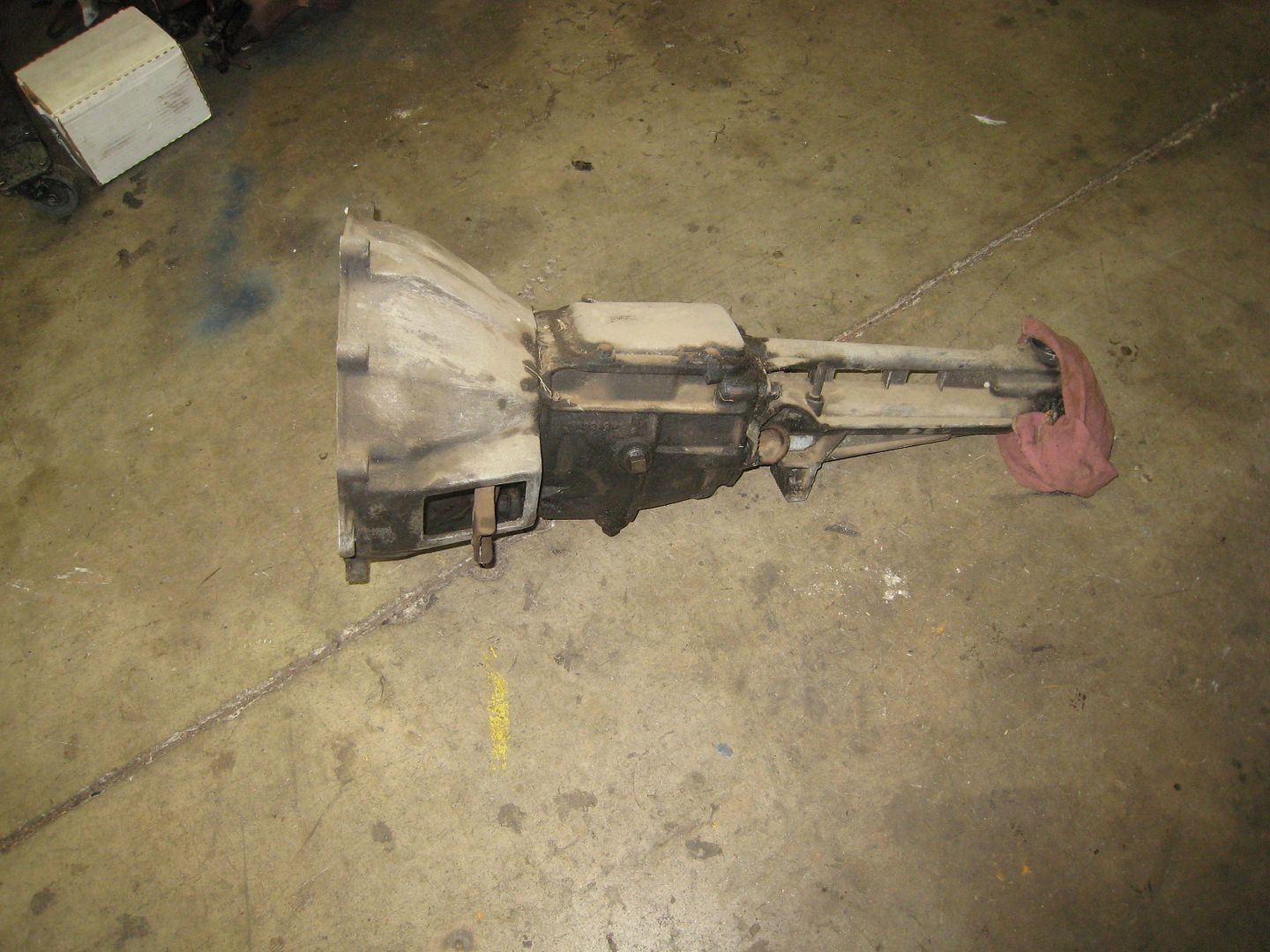

Got the new rebuilt in 1984 tranny! LOL Yep, that is when the guy (now dead) rebuilt this tranny! He put white grease on everything so all moved freely!
After painting it a flat black, we installed it and tested it out! The bad noise that the old tranny made is gone. BUT now there is a knocking noise!
Tonight we un installed, LOL, the new tranny and opened to top and didn't see any thing visibly wrong. So hubby is going to talk to the tranny guy tomorrow and see what he thinks it could be. If all else fails we will re install it and take it to the tranny guy so he can listen to it! Good thing it's not much of a job to put in and out!
It knocks when it is in gear, and when in neutral with the clutch out. Soon as a push the clutch in, the knock stops. Any guesses?
Well, today we pulled the tranny. Tomorrow hubby is going to get a new/rebuilt tranny and then hopefully we can re install tomorrow night!!

We ended up buying a new pilot bearing and a new universal joint. Other then that the clutch and all looks good!!

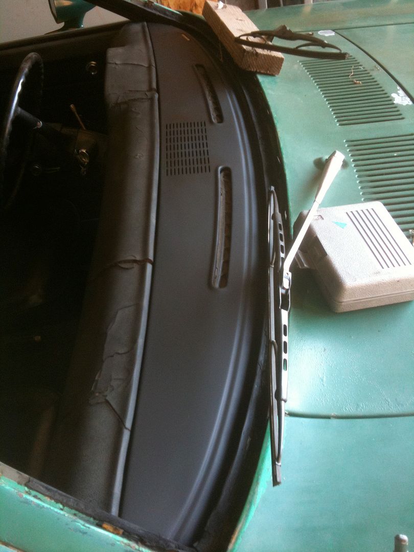

Ok, I finally got the Green Machine out of it's hole and was able to fix the lowsy paint job!! It looks alot better and by the time I put a dash pad on it, you will never see any flaws! LOL  ;D
Next is to install the windshield, which should be this Sat!! Then it is to fix the clutch issue!!!! Then I can drive it too!!! I already put the buss in it's old "hole" (parking spot) and the Ghost now resides under the carport which opened up a spot for the Green Machine, so I can get to it easy enough take it out when ever I want!!! Only thing with this set up, I will have to cover and tarp the Green Machine when it rains! Someday `down` the road hubby want to buy to more carports and put them in the back yard, for the cars that we want to drive once in a while. That way we won't have to tarp them if they are leakers!! LOL

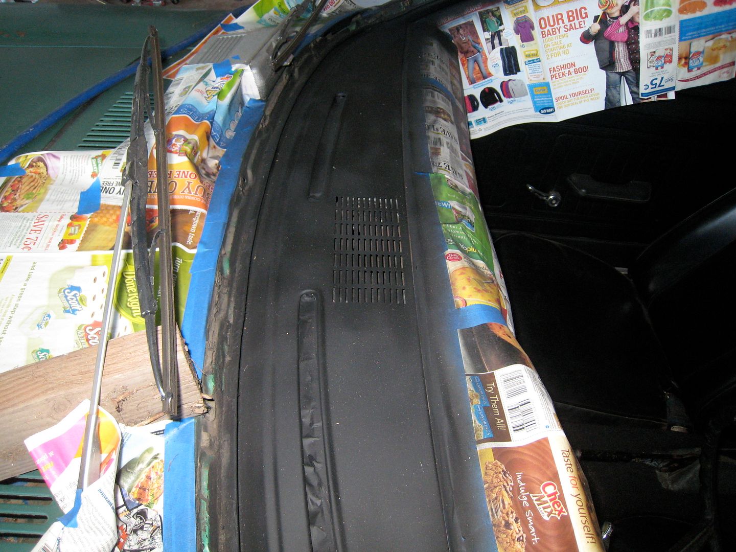

Well, I had just as much luck with the final paint, as I did with the primer. In fact I had to use the button off the primer can to get the paint can to work! I was so fustrated by the time I got the can to spray right that I didn't pay attention when I went to get out of the car, and I must have jiggled it to much and debri fell onto the just painted section of dash!
I can't really complain to much though. I really didn't have the car in the best spot for painting. I will wait til I can pull the car out from under the car port, then I will do a light sand and re spray!
Here is the final look. You can see it is very uneven!
This is an older pic, but it shows how the car is sitting when I was trying to paint! All I did was pull the car covers back and tried to shoot from inside the car, then get out and shoot the driver side from the outside. It's not the way to do it!! LOL
At least it is coated with paint and will not rust now! I hope to be able to get the windshield in before first rain, but if not, atleast the moister wont effect the dash anymore!!
