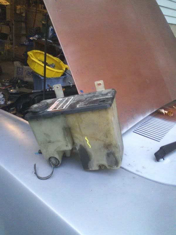

Also, I have been wanting to install a coolant recovery tank on my car, & while I was at a Ford Ranger found one that will work almost perfect & look original. It's a combo washer bottle/ coolant bottle & seems to be able to fit right in there after I move down the voltage regulator about an inch. Pic is of the bottle

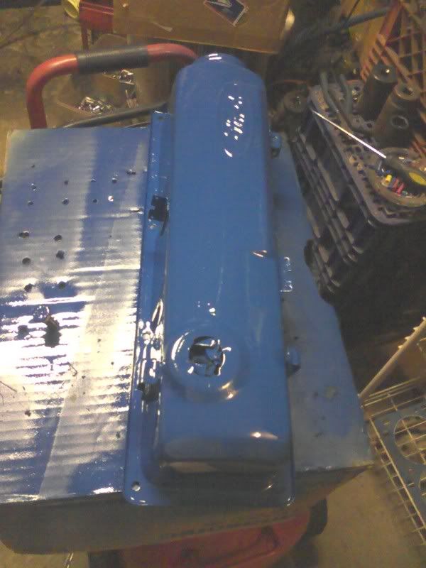

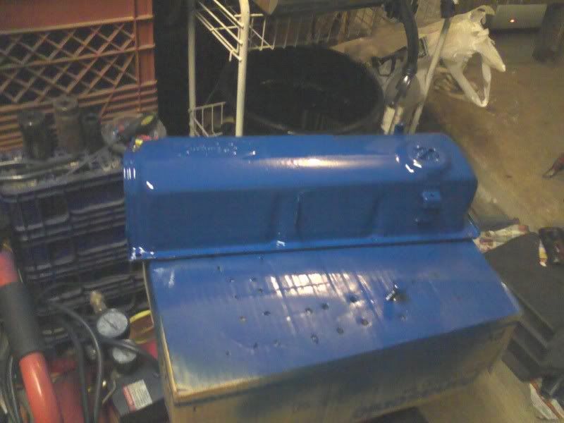

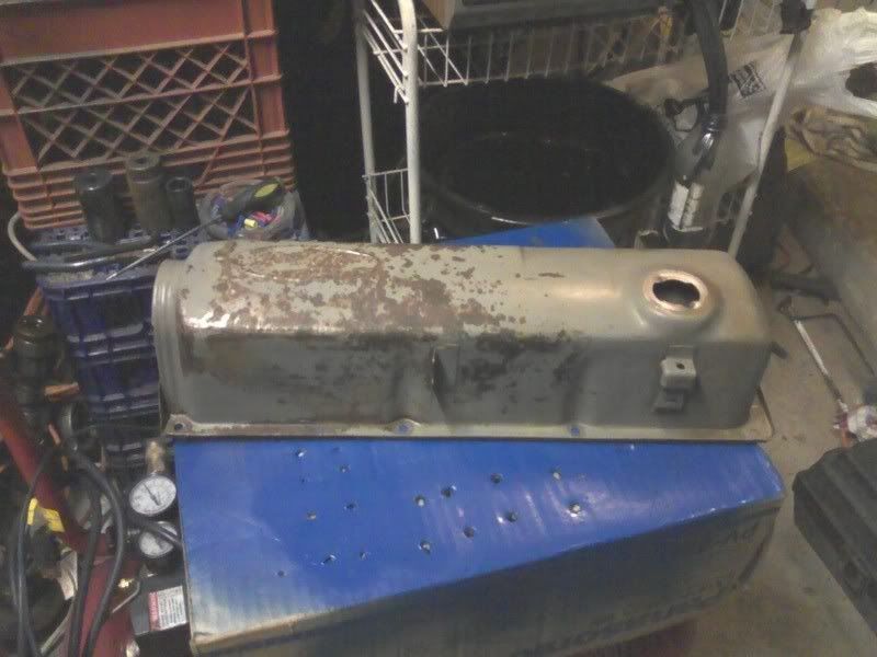

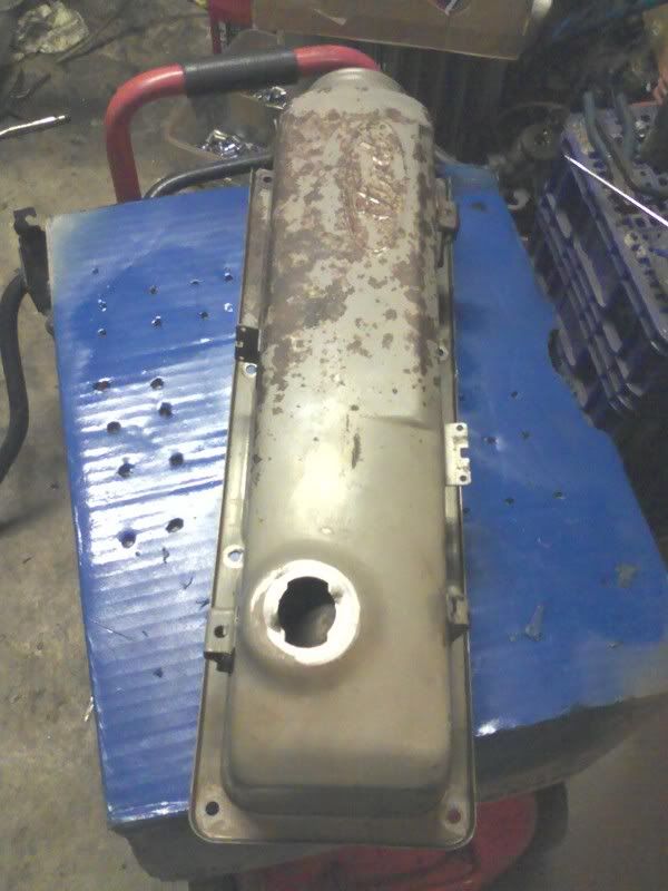

Well, I ended up having to get a new valve cover for the car since the old one was bent beyond repair. The gasket surface was all bumped up & also bent too much. Got some pics of the replacement cover after I degreased it & then painted it.
Before
After

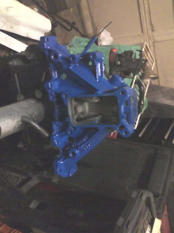

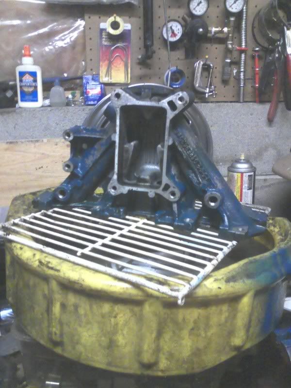

One more of my intake manifold painted up

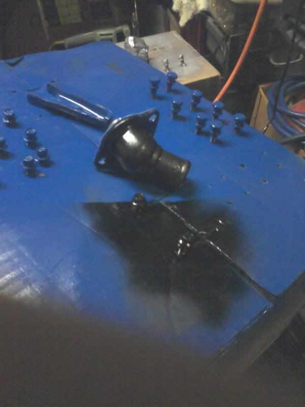

Thermostat Housing & bolts repainted

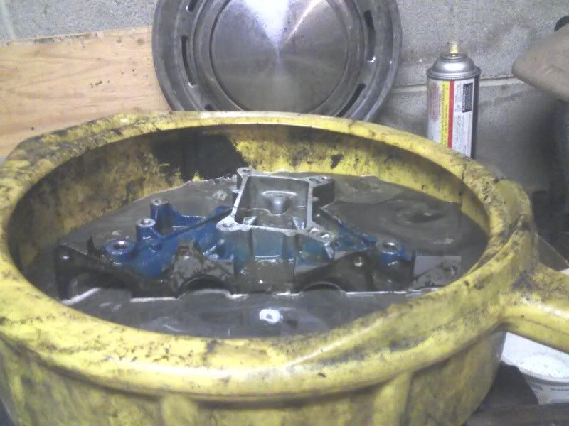

Intake manifold drying after cleaning. The blue paint is what's left of the original paint.

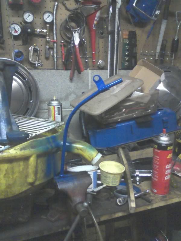

Dipstick tube repainted
Dipstick handle repainted.

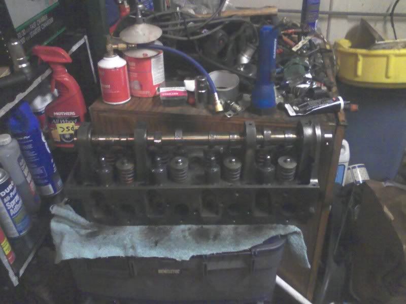

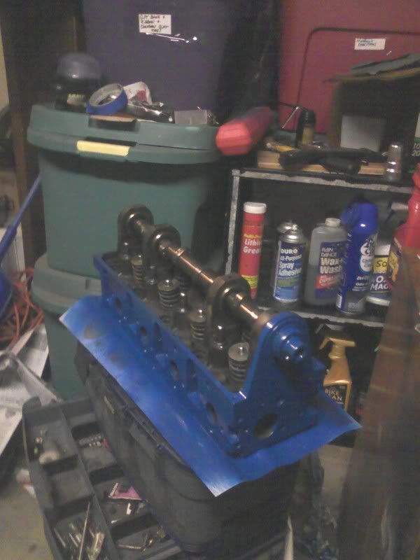

As promised, here are some pics of the progress of the head work.
The head after cleanup & roller cam installed
Cylinder head painted
Intake manifold, No that isn't black paint, but lots of grease

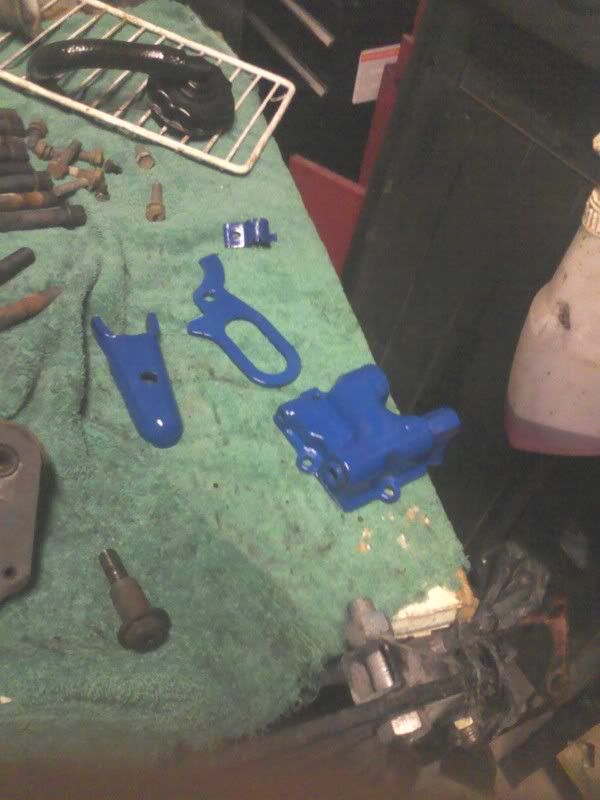

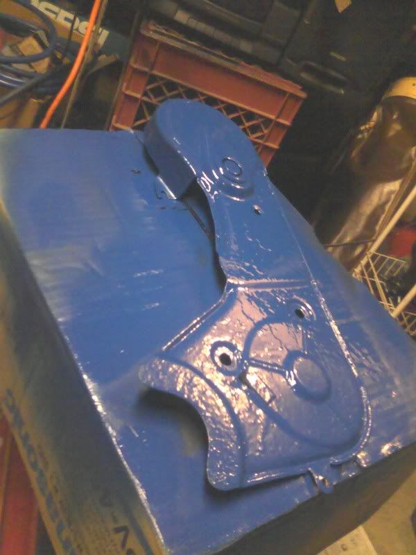

Distributor hold down, intake end piece, and engine bracket
Timing cover
Intake mainfold soaking in cleaner
Got the head cleaned up a bit today. I used a brass wheel & cleaned off the exhaust & intake gaskets surfaces so it'll be ready for paint tomorrow. I also took a wire brush to the combustion chamber & removed all the grime. After letting the valves soak for about a day or so I also cleaned the valves with a wire wheel to get rid of the deposits. Two of the valves were badly carboned up so I'm letting them soak over night to get all the carbon & sludge off. The valve seals were so worn out the engine was burning quite a bit of oil at startup. Tomorrow I'm gonna get the engine degreased, and also mask off the inside of the head so I can paint it back to the original Ford Blue. I was just gonna clean up the head, slap in the new cam & reinstall everything, but I figure since it's off I might as well make it all look nicer. Pics to come soon.
Well, I got the valve springs removed & found out the valve stems were gone. They wouldn't even hold the valve in place to remove the keepers. They were cracking as I removed them from the head. As for the valves there were actually a few that were stuck when I was removing the valve springs. I'm soaking the springs overnight to get them clean of any crud that is on them. Got them in butter bowels separated by cylinder so they go back where they came from.
