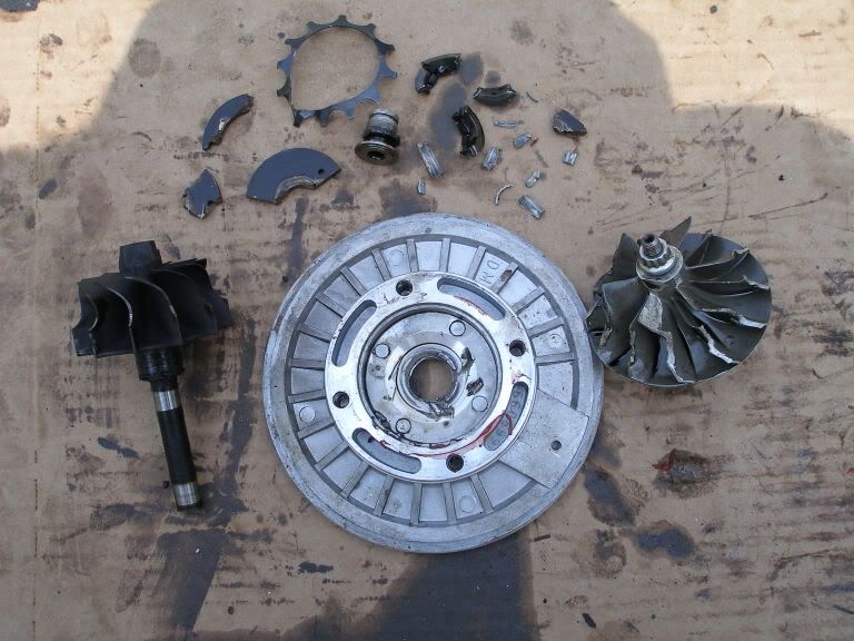

turbo toy
Yeah Bill,I literally exploded the turbo.It was a little costly,but it sure was fun.It even broke the compressor housing.How is Connie liking her car now that it has the turbo on it?We're building a Probe full tilt race car now with a 2.3 Pinto motor.This one is going to be running a BW 80 MM turbo at around 40 -45 pounds of boost and alky fired.I'm rebuilding the Pinto right now,but hope to have it back on the street in April.It should go 10's this time and still be a dependable daily driver.
Curtis: OUCH.
You put the "car" in carnage!
