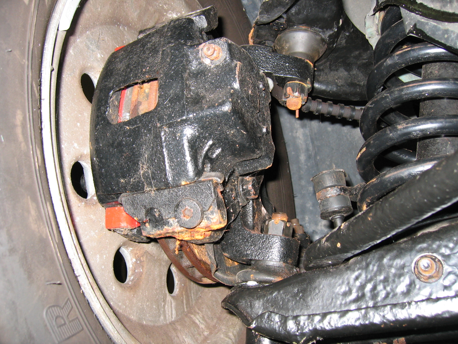

I just swapped the Hiedts(SP?) 2" drop spindles from the 79 to the 78.
Heres a pic of the 79 passenger side installed. The stock 13" wheels can be mounted backwards to clear without the calipers on. With the calipers on I had to use a 1/4" spacer. I had the 13s on to just move the car around.

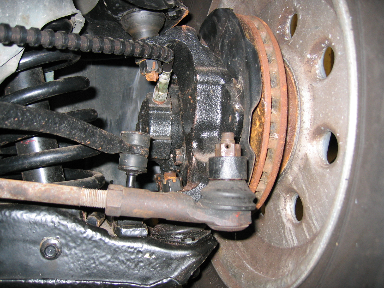

Here is a shot of the 78s drivers side put together. the wheel is a 3.5x15 draglite with a 1.5 backspace.
**A real big pic is here http://photos.imageevent.com/pandbz/78pintowagon/78%20pinto%20036.jpg**
The brake lines are pretty tight. I'm going to replace them with longer lines. The upper arm has to be ground down a little for clearence. Heidts describes this in the instructions they provide. Also if youre going to reuse the dust shields, they need new holes drilled for the mounting bolts. The spindles still limit how far down the suspension hangs. Shouldnt be a problem on the street. If I was pulling the front end up all the time (Like Jeffs going to be doing soon  :cheesy_p:) then I would be more concerned about the ball joint getting damaged. The tires are a little tall also. They are about 25" tall. They would sometimes rub if I was on the brakes and turning sharp with the stock hight suspension. They look like they are going to rub on the 78. They did rub the 79s inner fender. The firewall one, right where you put your feet when sitting inside. I used a big hammer to get enough clearence. For some reason the 78 doesnt look like it will be as bad.
Heres the caliper side.
Bigger pic here http://photos.imageevent.com/pandbz/78pintowagon/78%20pinto%20039.jpg
I'm still working on it. I need to swap the power rack for manual one from the 79. Thats why the cotter pins are not all in yet. Once the car is on the road and the mechanical bugs worked out, then I'll take it all apart and please the shiney police when its back together.  :coolrasta:

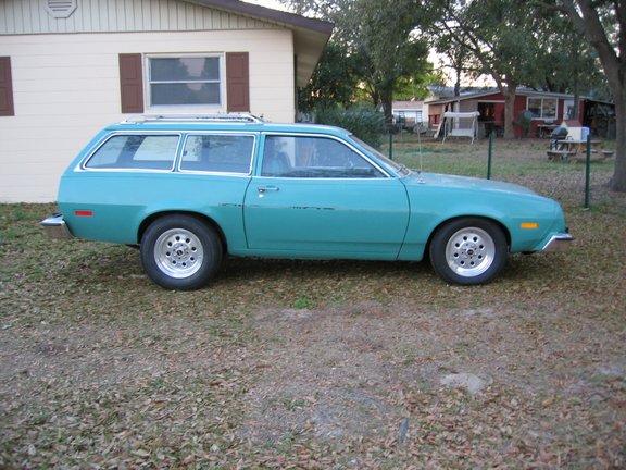

Now, as for the look of the lowered suspension........... the car sits at about stock hight with 15" wheels.
Bigger pic. http://photos.imageevent.com/pandbz/78pintowagon/78%20pinto%20031.jpg
The suspensions are only a couple years old. They have about 2500 towed miles one the 79. It had a 2.3 5speed with just the alt. on the engine. The 78 is a v6 auto with a/c, p/s, p/b and smog equipment.
