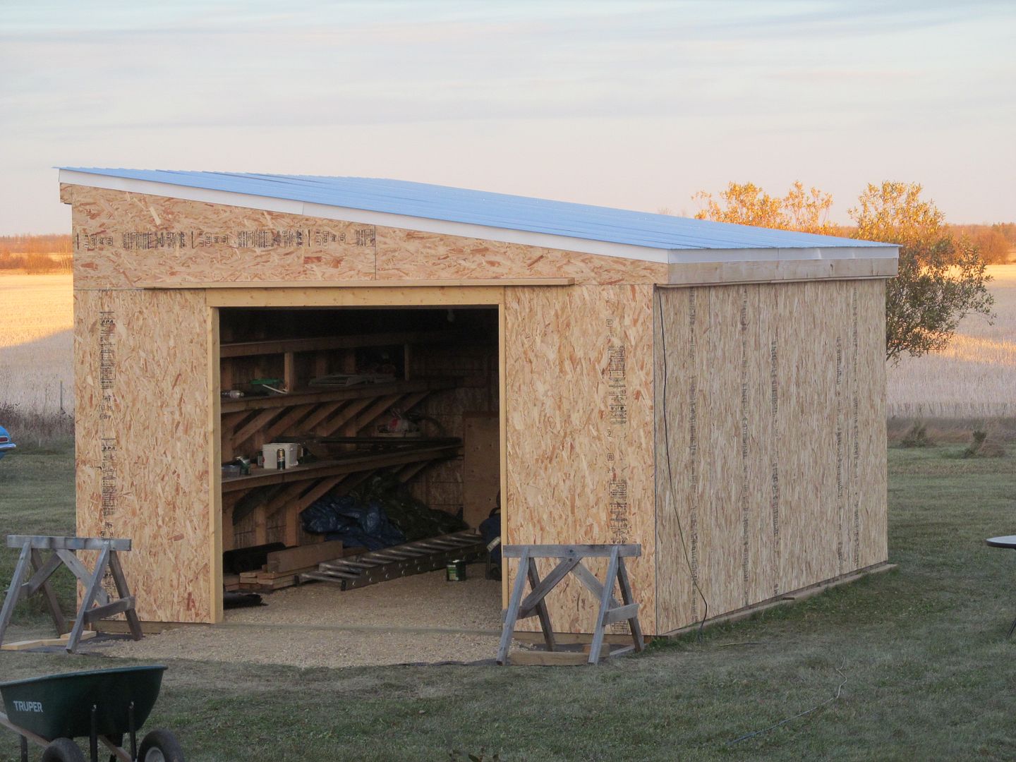

Ugly was stuffed into my new 20' x 15' storage barn for the winter.
