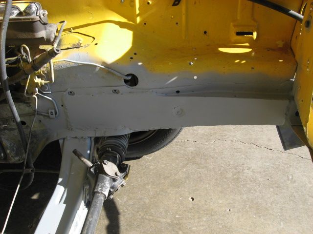

Primer is just to protect the metal from rust for now.
Engine compartment will be stripped/blasted in the future , after more metal work is done.
Next I'll be working on the inner fenders.....

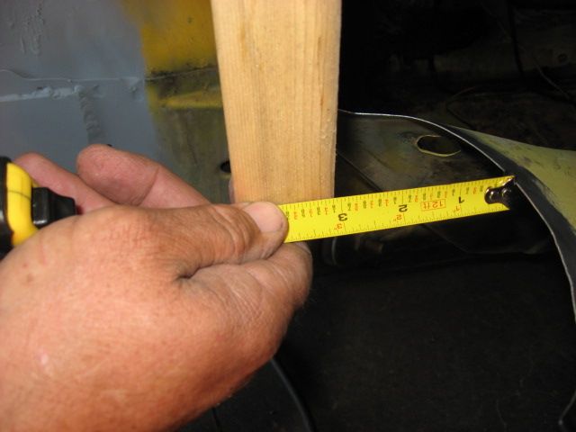

I took into account a 351w has a higher deck (302w is 8.2" and 351 9.5").
Some of the mods will be for the next owner ?
Brake line mods will be in the future as well......
Note I raised the bottom rad hose opening up (about) 1 1/8" - in case of a 351w in the future.
Note the wire harness hole has been moved up & to the left (right in picture). It will now clear the engine head/valve cover.

Going to move the brass brake distributor (?) up onto the inner fender, just in front of the master. Will also install a line lock. Also all new brake lines.......and all other brake parts.
New master was found & is on the way up from the USA.

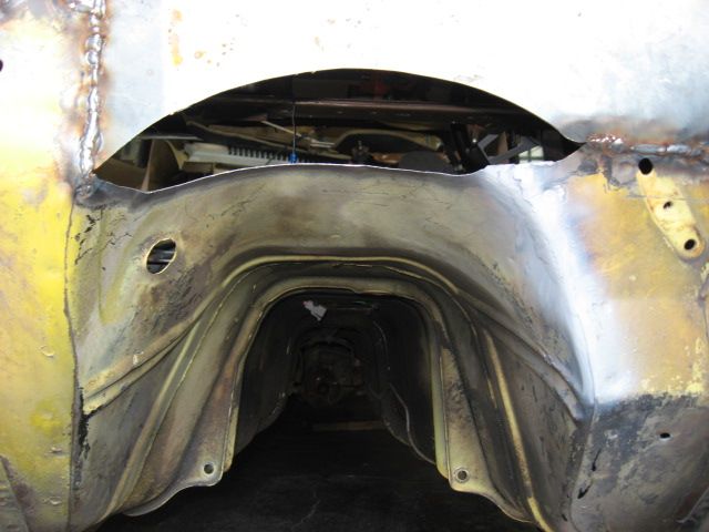

Some trim work to do yet. But it gives an "idea" on what to cut out to get the (V8) moved back as far as can be, without deleting the heater.
I will be able to move the engine back an inch farther than the B2P (BOSS 302 Pinto).
I already have the piece made for the top part. Pics later.
Picked up a tank of gas & a 10lb spool of wire for the mig.
Never welded like that before.....
Next I'll tackle the fire wall. (and that hole through the inner fender by battery)
Made some changes as well.
Moved the 2 1/2" hole for the wire harness up and to the left.
Going to move the bottom heater hose hole up & over as well.
I will also be installing a 90 degree fitting in the 2 heater hoses at the fire wall.
Hoses do not bend sharp enough.
I'll be running them sharp right, against the fire wall, along the inner fender, behind the battery (you can see where I trimmed out some of the welded on part for more clearance). Then back to the engines front right.
Weld, grind, sand blast & prime.
