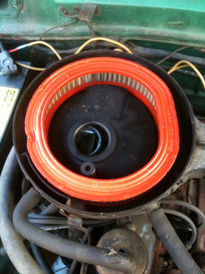

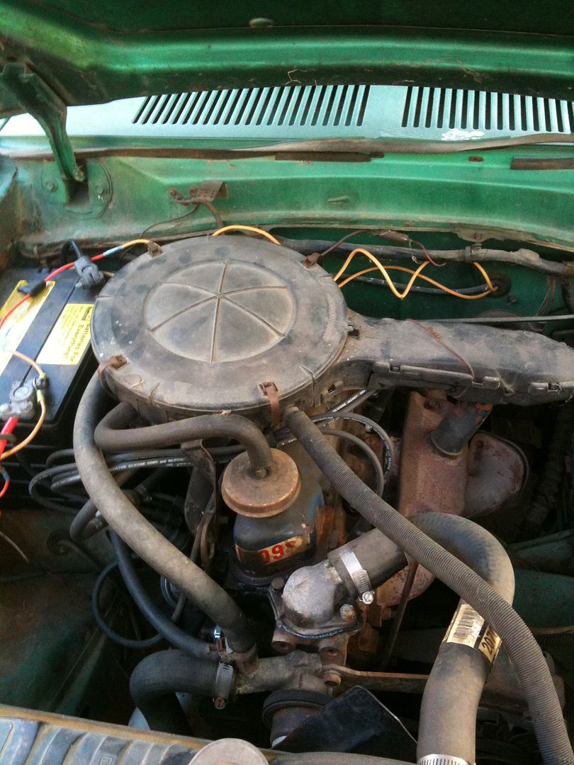

First of all, here is a link to your air filter!!  http://www.napaonline.com/Search/Detail.aspx?A=FIL2072_0195105822&An=599001+101971+50026+2026028
Second, I went out and looked at my car and took some pics!! I have no extra tube in my filter either!
Here it is with everything together.
One with lid off! It is actually off the carb a tad in the pic!
Now, back to the link above, do you have a Napa close to you? I don't know what shipping is but you could probably buy it online. If not and you can't find one before Knots, let me know and I will go to my Napa and get one for you!

I suppose it's a moot point since you removed the hose, but I looked at mine today and there is nothing like that in there!  I WAS pleased, however to find a brand new air filter... presumably installed just before I drove it home from Maryland.  Just thought I'd let you know!

OK today I pulled off the air ciuu for your imput.leaner top and pulled that tubing thing off. It appears there's a rubber hose glued into where the PCV should've gone, and the PCV is at the end of that hose. For the record it does rattle. lol. Also, you can see how filthy the air cleaner filter and the breather element (?) filter are! Why can't I find the $#%^&* filter!?! lol. I'll consult my DIY manual on carb adjustment. Thank you for your imput guys! ;D
