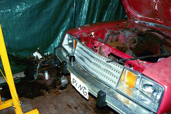

The engine and trans are a little hard to see on the ground.
I plan on getting a lot done next week when its supposed to warm up to the low 30s.

I dont have the sandblaster yet. It should be here Monday or Tuesday. I also dont have any cleaning solution in the parts washer. So I decided to pull the engine and trans. I had to go buy an engine hoist. Lucky there was a folding one I got for a good price close by. Now I dont have to rent one. Its going to save me a lot of hassles.
The engine and trans came out smoothly. Im starting to jump ahead of the schedule. Its that or risk not being done on time. I know the new wire harness is going to take a while. One good thing is it looks like I wont have to replace all the hard brake lines. Also every thing looks pretty solid. Not much rust.
