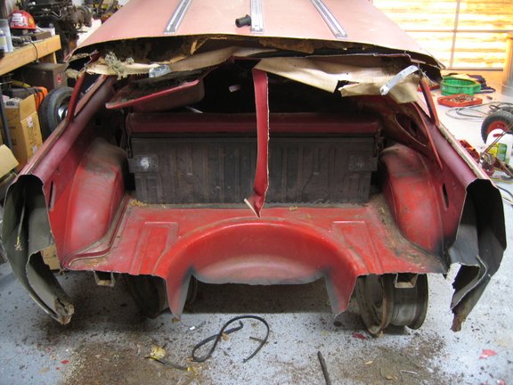

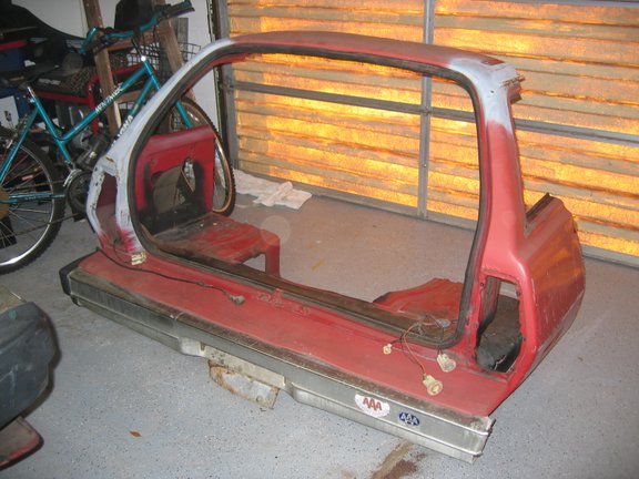

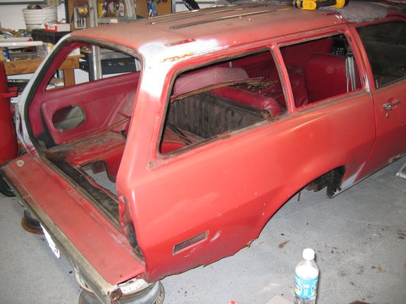

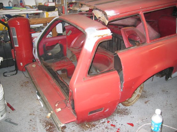

Today will be a fun day.   :lol: I'm going to cut the rear off the wagon.
A few of you might remember back a couple years when The idea of replacing the wagons tail lights with 93ish Escort wagon tail lights was floating around.
I still want to try it out but, I'm nervous I might not like them and will have ruined the 78s rear. I need the space the 79 is taking in the garage. So, Ive decided to keep just the last 18" or so of the rear. I can do the swap on it and throw it away when I'm done. I also think it would look cool hanging on the wall. :drunk:

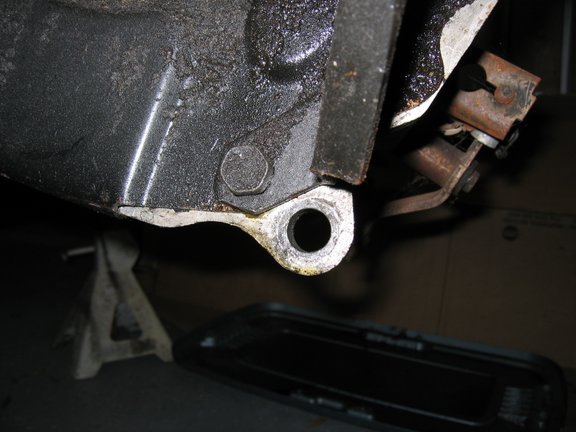

Doesn't look like the hole can be moved much because of the brace.
If you haven't already read the T-5 swap thread, then you might want to know that:
"The D9 bell (4spd.) will bolt to a t-5 and will keep you from having to notch the crossmember.
Bill"

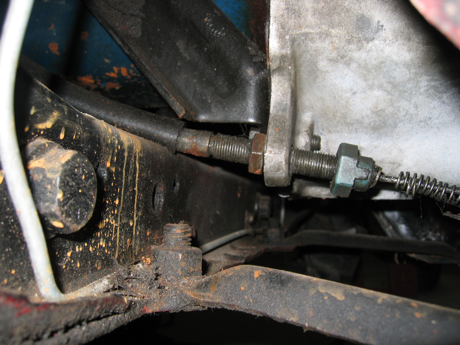

Ill have to look at it and see. I have read about a few guys elongating the hole. Ive also heard of a few running it like it is. Theres been a couple  who are running with a notched crossmember with no bracing.
Gaslight
Thanks for the pic.  I will keep this in mind.  Is there any room to shorten the mount of the bellhousing and weld it back on?

When swapping in the T-5 with a mechanical clutch, the cable hits the crossmember. Here is a pic of my 79 wagon with an 88 Turbo coupe 2.3 and T-5 with a I dont know what year mech. clutch bell, fork and cable. It also uses the "dogbone" cable. I'm thinking about replacing that with threaded rod and nuts.
FOR A REALLY BIG PIC. CLICK HERE-->http://photos.imageevent.com/pandbz/78pintowagon/78%20pinto%20004.jpg
This picture was taken right before the engine and trans. were removed. the plastic nut is loosened almost all the way.
I'm going to notch the crossmember on the 78 and reinforce it somehow. ???

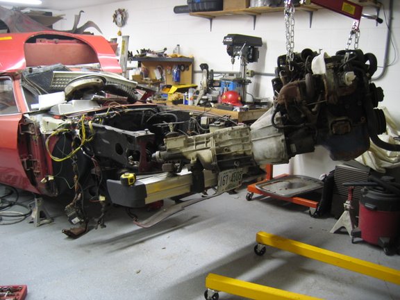

Getting closer to gutting this one.
The rack is out also. Next will be the master cylinder, throttle cable and clutch, brake assembly.
I need to get this done since I just lost first gear in the SVO tonight. :accident: :hypno:

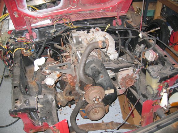

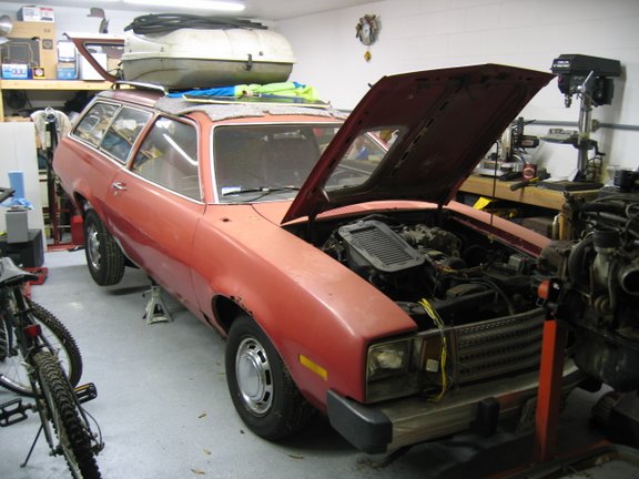

I'm glad youre getting another Pinto. I havent taken the 78 engine bay album down yet because its getting hits still.
The starter on the 78 is oil soaked or just plain worn out. I was going to drive the 78 for a while but Ive decided if I was going to swap starters I might as well just swap engines. I'm shooting to have it back on the road by May, 2006. I'm already fighting the urges to strip paint and detail.

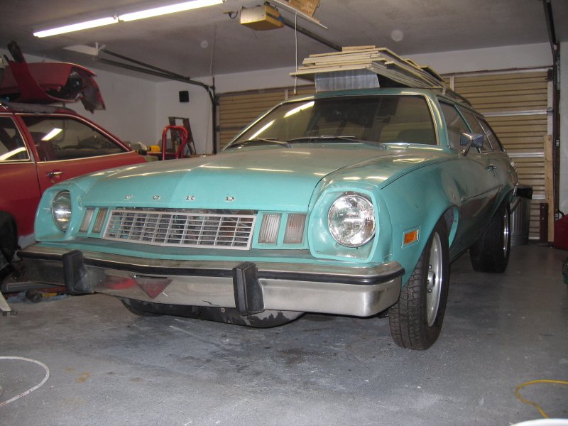

Heres a pic of the 78 as of last night.
It should be on all fours today,

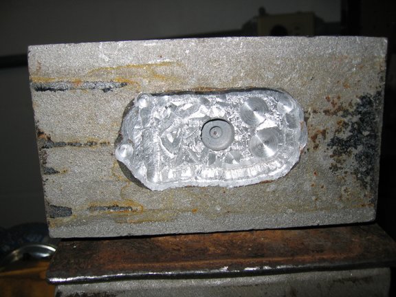

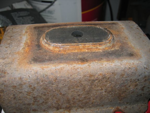

This is what I came up with.
I didnt like how much slop the block had at the top. I cut the sides off of the brackets from the 79 wagon and enlarged the hole on the bottom of the blocks.
A shot during the hole reshaping.
I had to cut the rubber bushings flush with the top of the tit.
I have to get longer u-bolts. Before I can go further.
Your way sounds easier. I did my 76 wagon like that with 2" blocks ment for a *GASP* Chevy truck. The blocks were not solid like the RW blocks and were easy to make work. I would have to grind out yhe bottom of the blocks to fit the oval tit. Still would be easier than the RW way, I think.
Hello Glassman,
The roundy round guys could care less if their car squeaks a bit.
I ordered a set of those blocks from R.W. 20 years ago. I had to modify them to fit the early Pinto pearch that used a round tit instead of the oval tit on the later Pinto.
I installed them the way you have and the squeak was awful.
I was so imbarrased at Street Machine Nationals putt-ing around the fairgrounds in 1987.
I used an extra 1/2 tank of gas just reving my engine to cover the SQUEAKS. ;D
After I got home i re-installed the rubber  and put the block on top of the plate.
Maybe you will have better luck?

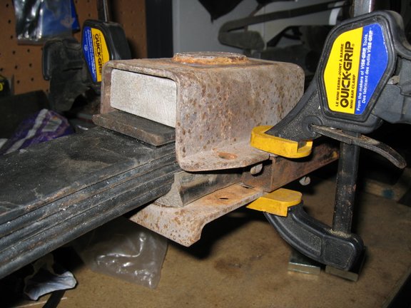

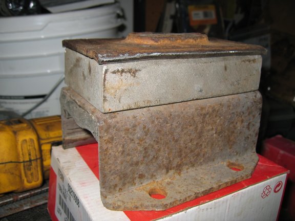

I should've noted the spring was upside down. I was just using it for the mock up to measure the gap. I was posting as my wife was calling me to eat dinner. I had to make it quick.  Heres a pic. of the way it was together in the 79.

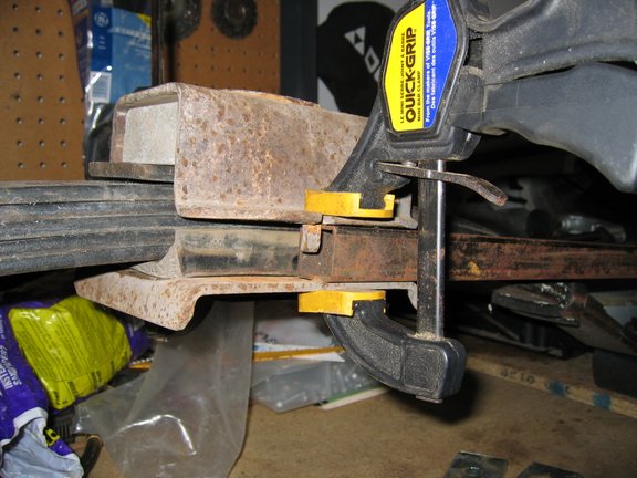

The lowering blocks are actually roundy round racing lowering blocks from Walsh. They dont have the discription on the site. http://www.racerwalsh.com/product/RWA2230 The old catalog I have says the blocks replace the rubber bushings at the leaf spring/U bolt mount. BY removing the rubber bushings, spring wind up and axle hop is reduced.  I'm going to leave the bottom bushings in this time.
The blocks fit very tightly in the mount. I have to grind them to fit. I'm going to use super hard plastic shims between the block and leaf springs. They are 1/16" thick. I'll weld the 1"x1" tube to the shock mount bracket and put the square hole in that so the upper and lower mounts fit together like stock.
I also noticed you have the spring upside down. Unless you just usin it to show for the photo.
Hello Glassman.
That does not look right.
the spacer is supposed to go on top of the top plate not in with the springs.
Your Pinto is going to SQUEAK horibally of you do not use the rubber.

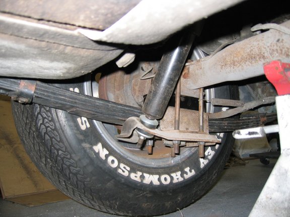

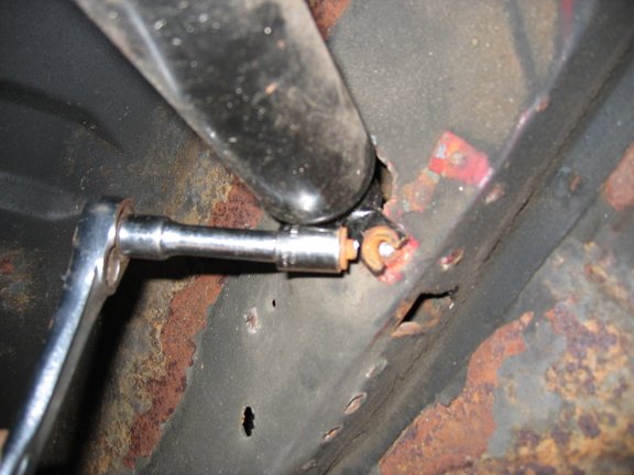

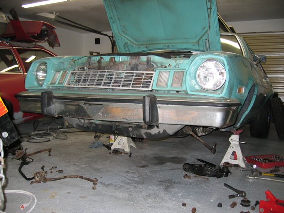

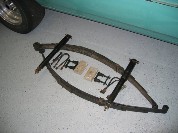

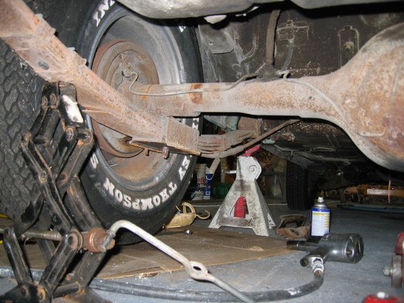

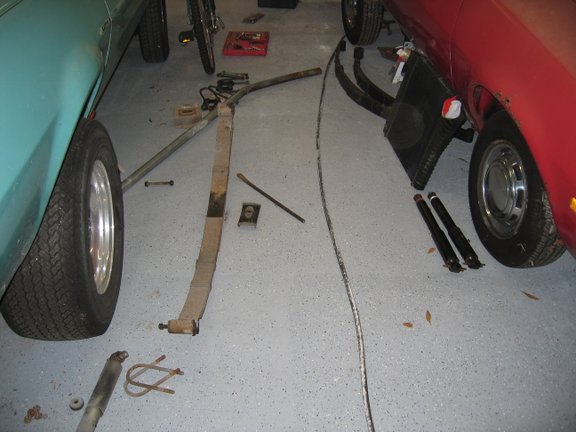

The garage isn't organized and most of my stuff and tools are still in boxes. I couldn't wait any longer and removed the leaf springs, shocks, and lowering blocks from the 79 Pinto to be swapped onto the 78.
Heres the 79 on jack stands and ready to come apart.
The first bolt I went to remove, broke. ::)
The parts removed.
Its the 78s turn now. Here is the drivers side.
Once the parts are swapped, the brakes will be next. The front suspension, steering and brakes go after that. ;D
