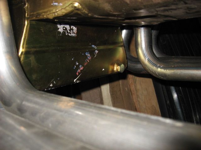

Had a set of front mounts bolted to a 351w (mock up engine for test fitting).
Sitting there having a refreshment , thought: looks like if I take the one from the front left, it should work on the back right.
I'll (one day) drop the engine in the car to see where they match up with the frame rail.
If it fits OK, will be a good way to mount the engine.
I held a set of Headman Headers up to the ports. Fits OK.

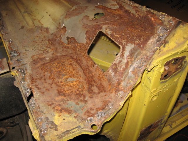

Had some spare time , so using my spot weld bit, I drilled out nearly 100 spot welds and two bead welds.
I knew there were more rust issues. Didn't know there are three rust through spots.
All fixable though.
The heater funnel will be removed & a plate welded in : this car will get a small, light electric heater.

I had test fit the front mounts and (other) Headers in my white car. Worked OK.
These next pictures show they are too high, and the pan is sitting on the rack.

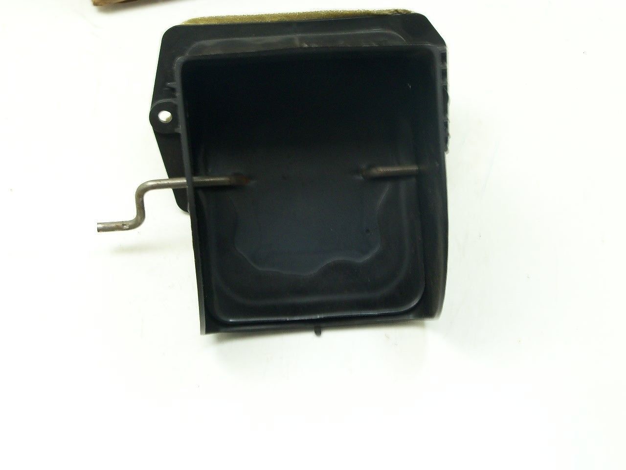

NOS 1972-79 Pinto Bobcat Cowl Vent Air Outlet Duct Passenger Side - got it for $25.00
