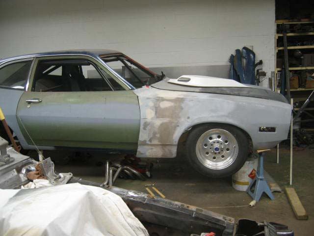

Tinkerman:  Yes 8" was added to the front end.  Before the teardrop I had a Boss 429 hood scope on the car, but with the engine setback it looked out of place.  The teardrop being a lot longer helps camouflage the lengthened front end.  The welds were done by a friend, he is an electrician by trade.  Obviously he is very good at welding, but doesn't do it for a living.  The welding machine we used is a Hobart Handler 180 wire machine ($600 at Tractor Supply), nothing exotic.
Fozzy:  Yes the TH400 in the pictures was mated to the SBF I had in the car.  It is not a standard TH400 though.  It is actually a clutch turbo.  The front of it has been cut off, and it uses a clutch instead of a torque converter.  In the picture it has a SBF Lakewood scatter shield on the front.  It uses a 3 finger long style clutch.  A special bronze spider engages the clutch fingers and drives the front pump in the transmission.  The clutch is only used to leave a stop, it is not used when shifting.  I no longer have the clutch turbo in the car.  I replaced it with a more normal TH400 with a JW Ultrabell, and a 9.5" torque converter.

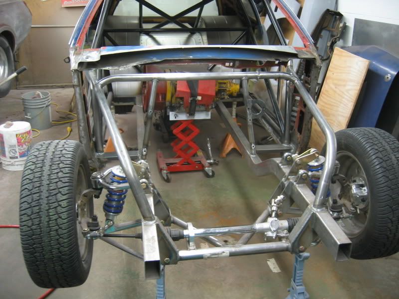

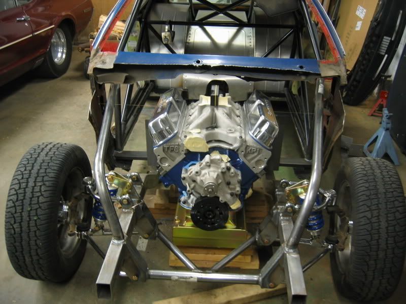

Your right I didn't post any side shots in this thread.  Even when I have in the past most people haven't noticed.  If I remember right the parts I bought from Chris Alston were around $2000 with shipping (frame kit, upper and lower a-arms, ball joints, aluminum firewall, floor, and trans tunnel.  Another $1000 for Koni coil overs, and Wilwood brakes.  By reusing a stock rack and spindles that would get you a basic roller.  All the small misc parts add up fast though, pedal assembly, master cylinders, aluminum radiator, fan, header kit, grade 8 hardware, tabs, brackets, wiring, connectors, etc.

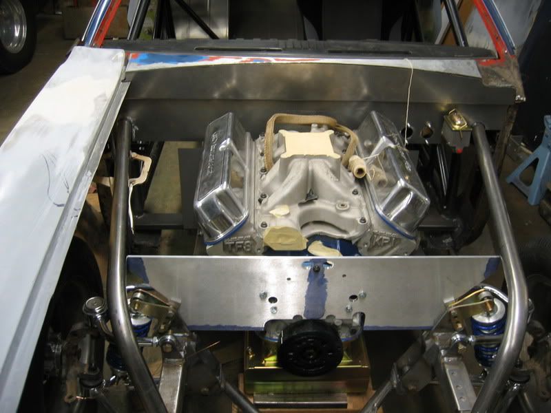

Fozzy: One nice thing about the tube front clip is it makes headers easy.  Stahl makes a nice pro gas kit with all the tubes are pre-bent.  All you have to do is cut them to length at the header flange and collector end, and weld.

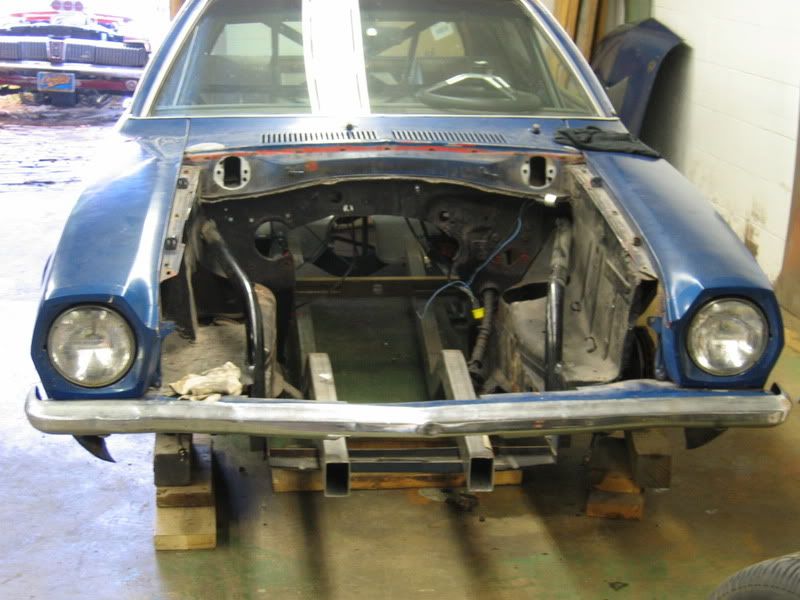

Yes, it creates a full frame.  As you can see in the pictures I posted, I cut the cowl out of my car and moved the firewall back 8 inches.  What most people don't notice is that the wheel base has been altered also.  A 71 Pinto comes from Ford with a 94" wheelbase,  my car is now 102".  The nice thing about my changes and the Chris Alston frame is there is no cross member under the oil pan.  I could pull the pan and check bearings without removing the engine from the car.  I only ran 350 pound front springs with 408W in the pictures, and 90 pound rear springs.

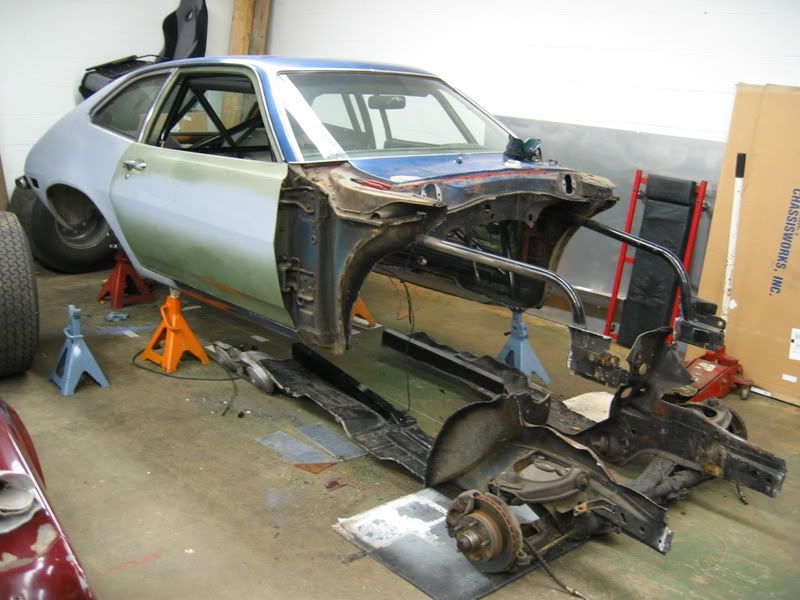

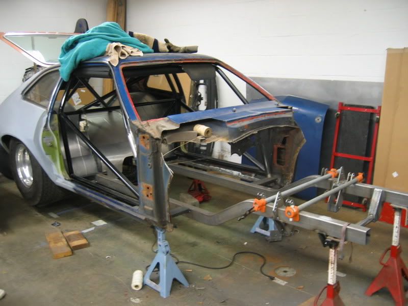

    The Chris Alston Chassis Works parts are very nice.  I have them in my car.  Me and a friend did mine 5 or 6 years ago.  We just worked on it on weekends.  It took 6 weeks from the time we rolled it into the garage until it was sitting back on the ground with the new clip and suspension.  It took a further 9 months to do all the small details: seat mounts, belt mounts, pedal mounts, mounting fenders, grill, radiator, bumper, etc.  It is definitely a big project.
    Here are some pictures of the process.  If you have any other questions just ask.
