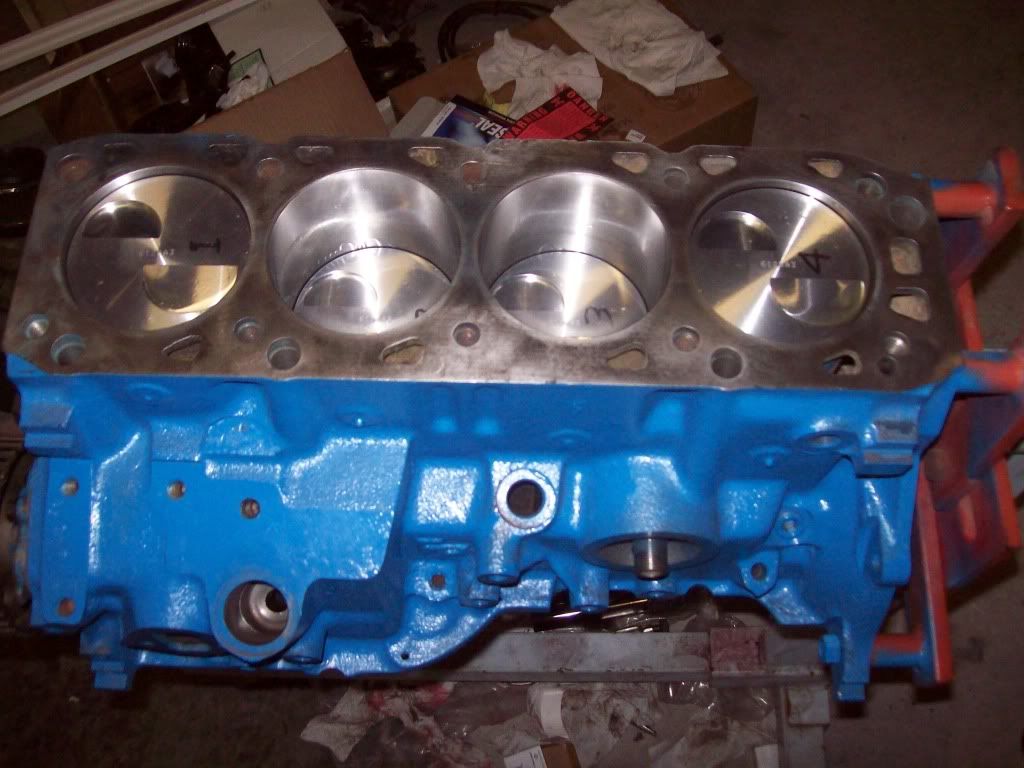

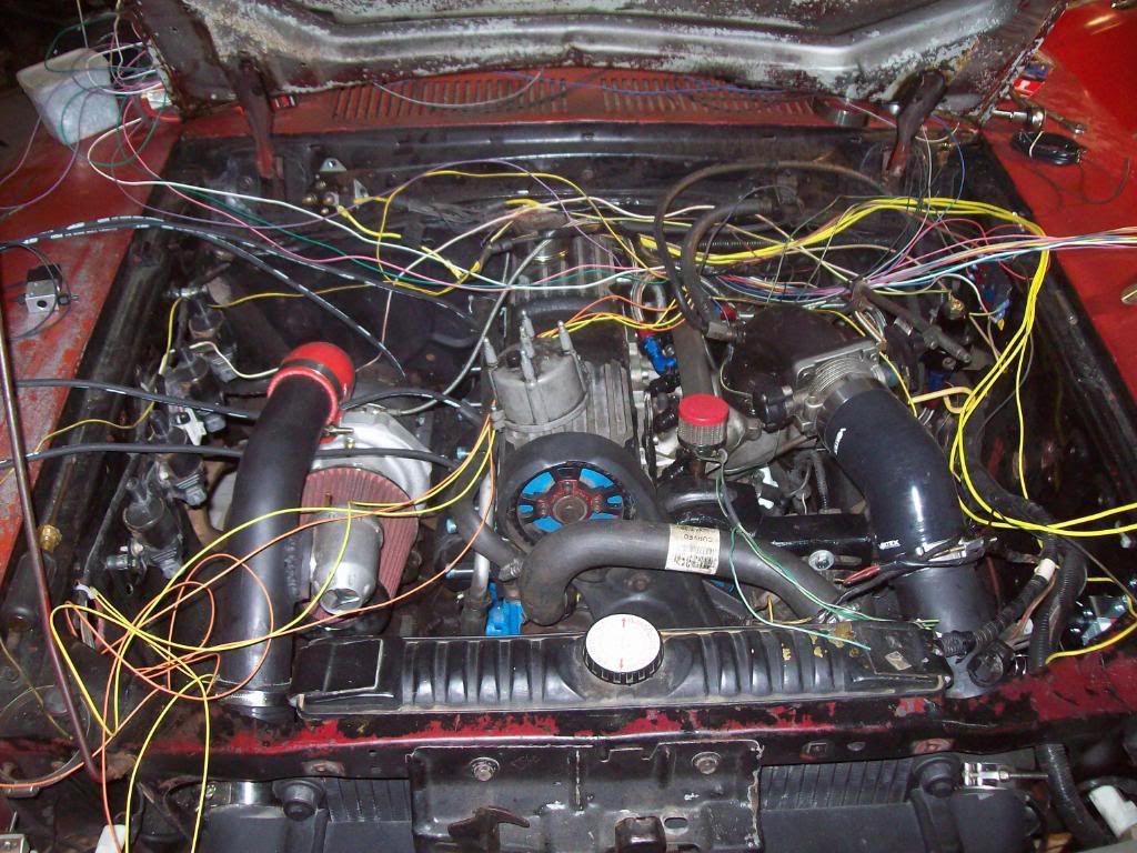

thats  beautiful LOL man i still love that turbo
lots of upgrading going on...... should be running in the next week or so...

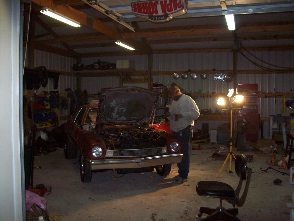

sam has been working his butt off on the wiring and ms2 thats him in the mess....

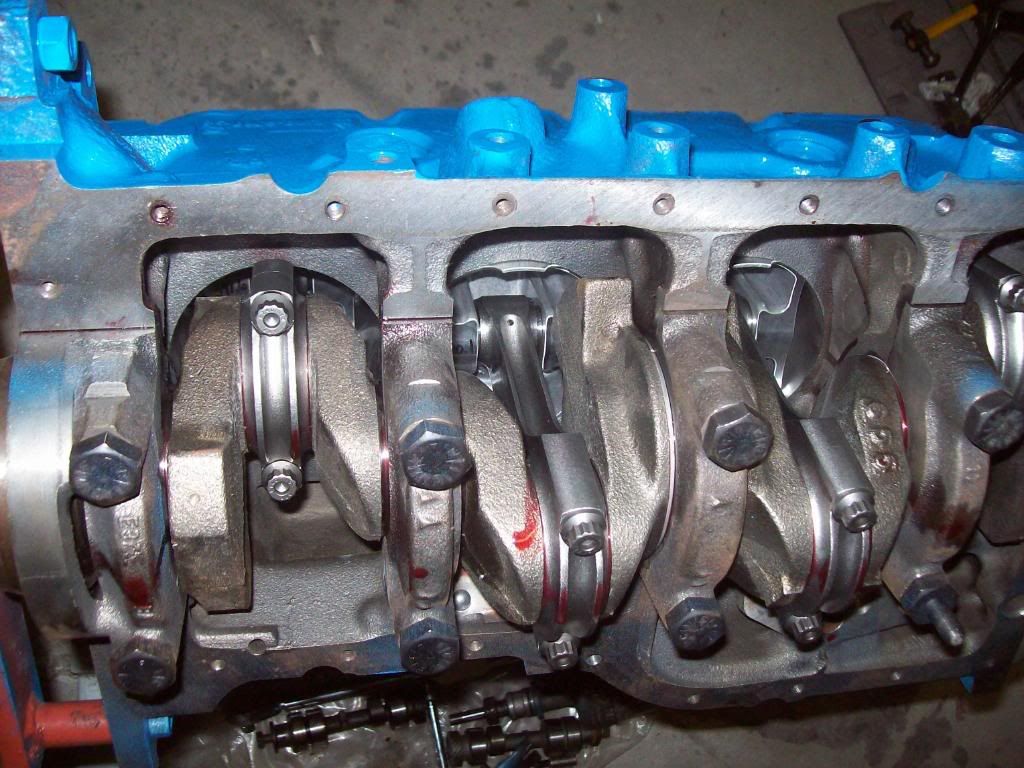

30 over block thats been line bored
new crank
new ams billit h-beam rods full floating
new wisco flat-tops
new aux shaft
pyro pete 36-1 trigger wheel kit for the ls2 coils
new m86e oil pump
new pickup tube that has been brazed to insure no leaks.
additional parts are

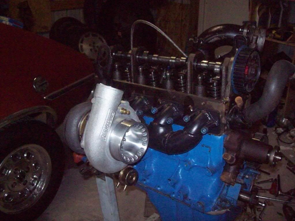

fully ported big valve head
477 lift roller cam
double valve springs
bobs log
sc6265 billitt turbo

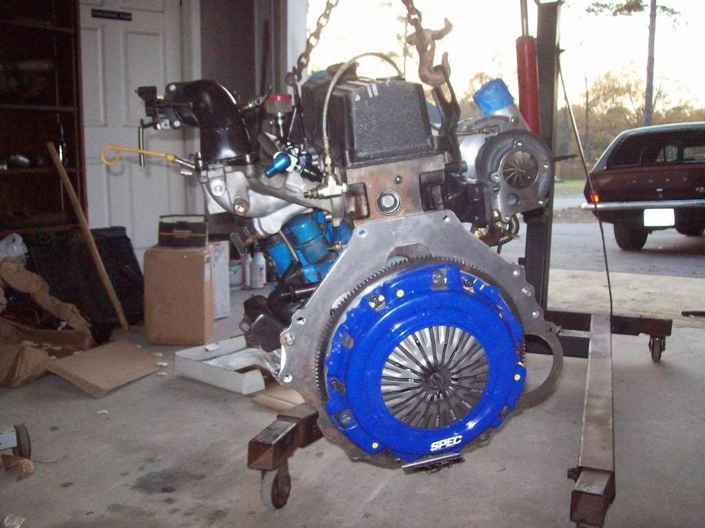

v8 adapter and clutch kit
big npr
