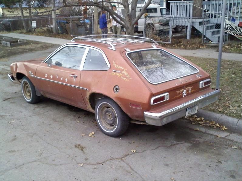

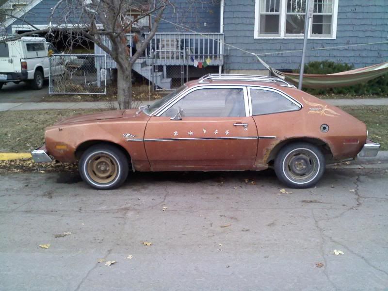

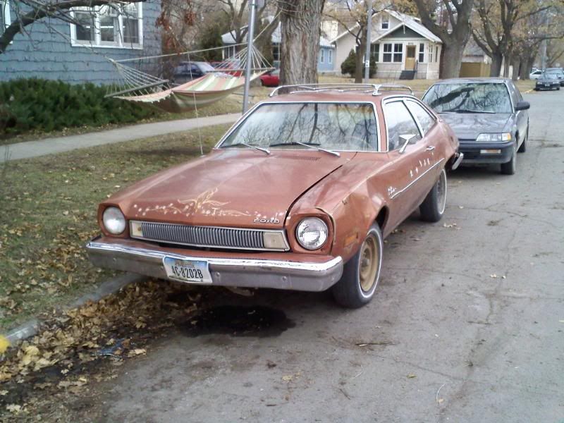

Here's a couple pics of the first time I saw her
