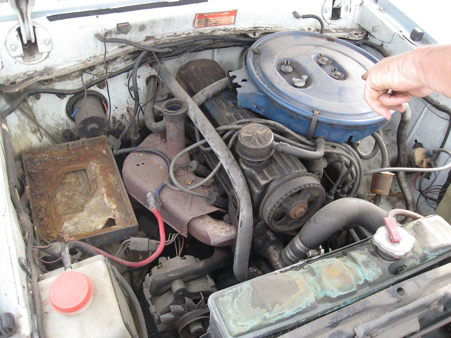

2.0 valve cover is ribbed and oil fill is in the front,2.3 is smooth with Ford oval on it  , and oil fill in the rear.1600  is OHV not OHC.

i have seen the alt on both sides of the 2.0 liter motor. the passenger side seems to be the most common one.
79 bobcat  78 ford pinto station wagon   93 ford mustang lx   90 ford mustang cont lx  63 chevy truck    52 studebaker 2r16a
Ahh, good observations! My 78's 2.3 as well as my 73's 2.0 have the alternator in the upper right. the 73's 2.0 being in the upper right might be due to it having air conditioning though.
Sorry Kim.
Congratulations on a great find, Kim!  Too old to be a 2.3 - they weren't introduced until 1974.  I know that because when I ordered my '74 new, it was a brand new option.  If Jimmy says it's a 2.0, then I would bet a week's salary that it's a 2.0.  He knows his stuff!
I was gonna say... DAve, my Green Meanie's 2.0 engine has the alternator on the lower left too... same goes with the 2.0 I have in the garage waiting for another Pinto... ;D I know about the alternator placement because earlier today I remived a wiring harness from the spare engine's alternator. ;D

It looks like it has a 1.6l motor, judging by the alternator location (on the lower left of the engine).
Can't wait to see this restored! I have a passion for the ORIGINAL pintos of 70 and 71!!!!
I'm pretty posetive it is not a 1.6. There isn't enough room in the engine area left over! LOL My 2 Pintos with 1.6's have a ton of space under the hood. That and the valve cover/heads are alot smaller!! That and my 1.6's have a single barrel carb while this one has a 2 barrel!  :D

Kimmy! Where did Bob find this gem!? She's beautiful! Even for a Mad Max trunk model! lol. Natch, I  love those pop-out rear quarter windows... The engine looks like a 2000. 2.3s have the breather/oil filler cap tpwards the rear of the engine.

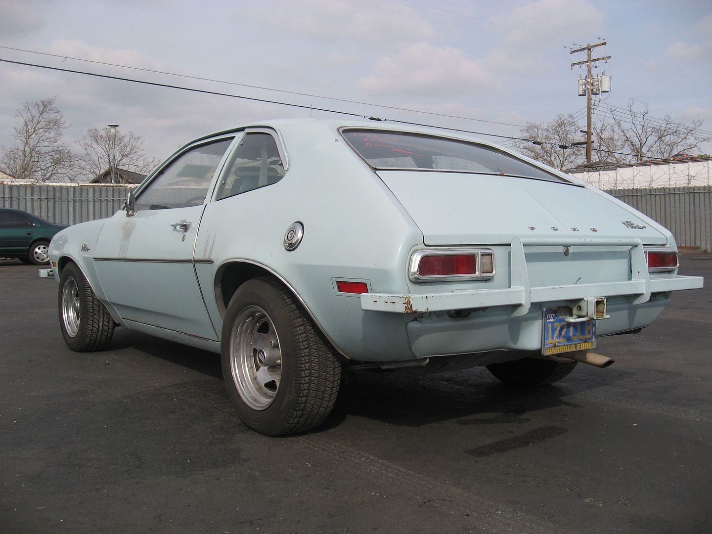

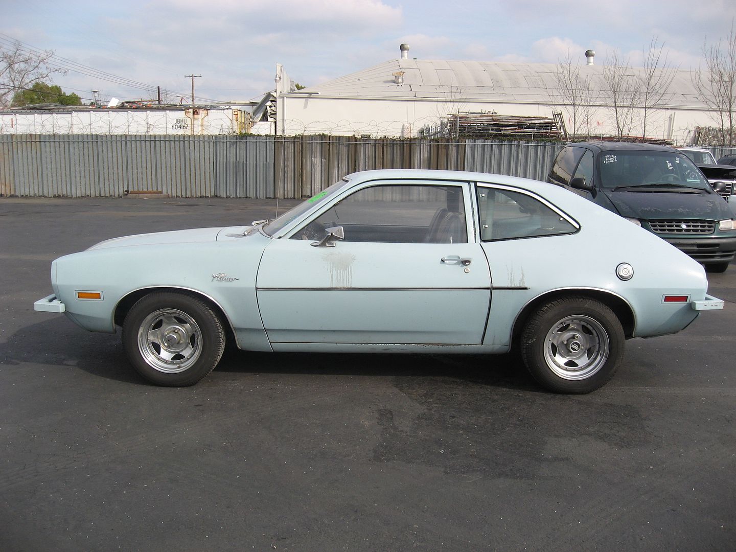

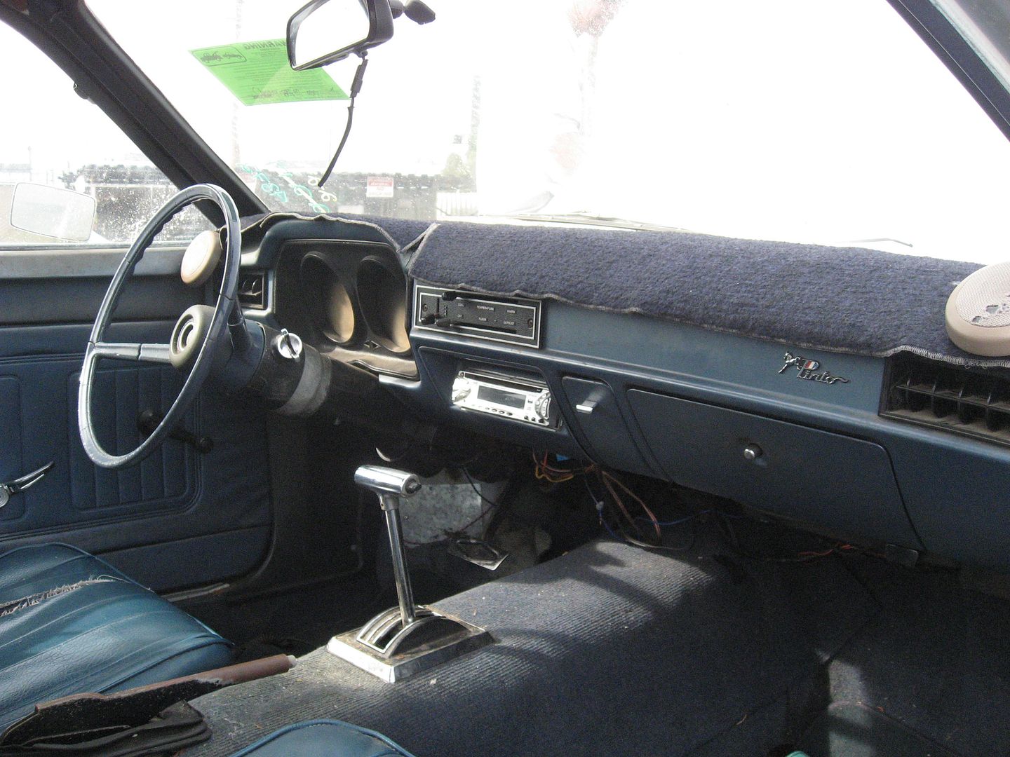

She is a 10th month of 1970, so 1971, I believe a basic model sedan! She has no fancy door panels, and no fancy wood trim on her dash! She only has a few small dings and has a complete grille, even though one turn signal appears to be missing, it is on the dash! A little glue should fix that!!

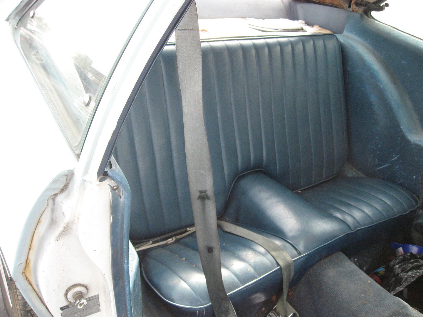

She is sporting a baby blue paint job, even though she is actually a white Pinto! One day she will probably be white again. For now, she will stay baby blue. Her interior is a dark blue. She needs a new headliner and also atleast one new visor. Her seats will also need to be re upholstered, but they are good enough for now, nothing a seat cover wont fix!! :D
As far as how she runs, I don't know! LOL There were no keys. We called the key guy but he didn't show up today, will be there tomorrow! I believe she has a 2.3 in her. I don't know if it is stock or if someone put it in her after the fact. I thought the early 71's had 1600's, or 2000's?? Then again, I may be wrong, maybe it is a 2000, I'm not that good at telling the differences yet!! :D

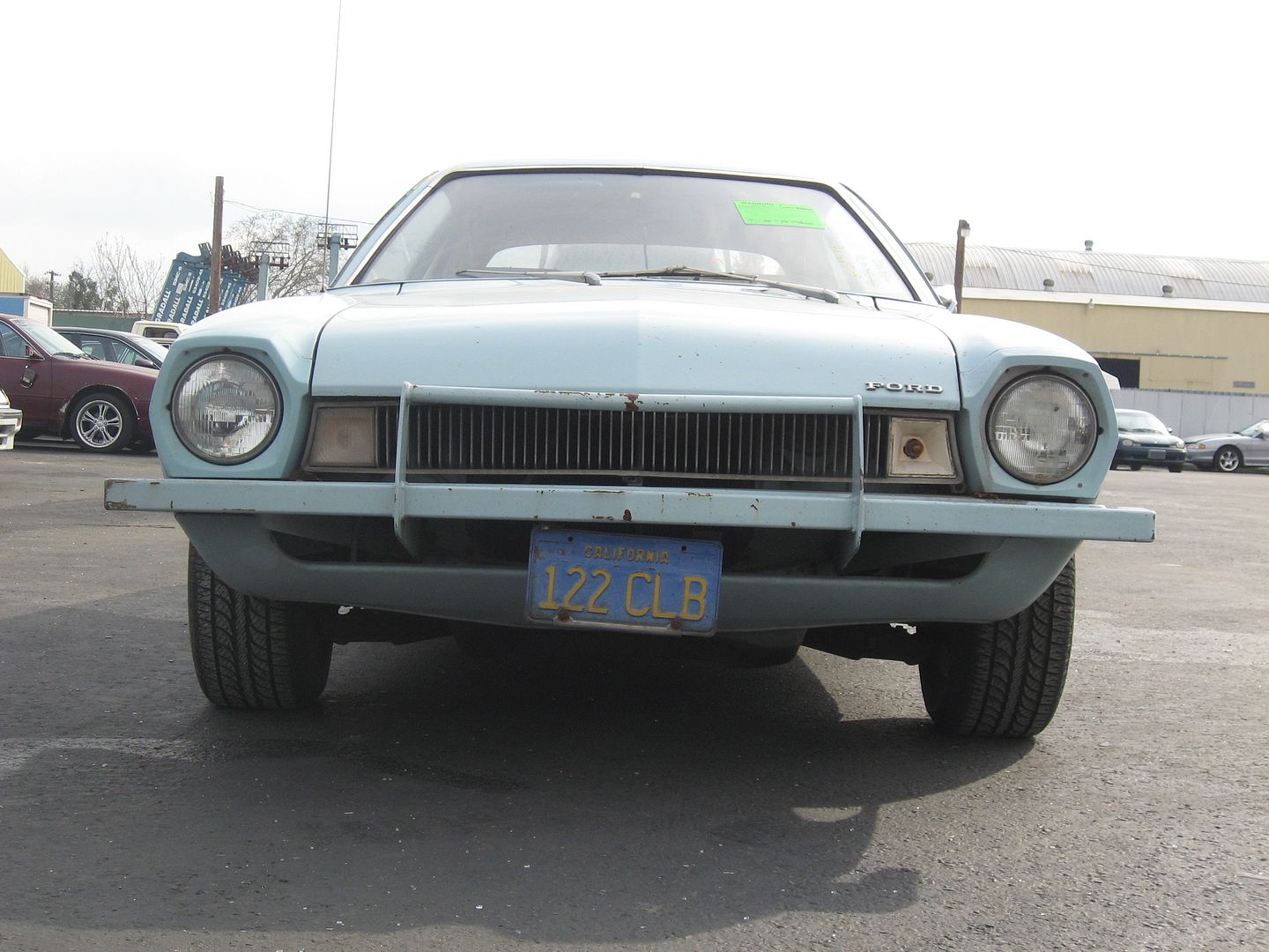

Ok, now for her name! She is going to be called Mad Max, Max for short!! She gets the name do to her bumpers! LOL Someone did a good job on them, but they look a bit like something out of Mad Max!! LOL  ;D
Here are the pics!!
The motor, check out the Mad Max battery tray!!  :lol:
Interior, I haven't even lifted up the dash cover, so I don't now how the pad is!

The outside! Love those bumpers!! They are even new age! They match the color of the car!!! LOL
