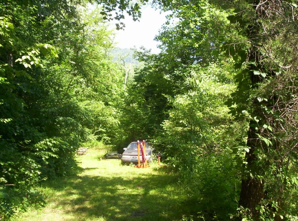

I see that you and I got our garages at the same place except you got the delux version with "walls".  That motor is sweet looking.
PS: that is my ranger work bench on the right....
Grumpy

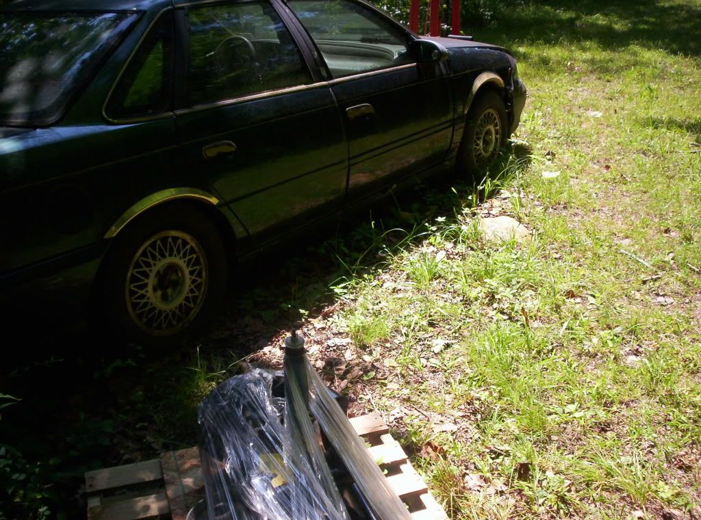

My garage...

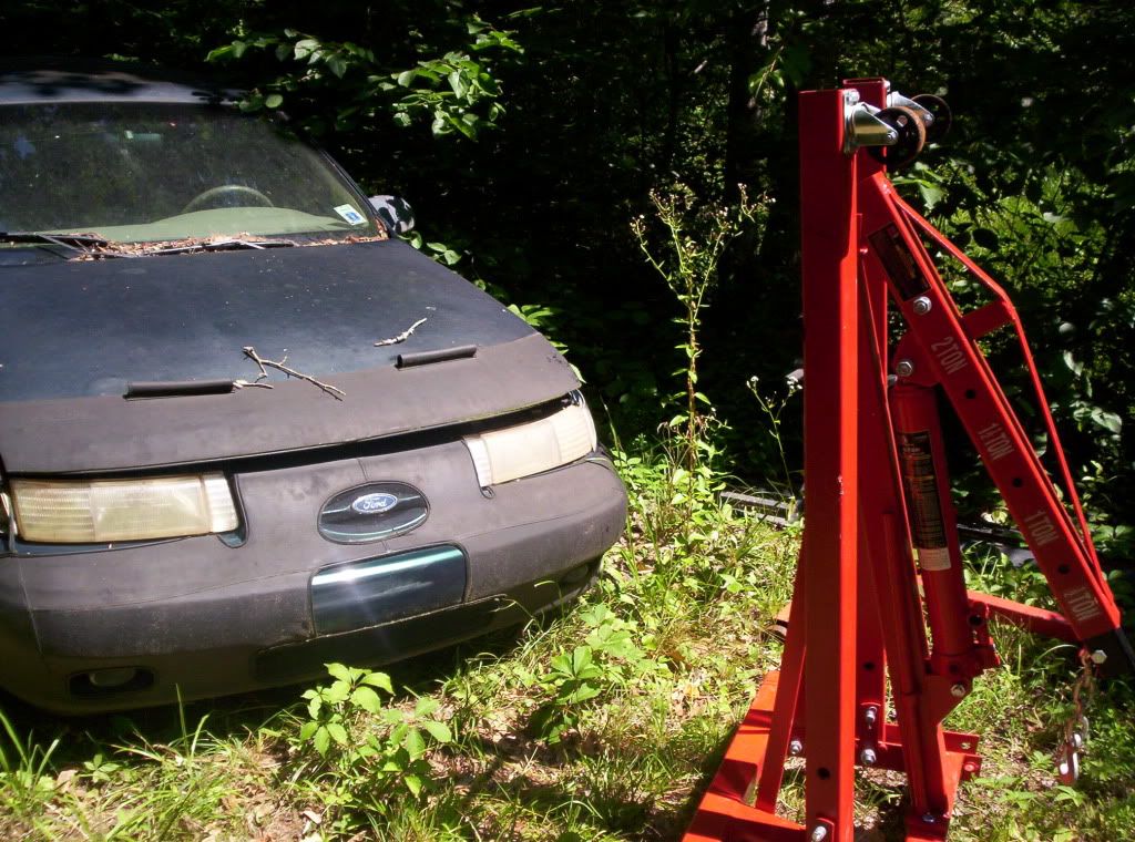

The doner...
Grumpy 8)
79 Pinto Hatch, Yellow w/White Pony stripes, Pony wheels, 6650 miles
