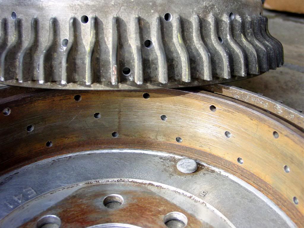

Before you spend the $$$ for a rear disc setup...
Disc brakes are much heavier than drums.
Disc brakes only have the advantage in the wet or when hot and the drums you are comparing have not been vented (as below). Many BIG trucks still use drums for a reason. More brake pad surface area than discs.
Changing the brake bias to the back without upgrading the fronts means swapping ends in a sudden stop. Bad Bad Bad  :accident:
To balance the brake bias back to correct using a portioning valve only defeats the advantage of the "better stopping power" for the discs in the rear anyway...but you still get the WOW value looking through the wheels...$$$
(former end swapper)
