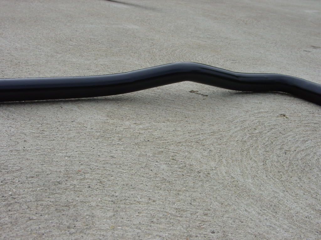

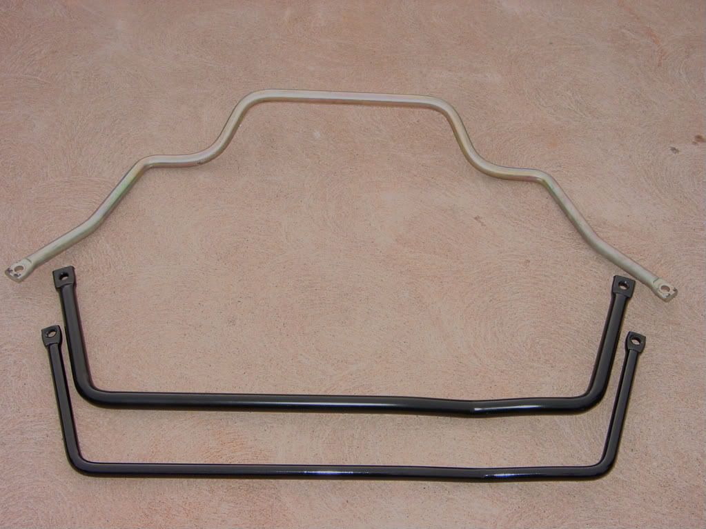

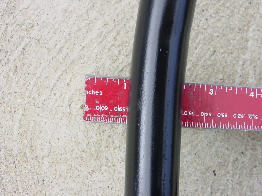

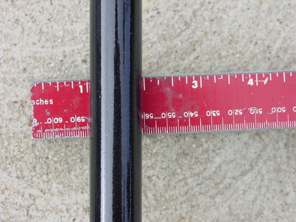

I received the 71-72 Pinto 1 1/8 Hollow front anti-sway bar from ADDCO yesterday.;D  I worked with their R & D dept (Dan and John). :drunk:  I will be testing this for them to see if it is an improvement and worth producing over the 71-72 7/8" solid bar currently in production (the largest now available-also pictured). This 1 1/8" hollow bar is intended for full race applications. IF  it works, they will produce this and migrate the technology on to the 74 and up Pinto crowd (I included a silver colored 74 up 15/16" bar for size reference)  :fastcar:
Stamped Hollow End. Technology borrowed from the early 2000s Mustang Cobras that came with 1 1/8" Hollow Bars. I put one on my Cobra Clone and was stunned by the difference over my stock GT bar and without a harsh ride, hence the idea to upgrade my road race Pinto project. ADDCO got interested with the idea and the performance potential (read: potential sales ;D)
The 71-72 bars fit backwards compared to the 74 up bar shown here.
7/8"Bar
1 1/8" Bar
1.6L and 2.0L Exhaust Clearance Hump upside down for picture.
7/8" Solid Bar end to end with the 1 1/8 Hollow bar.
