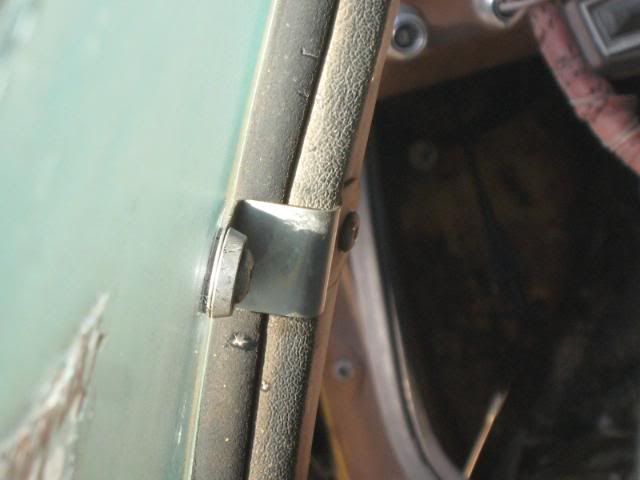

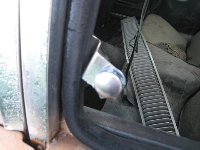

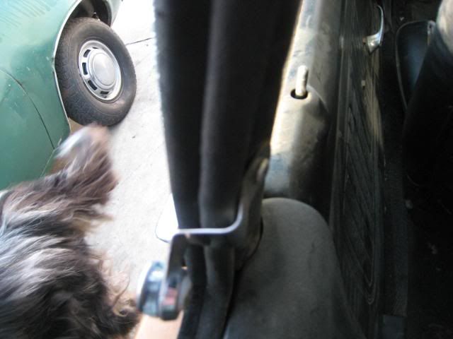

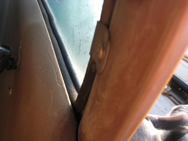

Ok here are the pics!!
The broken window's hinge, outside car.
Inside of car.
Sideway view
Complete window view (yellow donor car)
Inside veiw. (yellow donor car)
Shot of hinge while window is in open position.
To me it looks like the metal hinge does all the work. It basically just bends back pushing onto the seal for the window, in the open position. Then simply returns to original shape when closed. I don't see any type of plastic anywhere in the window or hinge areas!!
What do you guy's think?
Yes, the plastic inserts hold the windows in place as well as act as a hinge so it can pivot open.  The wagons use the same concept however they are different inserts than the hatch/sedan cars.  The inserts get brittle with age and if broken the window will not seal properly.  I look forward to seeing those pics
