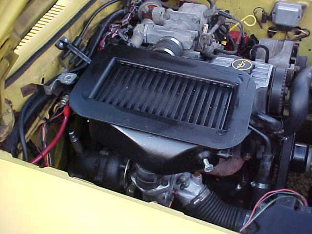

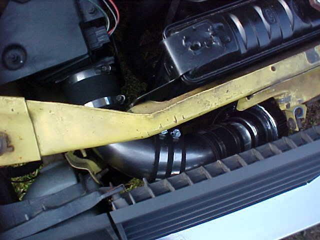

This is in my Bobcat Auto-X car.
It is the small VAM, but the big one should fit there as well. All I did was bend up the stock T/C mount bracket and drill one bolt hole in the car. There is not much room around it, the intake tube runs under the sub-frame, and my air filter is in the right fender.
turbo toy
Quote from: Wittsend on July 14, 2008, 06:27:07 PMI assume the picture is with the speed density?  It doesn't look like my VAM.
Wrong. The pictures I posted are of the VAM and bracket from an 88 Turbo Coupe. I reworked the bracket and mounted it on the inner fender panel and ran it through the radiator support, then turned it down in front of the radiator to the cone filter. What you are seeing is the top of the bracket.

My Pinto is an 80 model, so I don't know if they would fit the same, but here are a couple of pics. I have gone to speed density and therefore don't use a VAM any more. When I ran it , it worked great and the intake was easy to position in front of the radiator. Hope this helps.
http://i11.photobucket.com/albums/a198/CurtisHensley/Pinto031.jpg
http://i11.photobucket.com/albums/a198/CurtisHensley/Pinto030.jpg
