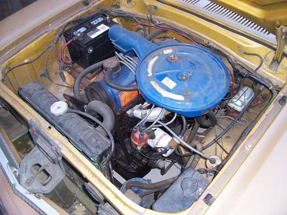

car is completely stock. stock carb, exaust everything. sticker is still on the valve cover, has new points, cap, rotor and wires. I have replaced the intake manifold gasket and carb base gasket due to a vacuum leak, but have been unable to find any info for checking the timing belt to see if it was set right. I've had the car for about 2 years or so and have only put maybe 3-400 miles on it. here's a pic of my engine compartment
