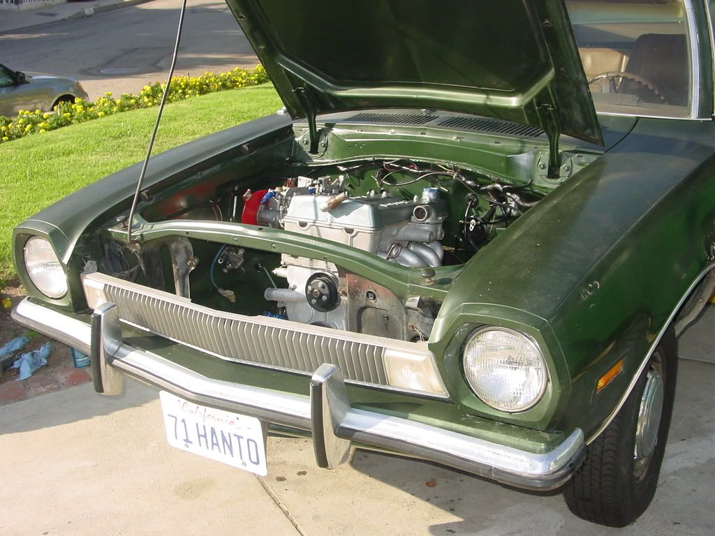

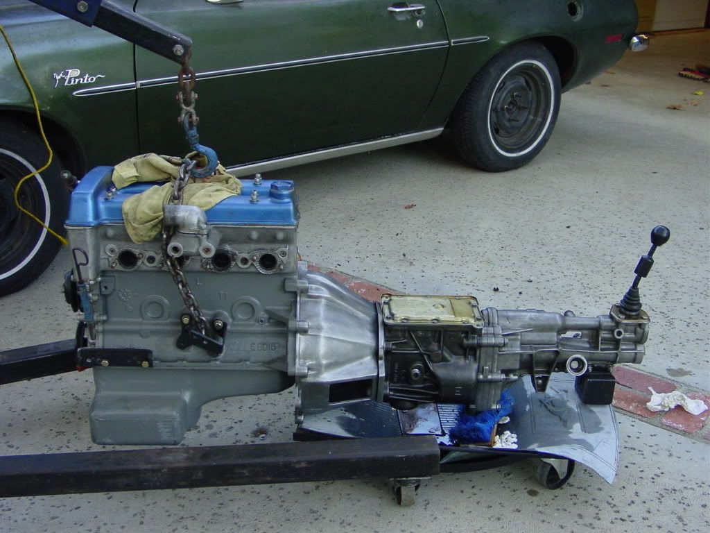

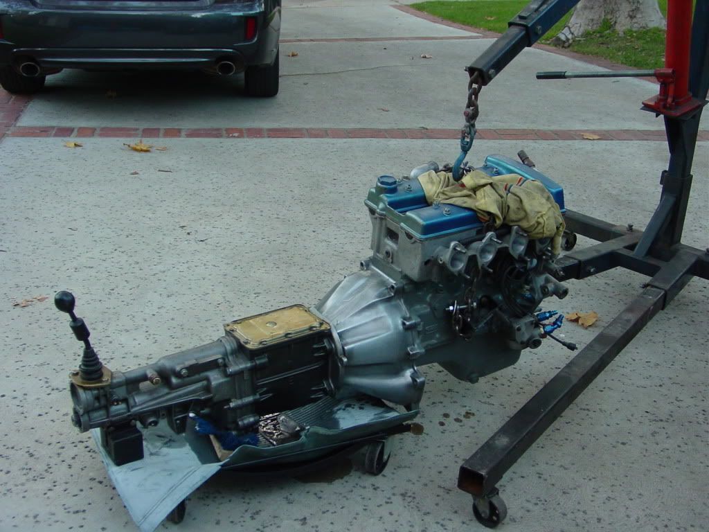

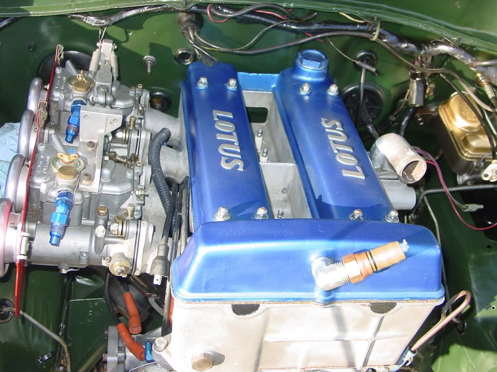

Here is a Twin Cam head from Lotus (still being produced $$$ Dave Bean) that fits a 2.0L. This one is on my 1.6L. There is also a 2.0 Cosworth Twin Cam and the Ztec (SVT) Twin Cam. The original Hanto Pinto (1974) was a 907 Lotus Twin Cam. I used a T-9 5 speed which is just a Pinto 4 speed with an extra 5th gear (came from a 2.3L Merkur). I adapted it to fit a 2.0L bell that was the original engine in my 71. The T-5 requires the trans tunnel to be cut forward 1.5 inches. The T-9 does not. However, the T-5 is stronger and a dime a dozen.
