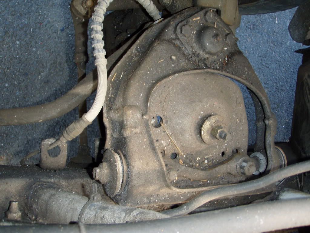

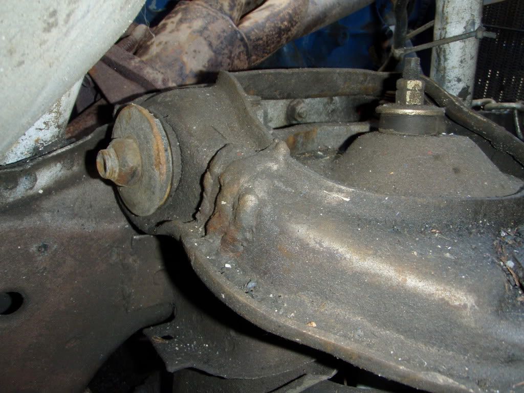

Some racers turn the upper a-arm shaft 90*, weld a large piece of angle inboard on the top of the spring cap (far enough in to give you more camber than you want), drill it so that the shaft bolts to it, then use normal u-shaped shims to get the alignment you want.
Clear as mud, right?   :o

1/2" extra in the slots will give you about 2 to 21/2 deg negative camber.

You will need to remove the upper control arms first. Then you will need to move the adjustment slots inboard about 1/2". The best way is with a right angle die grinder and a carbide cutter. All four(4) of the slots must be moved, and it does take time. The material there is several layers thick and there is no easy way to do this. Is this an autocross car or scca road racer? LOL.
