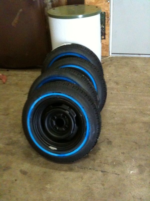

Here's her new shoes!! Just can't put them on till after tomorrow. Her new "insoles" (brakes)lol will be in by then!!!  ;D
Went with blue walls! LOL
i want your tire company, i payed 280 js tfor the rear tires on my car. plues 240 for the fronts.

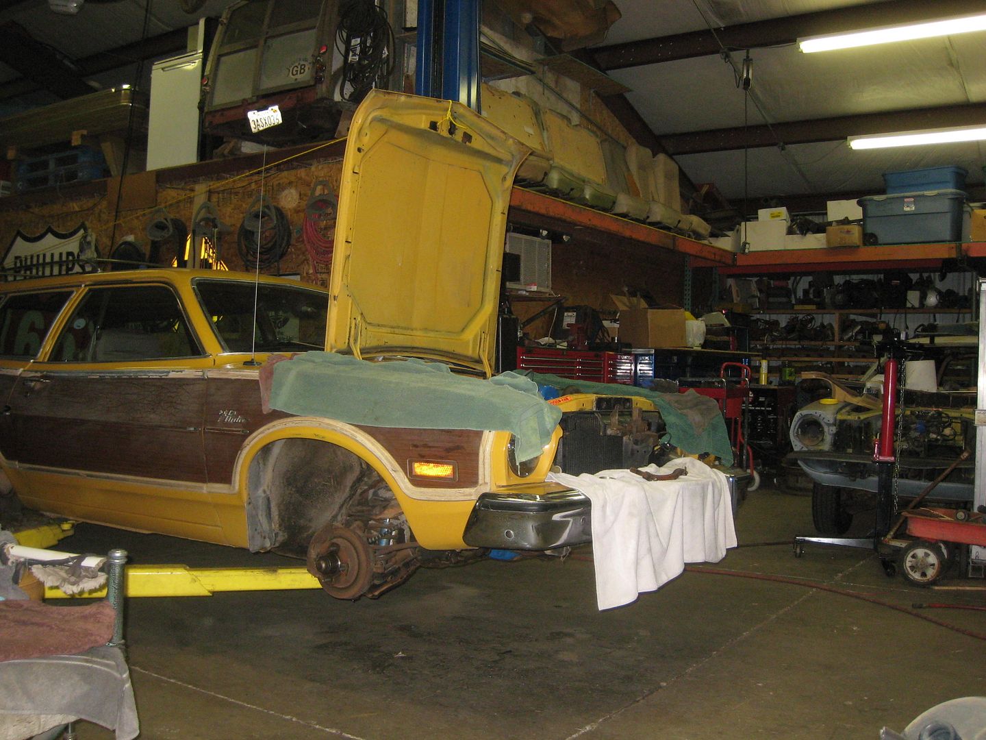

Well, we didn't get to much done over the weekend. I was hoping for more, but really some of it wasn't hubby's fault! LOL
Hubby suprised me after going to breakfast. He took my to the tire shop and we got a quote on some white wall tires. Hubby said that would be ok although it is the most he has ever spent on tires in a long time!! LOL We payed 240 bucks installed and balanced. THey had to order them so we went home and pulled the wheels of the car and cleaned them and then painted them black. Once we got done with that we dropped them off at the shop. I called at about 3pm and they still weren't done. Then they finally called at 4.30 and said we could pick them up. Thing was, we were busy cleaning garage and they closed in an hour. We chose to leave them there till Monday!
Then today I pulled the drums off and we decided to get new shoes and wheel cylinders. I called 2 places and neither had all the parts in stock, would have to order them. So I now have to wait till Tuesday to finish that job. Now I will have wheels back on Monday but can't put them on till Tuesday! LOL
Than FINALLY, I started working on getting the motor all hooked up!!!!
Got to protect those fenders!!  ;D

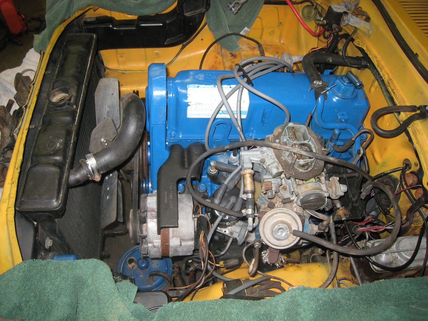

The motor, fan, and radiator are all in and hooked up. Now it is down to just trying to figure out where some hoses and wires go!! Then finally the test of trying to start her. I'm hopeing that will be tomorrow, but it is hard to say! Hubby works at his own pace! LOL
Oh, and in the pic above, I have hoses going to places they don't go! LOL I was just hooking hoses anywhere! LOL We need to figure out what is smog related and plug that stuff off.  I'm going to go buy some plugs so things look neat!! I hate when you see hoses with screws screwed to them! LOL

Because the carburetor is closer to the rear of the engine (ok it's AT the rear! lol) to get a close-up it would've cut off the front of engine. There weren't all that many hoses on the '74. I got a close-up of the tee that goes over the valve cover near the sparkplug wires and hoped the carburetor lines were clear. Naturally there's fuel lines too... I just needed specific places. Oh well, there's tomorrow (after I get more batteries! lol.)

Basically I wanted you to move just a bit closer to the motor so your camera frame is showing, lets say in front of the carb to the front of the motor. It would show all the way from the top to the bottem of the motor (well kind of, lol) . Then the other pic would have been from the carb to the back of the motor, still showing the top and bottem. It wouldn't be so close that you could only see a few hoses, but close enough to where you could kind of define some of them!

Well, kind of! LOL It's hard to see stuff in pics anyway! I will try to basically go off of the CW's stuff. That and I think alot of the hoses are for smog purposes, so I will not be using most of them. I think my main worry will be vacuum for the tranny and the distrbutor!
