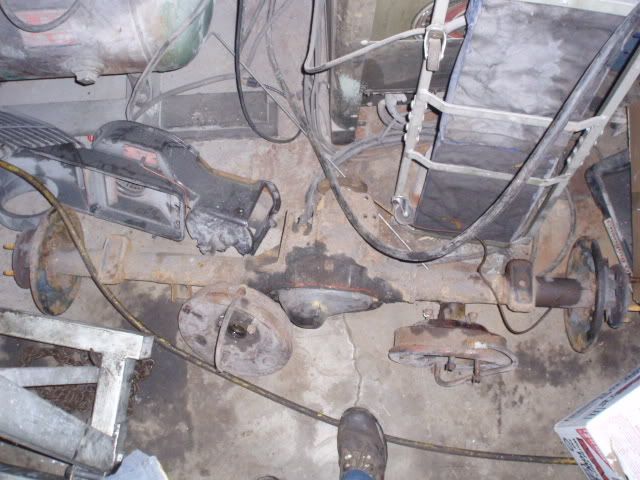

Quote from: 77turbopinto on August 04, 2008, 05:34:49 AM
IIRC: Doesn't the Ranger rear have the meatball off to one side to clear the gas tank?
yes, check the pics below.  this rear was taken out of a mid 90s 2wd (if i remember right) 4.0 ranger. later fx4 models could be had with a torsen locker, 31 spline, and 4.10s.
http://i307.photobucket.com/albums/nn294/ford371/P1090007.jpg
bob
