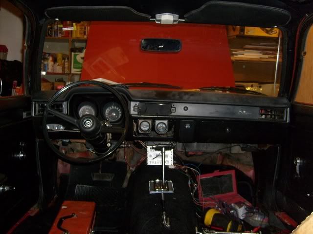

Figured i would post a pic of my dash as it sits right now.  You can see the vintage Kraco AM/FM/Cassette/Equalizer underdash unit, the vacuum and volt guages, and the untidy state of my Pinto.
I am going to be installing the fancy silver instrument cluster and vents and putting the heater control assembly back in.  While the instrument cluster is out I am going to splice into the dash light feed wire so i can have the lights in the aftermarket guages work.
I think I can, I think I can....
Reed, you've just added something else to my list!

Thanks for the compliments.
I originally had bought a combination tape/CD player radio for my Pinto, but I would have had to cut the radio bezel to install it.  Well, tonight I went out and looked at it and i just couldn't bring myself to cut up a perfectly good radio bezel.  Instead, I dug up an old Kraco tape deck that mounts under the dash and some radio shack speaker.  I wired it all up and it actually sounds good!  The Kraco deck is one I bought at a thrift store about ten years ago for five bucks.  I don't know how long I have had these Radio Shack speakers, probably close to ten years too.  They were just collecting dust in my attic.  So, for very little money I actually have a nice sounding stereo in my Pinto!
Now I need to build a box that will mount to the rear package shelf that will hold the speakers and act as a bass reflex box.  The holes in the shelf are 6x9 but the speakers are 5 inch round.  I plan on building a box ot of plywood that will extend across the entire package shelf with three chambers:  one for each speaker and a center chamber that will open into the center hole in the package shelf.  Each chamber will have a small opening into the center chamber so the stereo separation is maintained but the center chamber acts sort of like a woofer.  Fun fun fun.... :laugh:
