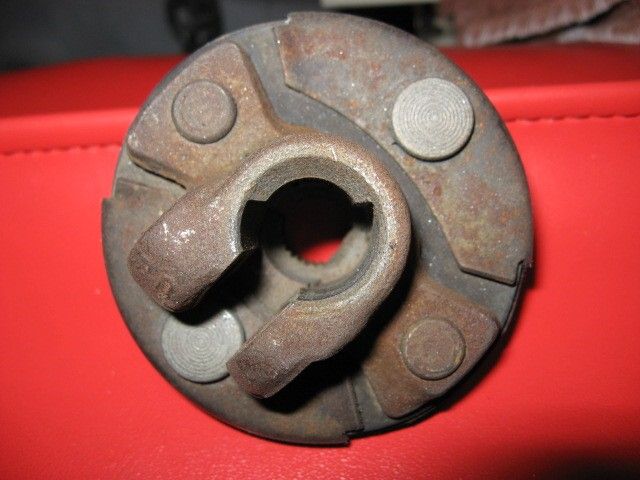

I still have the flex shaft.
Reason I wanted the U-Joint was for more clutch cable clearance, by/at the rag joint.
I have the Quick Time bell.
I came up with another idea for motor mounts. They will be a semi solid type, so more cable clearance may not be required now. I'll see after the new mounts are made.
72pair
Does your car still have the original column with flex shaft? I'm thinking you need to swap in a later column with a solid shaft, then you can add in u-joints starting near the firewall and route around whatever you need.
72 sedan 2.0, c-4 beater now hot 2.0, 4-speed
72 sedan 2.3, t-5, 8" running project
80 Bobcat hatchback 2.3, 4-spd, 97K
Got it. But I didn't take into account the length.
The distance between the rack & steering rod is too close for it to fit. I do not think I have ever had a steering column out, so have no idea if it will collapse/push in enough for the U-joint to fit ?

Racer - the 3/4" end of that one is a double D. See my pictures above. I found lots of those up here. Did you mod the steering end to make them fit ?

Up-date.
Sent pictures to the go to sped shop up here (Mopac in Edmonton) & they couldn't find one.
New pics below.
Rack shaft is 9/16" x 26 spline.
Steering shaft is 3/4" wide & single D.
Over the next days I'll try & find at the places mentioned.
In the mean time, if anyoe finds one please let me know. Limit on my time when away working.

 You will need the OD  and spline count on the rack end. It looks like you have a manual rack, so it should be 9/16 -26. The power rack is 3/4-36.
The shaft should be a 3/4 inch double d. AKA - DD     On mine the 'flat' is .581 and the round is .746

Knew "rag joint".
What I need is the steel type u-joint. They are smaller around & will give me more clearance for the clutch cable into the Quick Time bell housing.

It's called a rag joint.You can get replacements at your local auto parts store.
05 Pigon Forge Meet, 06 Carlile Meet Coordinator 06-07 Carlile Regional, Brief Case Award (ask)
Need the U-joint type knuckle. Don't know what they are called ?
Place to get them ?
It's on my 72 & I need a bit more clearance for my clutch cable.
