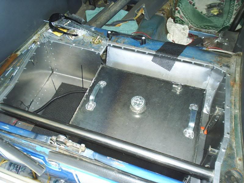

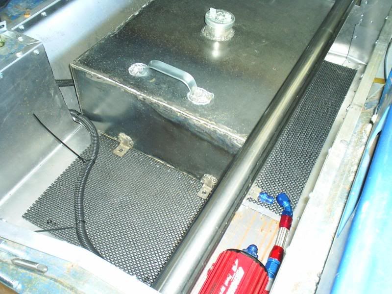

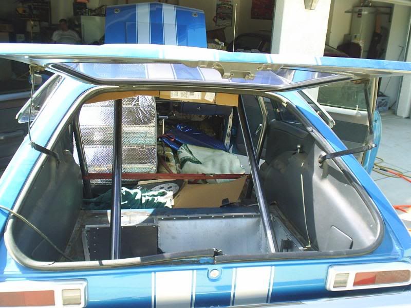

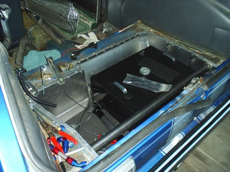

I was busy putting in the rollbar and fabbing the rear pan and tray for the tank and battery.

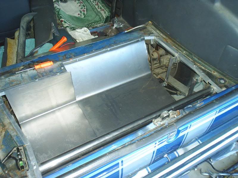

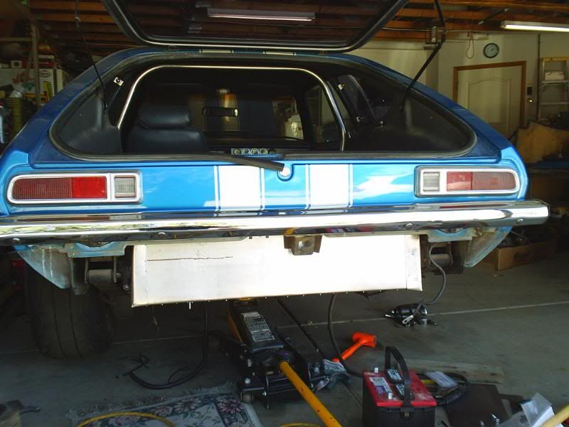

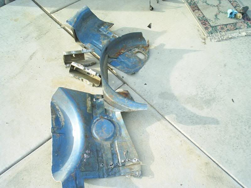

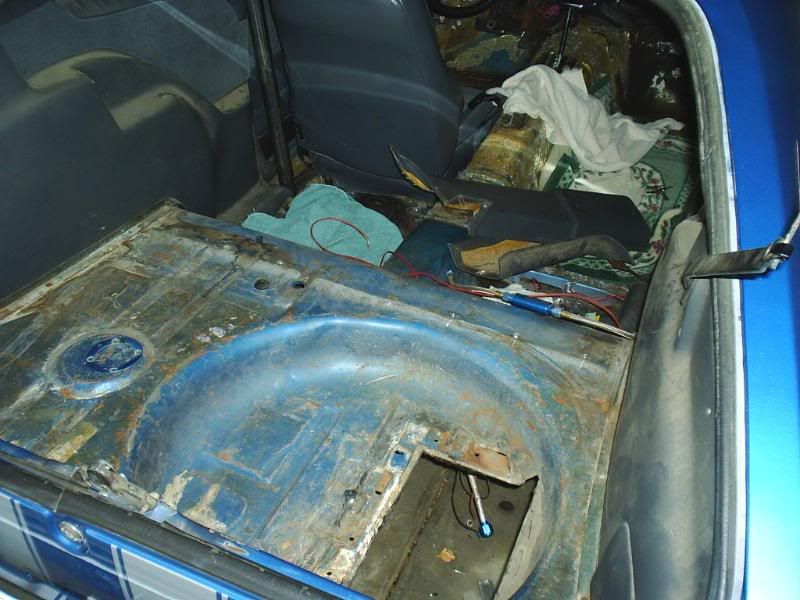

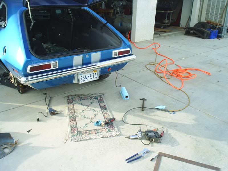

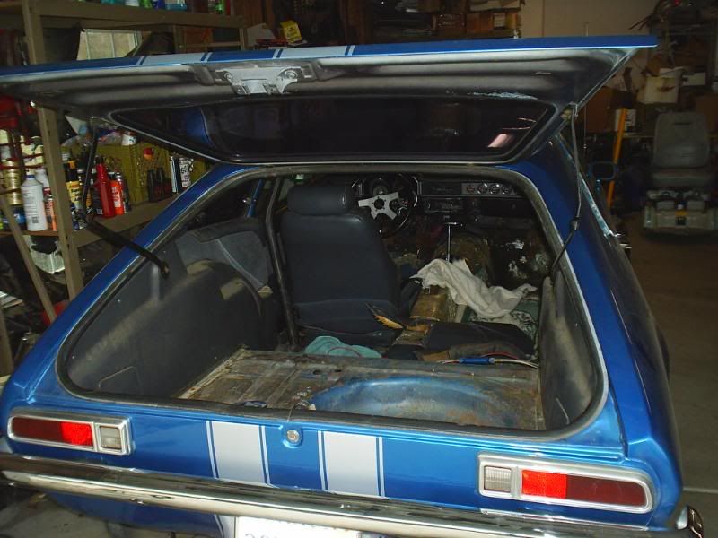

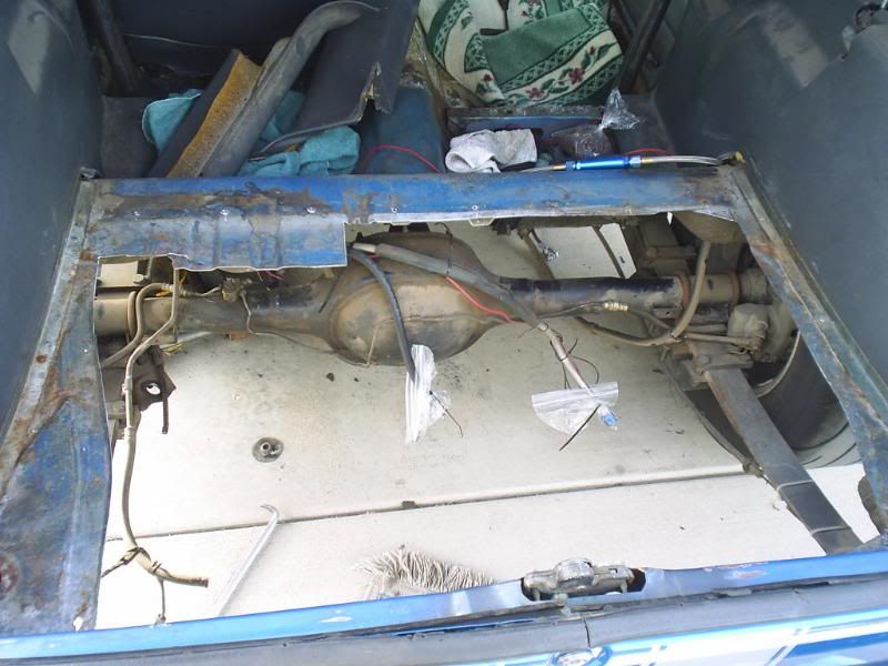

Its been a while, and I've done a little bit of work on the car. Cut out the trunk floor and made a new compartment for the fuel cell , battery, and fuel pump.
Added a rollbar, but Im still not done completely.
Trying to make the car legal for the strip, but everytime I go there, it seems like they are not satisfied. Its not an all-out race car, its a street car dammit!!
Anyways, heres where I removed the rear floor....
