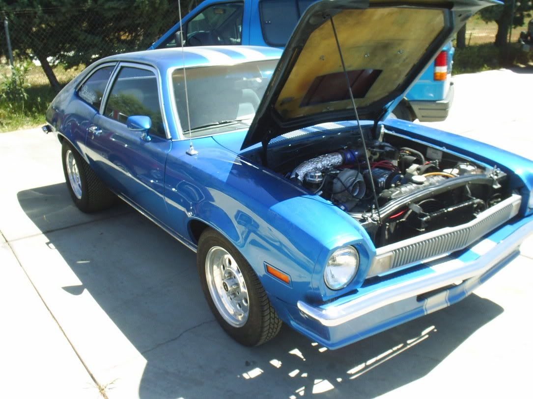

Took the car out of the garage for the first time i a looooong time.
Air'ed up the tires and started it. Let it warm up, took it for a drive up the street.
I got on it and it just happened to respond to the pedal. It broke loose and fishtailed sideways for a second. So I took it to the dyno to find out why it just wont run.
We put it on the dyno, and it put down 330 at the wheels with only 14 PSI, and breaking up badly at 4200 RPM's.
This thing should be able to fart out 450 at the wheels when it runs good.
It just hits a brick wall at 4200...it will not rev any higher, and it just pops and sputters like the rev limiter is set on 4200...but its set at 7000.
I checked everything...ignition, fuel/induction, compression, cam timing...you name it.
I have concluded that there is a problem in the ECM, and I'll need to send it back to the manufacterer to have them check it out and recalibrate if neccessary.

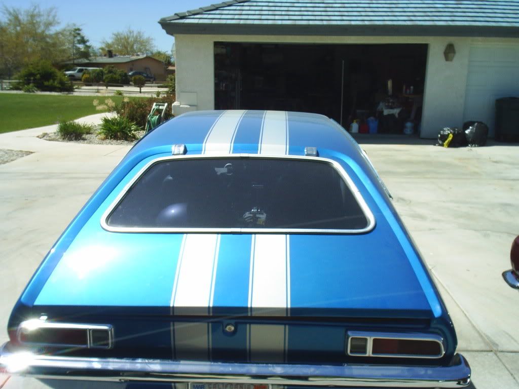

Thats the small window hatch.
Unfortunately, all those shiney parts are now covered in dust and cobwebs!!
