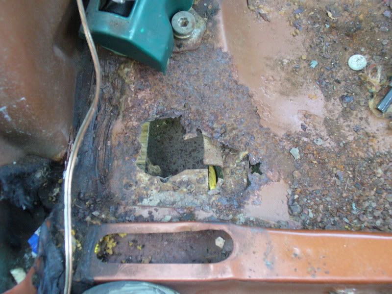

The driver side rear just needs some minor fixing with a couple minor spots but this is very bad for the passenger side rear, especially since the whole front floor is shot. On the upside the transmission tunnel looks brand new.I got some major deciding now. Do I try to find a good shell nearby or do I fix what I got.. I can figure a way to pull the engine & it's got no tranny. I have yet to install the 8" rear.. Oh man.. what to do  :-\
Well, I was removing the rear seat so I could locate the source of the trnk leak & found a very bad problem.. See the pic below
I know it's a 32 year old car but this is not good. If I'm gonna save her I need some major welding

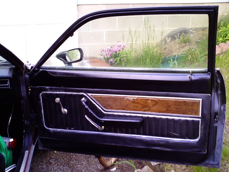

I got some pics of the door panels on my car. They don't look too horrible in the pics but to be honest the door panels don't do the pics justice.
Right side
Left side

I also went ahead & went a little farther on the interior of my car. In the garage I had some door panels I previously bought off here & put them on the car. They are not the ones I want on the car but since the doors leak these work fine. Now, before you get in an uproar these are already junk. The backs are horrible & the vinyl is junk. I just wanted something on there so I won't have to look at the ugly inside of the doors when driving the car. Once I get the new doors on with new door seals then my good door panels will go on the car. They don't look great on there but from a distance they don't look too bad. I will try to clean them up some but don't know how well they will come out.
