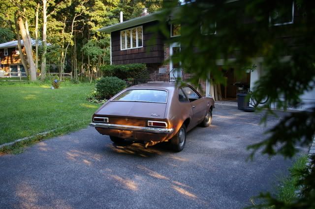

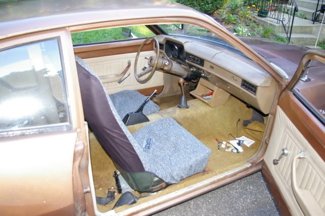

And I wanted to put a 2.8L V6 from a Ranger/Bronco II in it. I was wondering if it would work? And I was wondering where I could get the motor mounts? Would I have to replace the tranny that's in it?
My car is a '71 Pinto with a 1.6L I4 and a 4spd. Runs fine but not enough ooomph for me.
Here it is:
Thanks!
Ben
